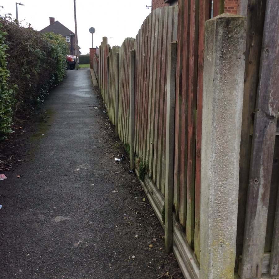

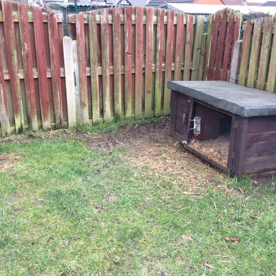

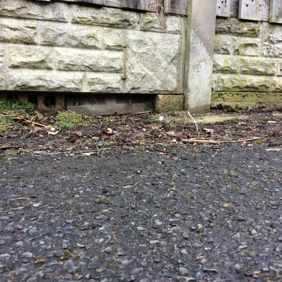

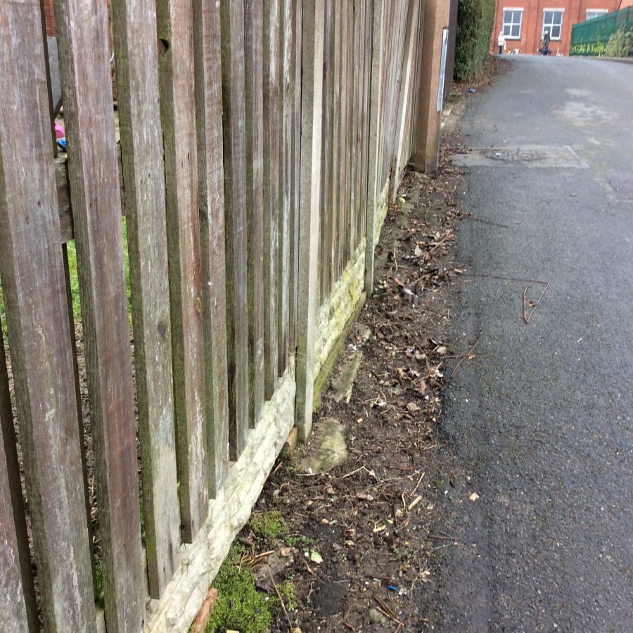

First off all for the first bit of advice I'm wondering if anyone has any low cost but effective ideas for sorting out our fence our major problem is down the side of our house the garden is higher on our side of the fence and lower in the ginel meaning the garden seems to be constantly pushing against the fence post and this could possibly be why it's all over the place but building a 4ftish wall with pillows seems to be to much of a costly option. I thought of a 2ft wall to hold the garden back but then it's finding a good storm and sterdy way of incorporating the fence post to the top of the wall I find them bolt on wood post brackets to be useless.

Concrete posts with gravel boards will be the most cost effective way top deal with it i imagine.
Timber posts with sleepers on edge between like gravel boards would also work, or sleepers bolted to one side of the posts but wont last anywhere near as long.
Generally speaking when putting posts in where they retain something or replacing them will be difficult/ complex then use concrete.
If you do go for a wall then you need to put the fence behind it with a small gap as its own entity. If you connected the fence to it and use the wall as extra support it would act as a sail and pull the wall over.
The only worry with the concrete post is that in a few years as the ground moves I think they will start to lean again also the other problem is that it's not got any decent height on the fence as it is and leaves it pretty open as people use the ginel they can see straight over and in the garden not making it as private as it should be. I thought of higher post then use two gravel boards but the problem with that is I can't source any post local over 8ft and I would need a good depth into the ground to hold the garden back :( its just starting to drive me mad lol as I don't want to spend on it for it to be all over the place again in a few years but on the other hand it's despratley needs doing as its rotten to hell!
I understand what you mean the small wall idea it will either be the wall what gives as its acting as a sail or the flimsy bolt on wood post support, I have thought of digging it level with the ginel and having a slight slope on the lawn but I think as I get up to the house I'll end up with problems where it's exposing the top of the house footings..... Hmm I'll just keep thinking for now though
