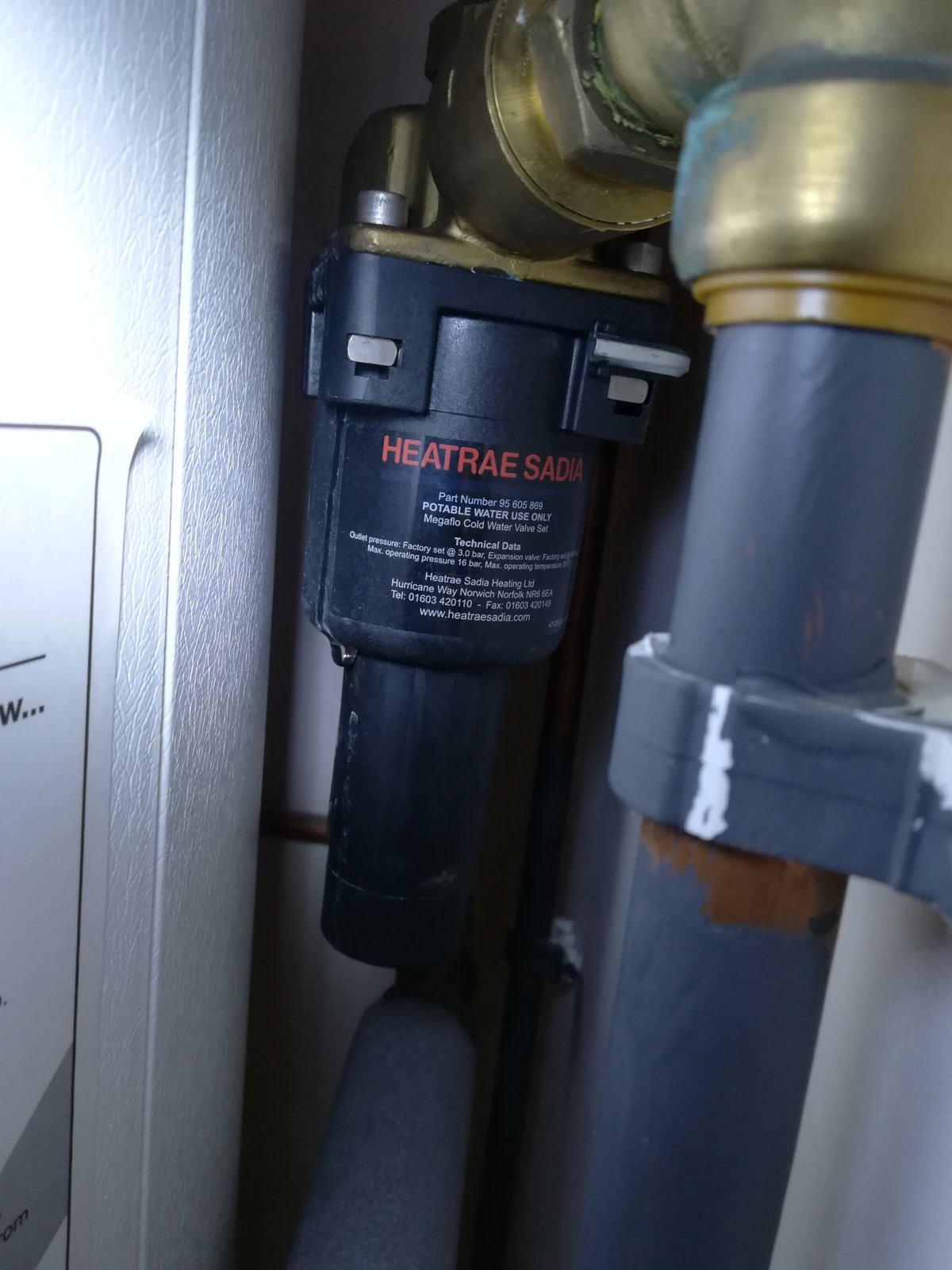

post a pic of what you are calling the cold water valve , is it part of the filling loop

I have attached a picture of the cold water for Ian

I am having the cold water valve replaced as this is leaking badly
Thanks for the pic, that is not a valve, it says on it that it is part of the valve set but it is not a valve as such, it is a pressure reducing valve and it regulates the water pressure inside your cylinder, the same water that comes out of your taps, that leaking is not causing your pressure loss in the heating system, what is above that ? could something else be leaking and dripping on to that or running down onto there ?
