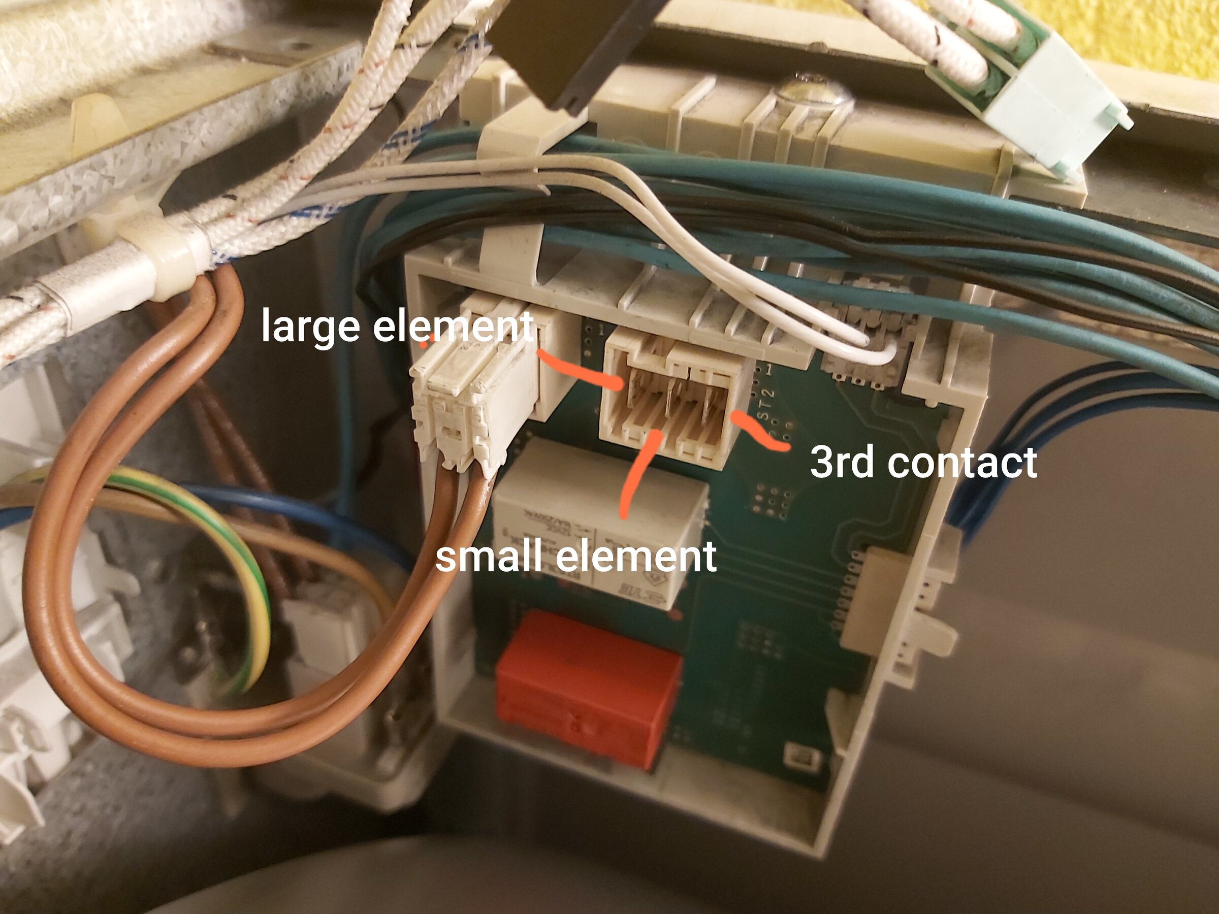

Miele tumble dryer 3,5 years old no longer gets warm. Also does not warm on the "warm air program". Intermittent F2 error, but this disappears and the signal from the rear NTC is good.
I have done the whole round of checks, both NTCs, both heating elements, thermostat switch. Power relays click over after about 60 secs.
One odd thing, after power relays click voltage between heating element leads and ground is 120V. Voltage between heating elements and return lead is 0V. Is this normal?
Any ideas? Thanks.
