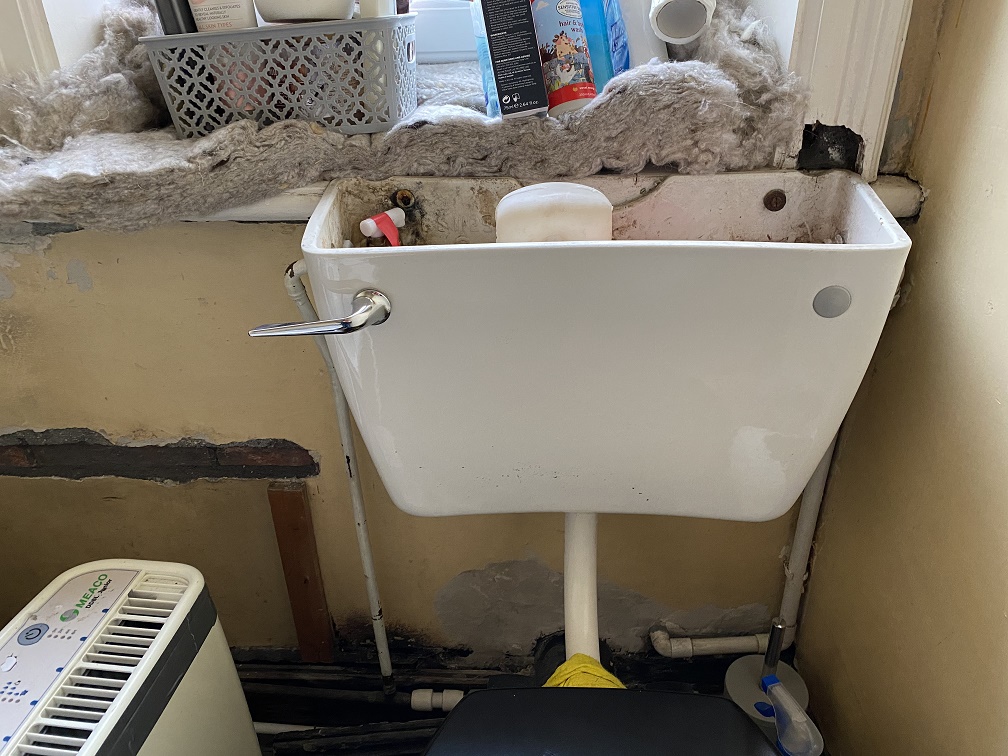

Hi
So I'm prepping the bathroom ready for it being brought into the 21st century in the summer.
When they installed the current toilet, they chopped into the window cill and squared it off. The cistern was then secured to the squared off section of the window cill.
The new toilet will fit under the window cill height so I'm going to have to replace the cill. I also need to do some other work around the window. So am thinking of moving the current cistern down a couple of inches to allow me access. The dynamics of the window are that I'll need to slide the cill out to replace.
If I move the cistern obviously I'll need to resecure it and replumb the inlet and overflow, but what impact would moving the cistern lower have on how the toilet works? The missus thinks I should replace the cistern with a cheap plastic one to make it easier, but it's only to got to last a few months in a lower position.
A bit less pressure when flushing (water in to the pan) but as it will be the same height as your new WC it shouldn't make a lot of difference.
The reason for me asking is that... I would have thought that if it made no difference the guys would just have installed it below the cill in the first place.
But your answer has made a light come on. Possibly fastening to the window cill was the easy option compared to fastening into the brick.

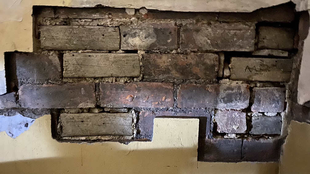

In the same room I found some dodgy plaster and took it off to find bricks had been replaced with brick-shaped pieces of timber. I assume this was one way of fastening into walls before wall plugs were invented!?
The reason for me asking is I would have thought if it made no difference the guys who installed it would have just moved it a bit lower.
It's hard to second guess why people do certain things at times.
Yes, but I've never seen them built in like bricks before.

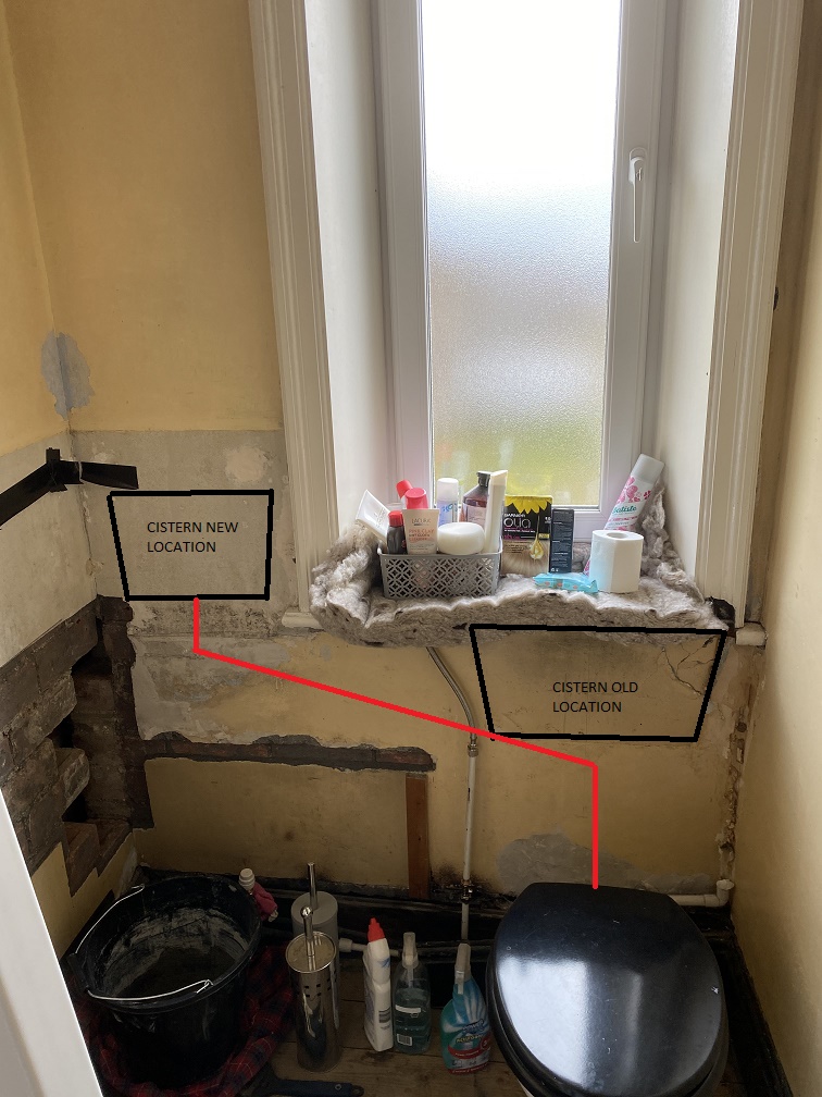

So I've removed the cistern, but I think it will still be in the way of the window area.
A random thought is that I could install a small cistern (something like this from SF https://www.screwfix.com/p/viva-skylo-dual-entry-concealed-cistern-7ltr/259hr) to the left of the window (see photo) and run a flush pipe from there down to the pan.
The problem I see with this is the flush pipe will need to be quite long. Is it possible to get flush pipe extensions / fittings so I can do this? The flush pipe will no doubt be 1.5" so am thinking I'd need to use 40mm pipe and somehow connect it to 1.5".
Sorry if this should be a new thread. Originally the thread was about moving the cistern down, but now it's up :)
