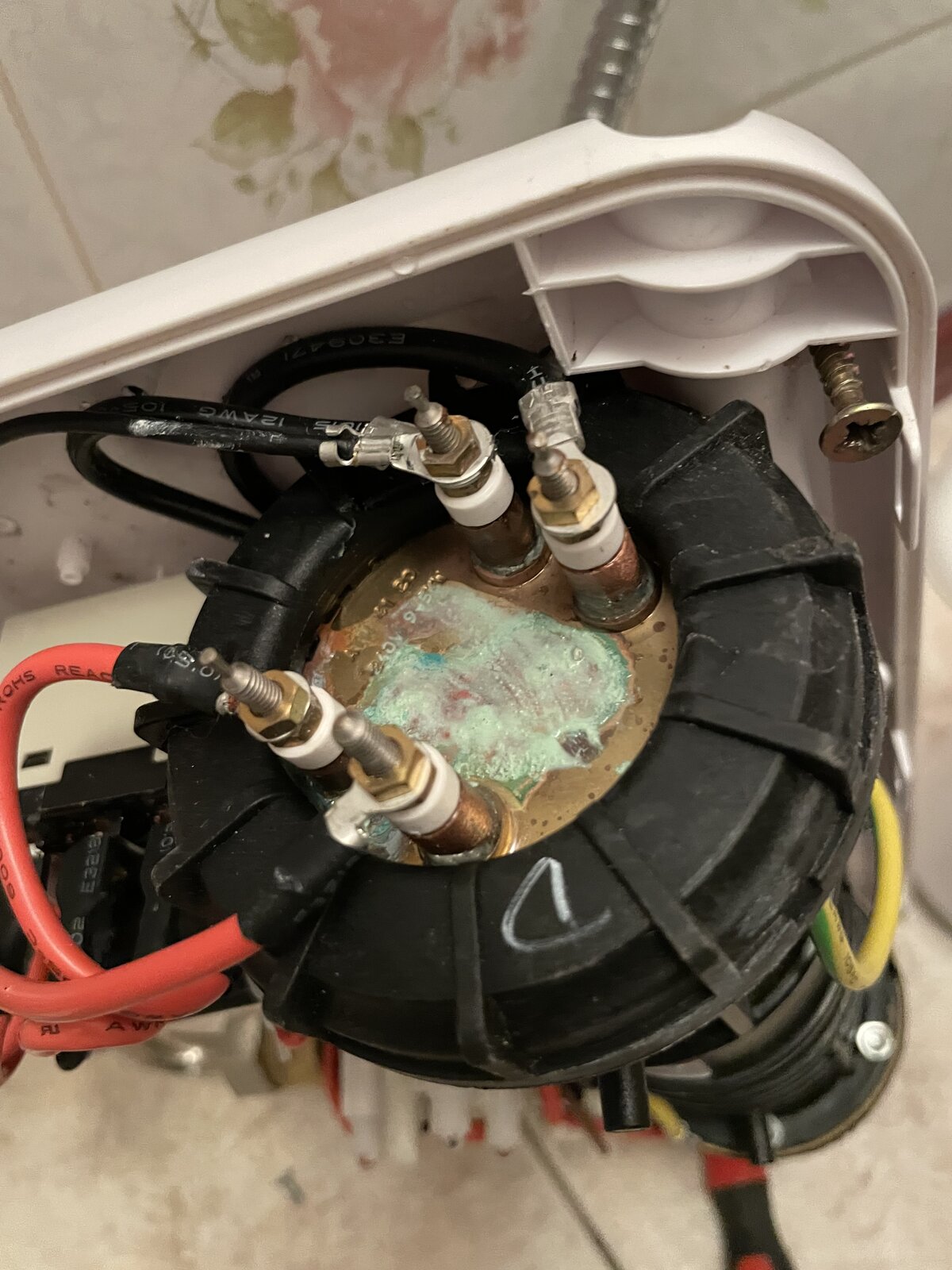

I just noticed a drop of water under my instant water heater (Ariston Aures Slim Instantaneous Water Heater 9.5kW)
I opened it and I found it rusted inside
I previously had a different brand that died by the same fate (https://www.redring.co.uk/product/rp1-powerstream-95kw)
Is it just bad luck or they are all crap?
The first one lasted 3 years and this one just over 1 year
Looks like a combination of white limescale, and green copper corrosion.
Clean it off with a green scourer, blow talc on it, watch. The leak will leave a trail to show you where it comes from.
