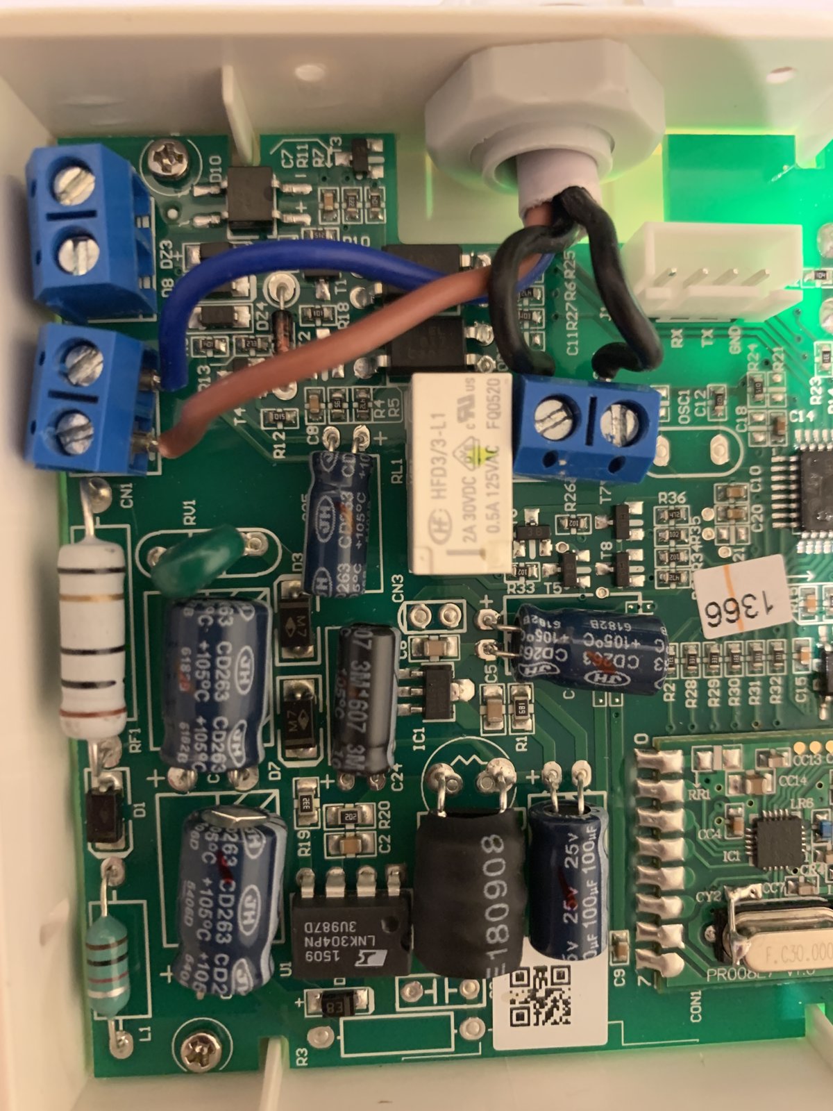

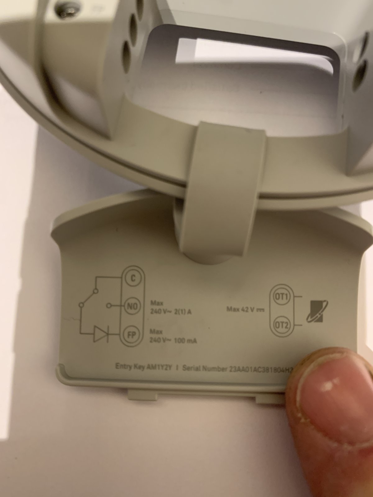

Hi, I am looking for some advice. I bought a Nest e Thermostat to replace the wireless programmable thermostat on my Vekera Maxim 29 boiler but I am not sure of the wire connections. The Vekera thermostat has L and N then two black wires connected to CN4 and the other to the adjoining block but there is no label
on it? Also not sure of the Heat Link connections either which are C, NO, FP and then OT1 and OT2 - any help appreciated and photos to follow.

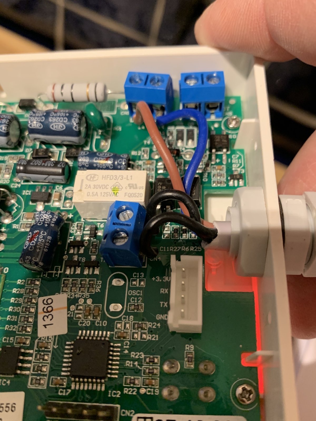

Sorry for any confusion, the photos show the current Vokera Wireless Programmable thermostat wiring that I am looking to replace with the Nest Heat link.

Hi Eric, sorry from the picture of the existing thermostat, which wires would be Com and No - it’s not easy to tell as two wires are black and the other are live and neutral? Many thanks Alex

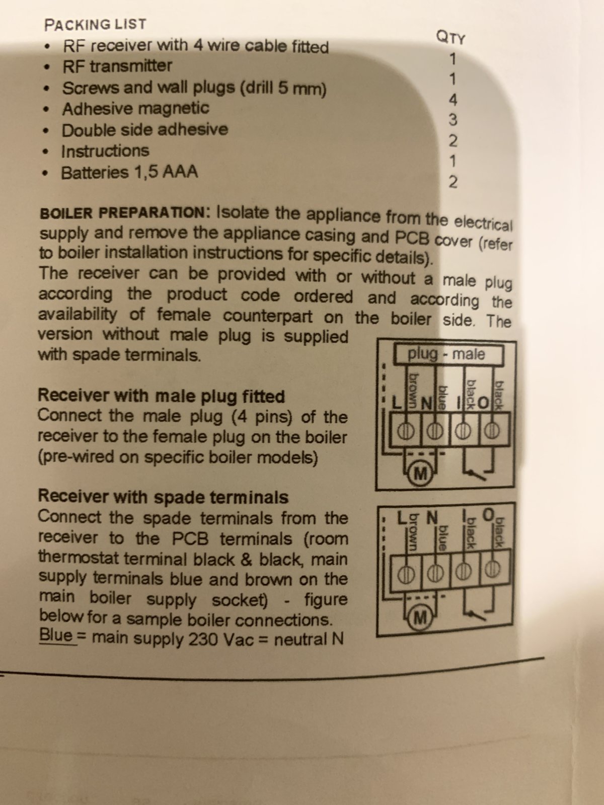

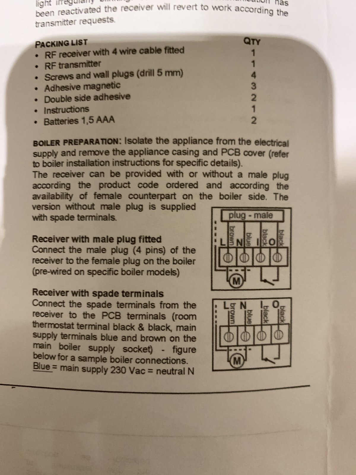

Also the black wires are labelled on the Vokera wiring diagram as I and O if it helps?
the two black wires go to C and NO dont mess about with it as if you blow that PCB they are expensive
Thank you. Does it matter which black wire goes to which or just wire them to C and NO? Thank you for your help.
Thank you so much and That gives me peace of mind. Thanks again and have a great weekend!
