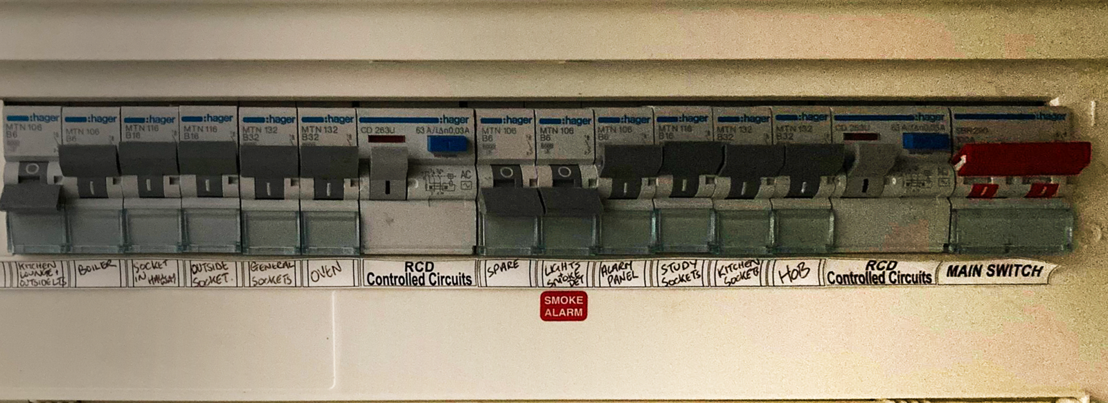

Hi,
I'm converting an integral garage in my bungalow to a bedroom and a small workshop - workshop literally a 1.5m deep space behind the existing roller garage door which will stay.
There's enough existing sockets in the garage to serve the bedroom section and one double socket in the workshop space - which would do most of the time but I'll also brew beer :) every couple of weeks in there and this means a 2.4kW heater element, a 3kW heater element and a standard domestic kitchen extractor hood possibly running at same time for a period of 1 - 2 hours and there's already 2 fridges in there. So I could do with another set of sockets anyway but should I take the plunge and get an Electrician in to run an extra circuit? There's a new consumer unit already showing individual MCB's for "Kitchen Sockets, Study Sockets, Hall Socket, General Sockets, Outside Sockets"and with a spare available - it's only a 3 bed now 4 bed small / medium sized bungalow.
For various reasons its a bit of a faff getting someone out to have a look, but happily will do if its deemed worthwhile / necessary to keep the place compliant / safe.
Thanks in advance - a few free pints of homebrew to any extra helpful answers :mrgreen:

Post a photo of the consumer unit and surrounding area with the meter etc.
Here you go.

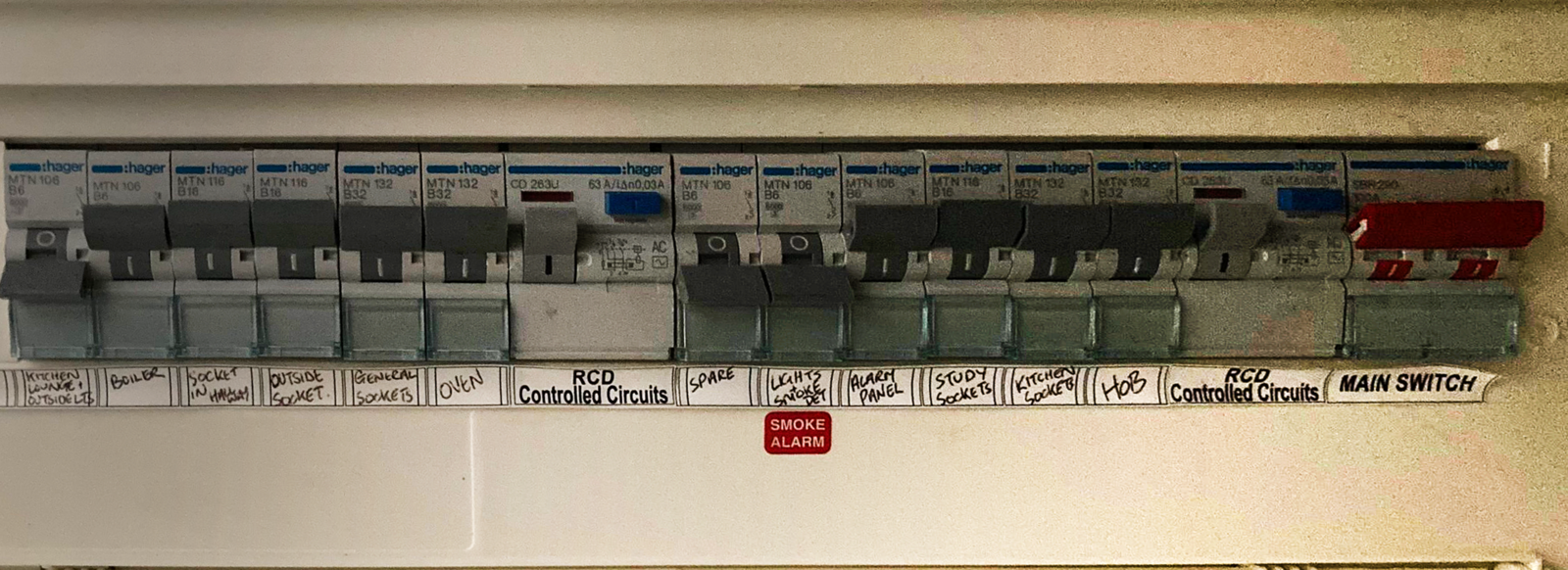

Cons unit is in airing cupboard on its own about 1 m down from ceiling and all wirings concealed, house was apparently rewired with new unit 3 - 4 years ago. The previous owners who put that in subsequently must have rejigged rooms around as there is no Study hence not easily to trace which rooms which. Meter is in the garage.
Looking at your consumer unit
Study sockets, hallway sockets, and outside sockets only 16 amp so limited load on those circuits. But there should not be a problem if either more than one circuit or the ring final circuits are used.

P.S. also into photography so cleaned up your image a little to see MCB sizes.

Top job thanks.
