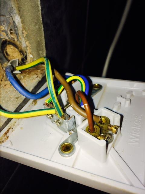

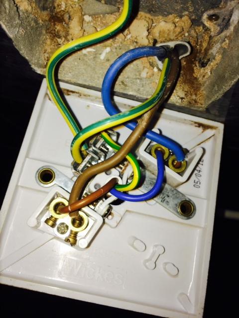

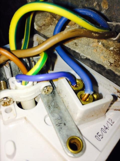

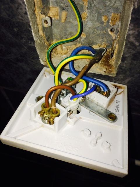

Problem is, there's a faint tingle when I touch the towel rail :cry:
The element is seated correctly and isn't bent or anything (I thought it might have been touching the inside of the rail somehow). The connections all appear to be fine, as well as the earth to the backbox.
So I'm calling it a day. The towel rail has got me beat me. I'll get an electrician to have a look.

Your not having much luck are you, did you test the new element before you fitted it?
Sound like you have a missing earth.
Story of my life, mate!
Yeah that's what it sounded like to me. But I've given up on it now. I didn't check the element before I fitted it, and am no longer inclined to unfortunately :cry:
I've been well and truly beaten into submission by a heated towel rail, and have disconnected it until an electrician who knows what he's looking for can take a look for me :cool:
Cheers!
R.
I know you feel beaten into submission, but if you felt so inclined, you could test with your multimeter on continuity setting between a socket and the flex outlet in the bathroom to see if there's continuity.
It's a "dead" test, so you wouldn't have to wortry about re-energising a dangerous installation.
