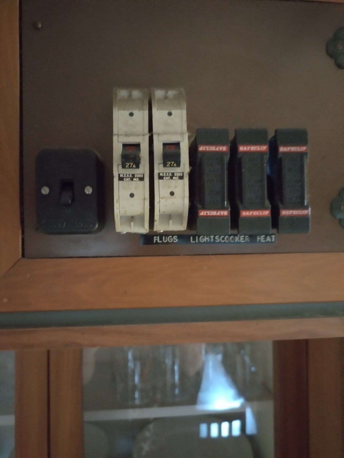

Fuse board in 1960s Motel room:
A wooden cabinet hinged on the right and with two wood screws securing it on the left. The old brown switch serves as the main switch.
The blue tape round the right hand device is a reassuring touch...
And it's interesting that even in NZ, sockets get called plugs.

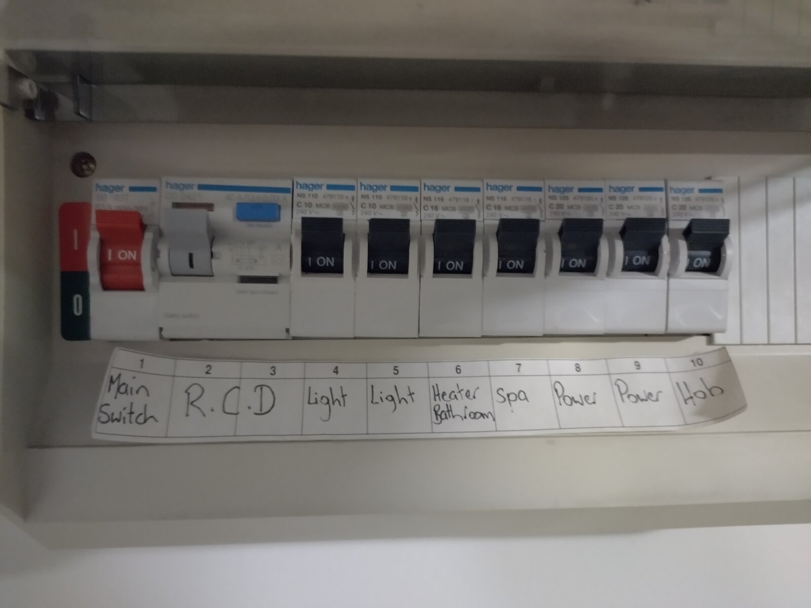

Not that it's easy to tell, but this is a GE board populated with Hager gear.
To my mind, the breakers go the wrong way in terms of value.
All the main switches in NZ have been one module wide, so I guess they are exclusively SP.
