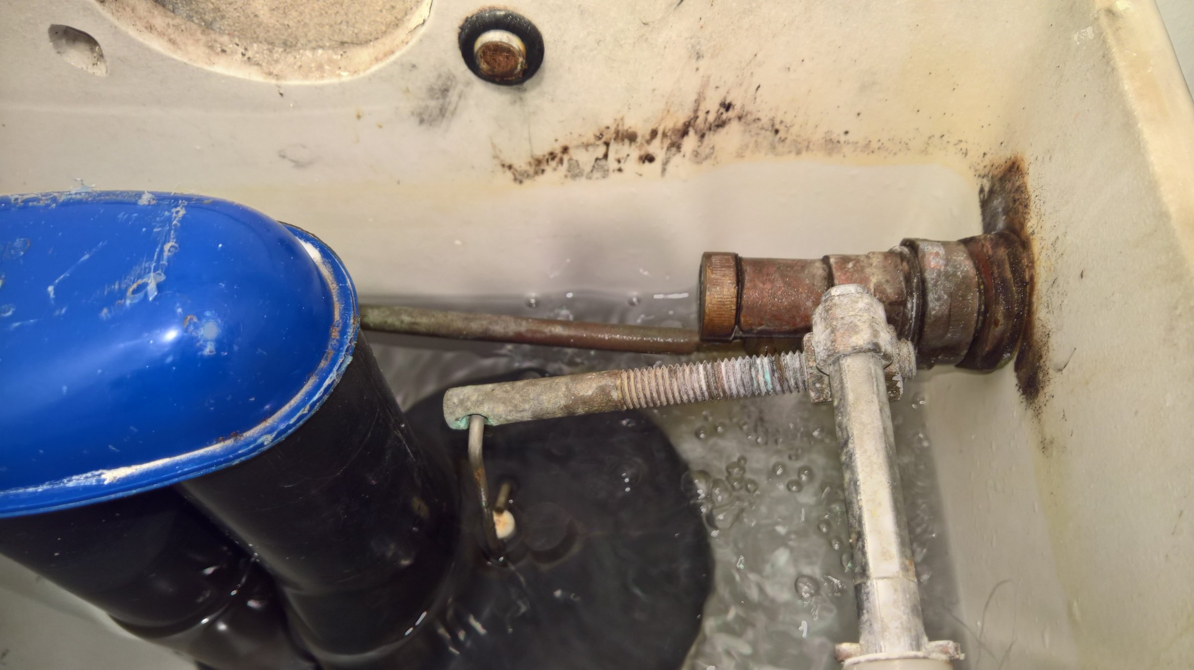

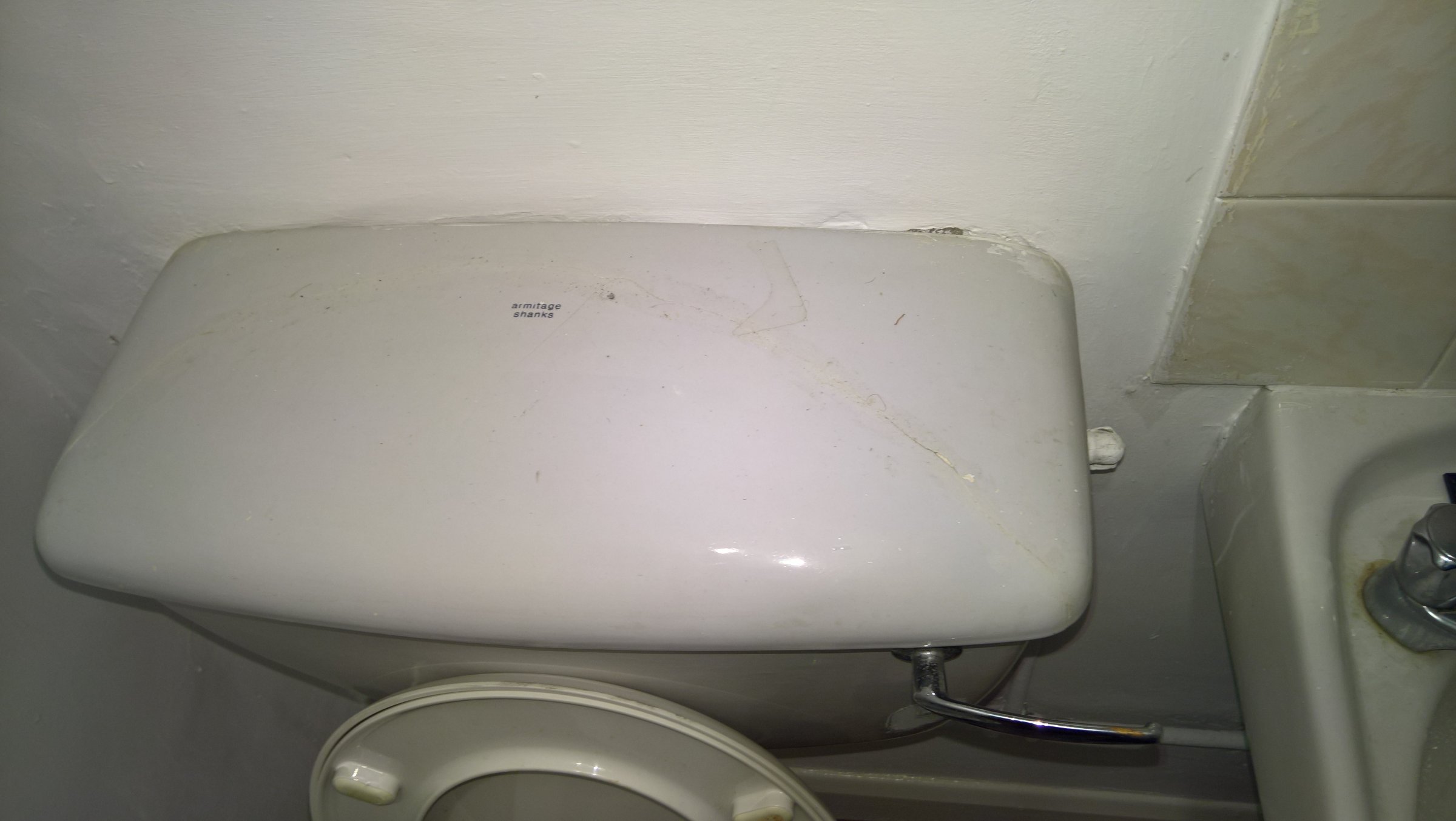

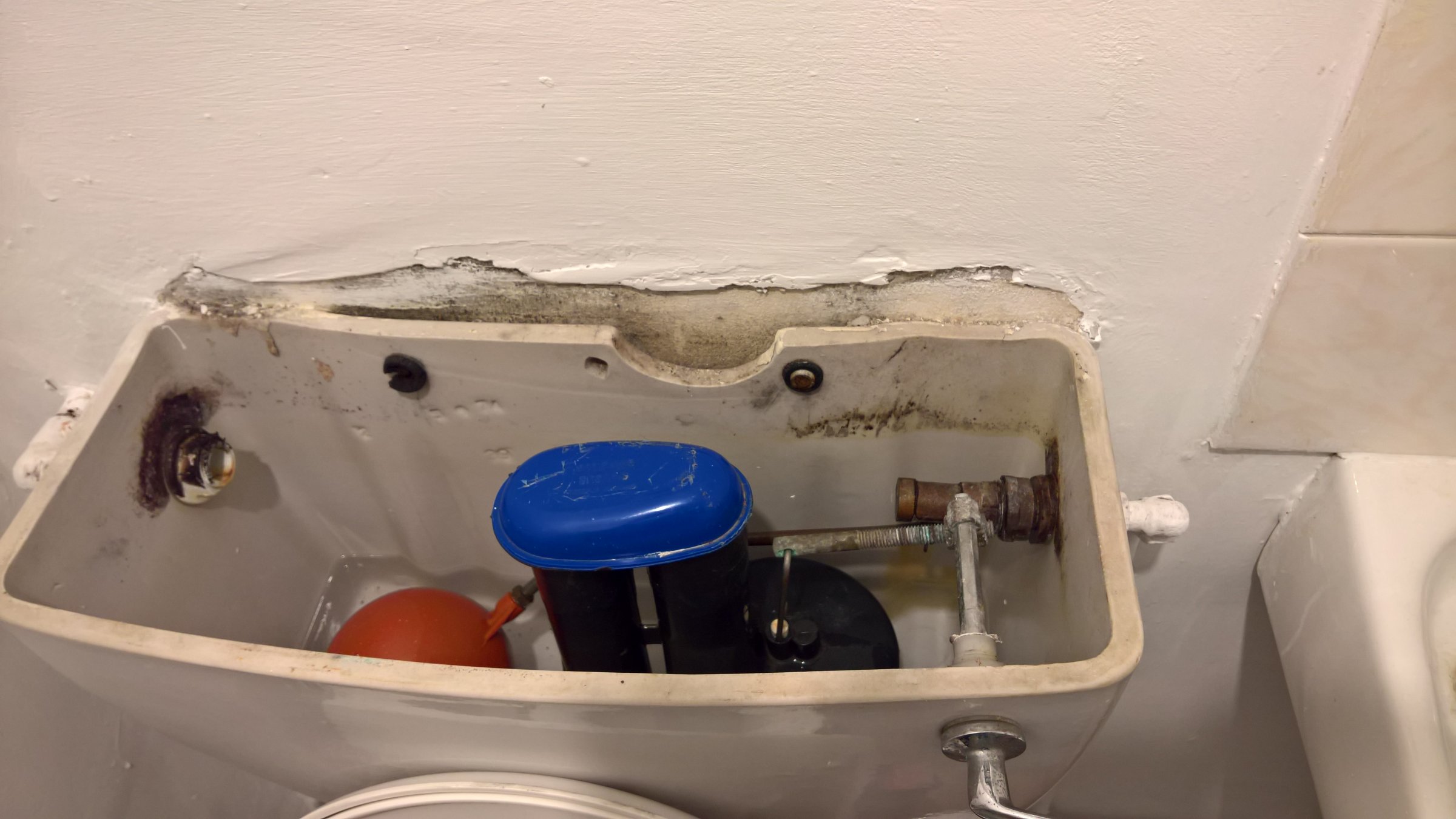

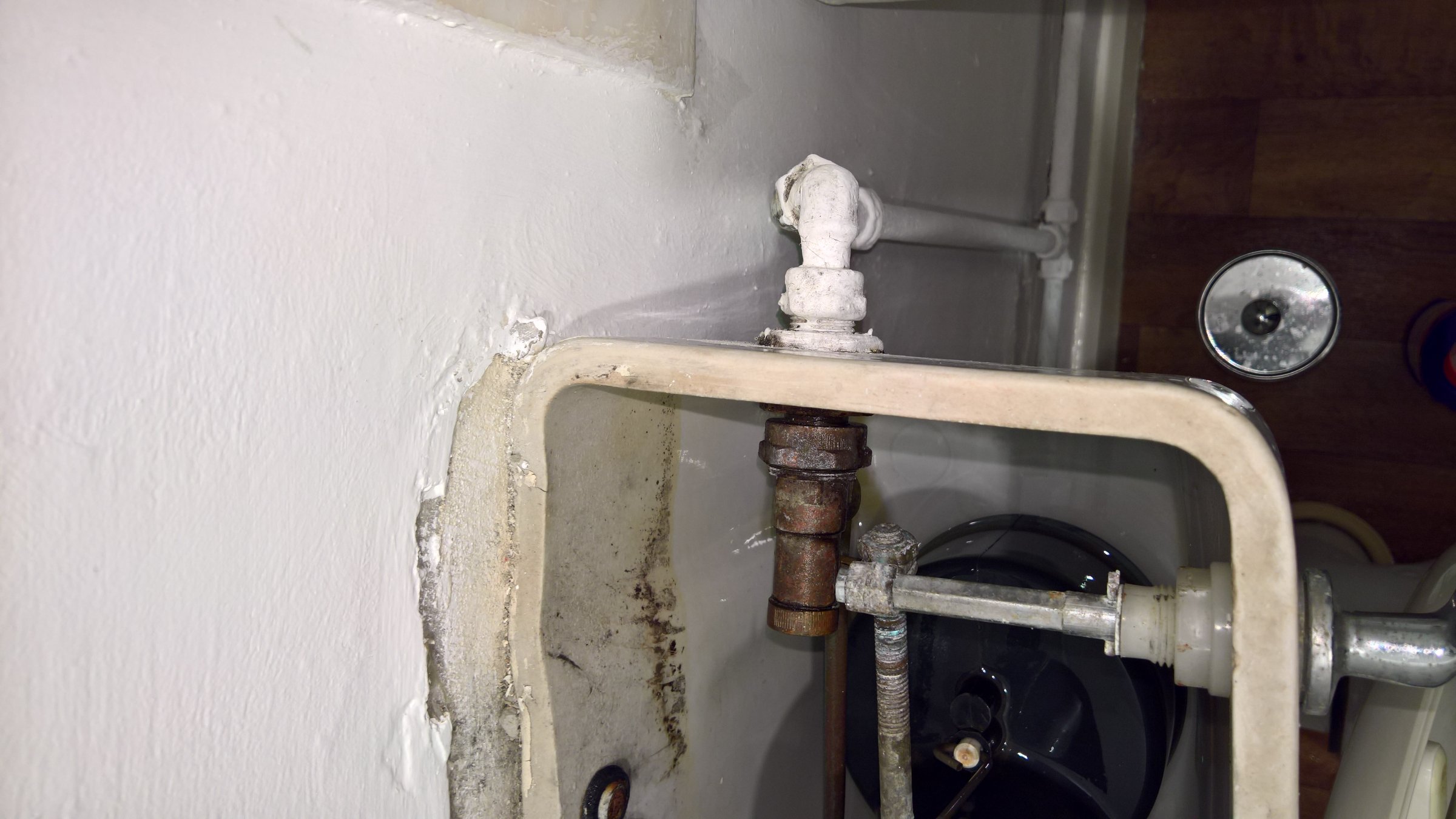

Cistern continues to fill after flush. A tap on the float settles it. I've been tasked with sorting it. It's outside my comfort zone to be honest, never seen so much paint on the external copper pipes. I've also never taken a really old float valve apart. (I've taken old ones apart, and replaced them but this looks really old, and possibly serviceable) I can Isolate the supply. Am I right in thinking just unscrew it all (Internal in the tank) get rid of the crud and put it back together?
Just for a laugh, if nobody replies, I'll take pictures anyway and you can tell me how I went wrong :)
Undo the knurled cap at the end, and remove the brass split pin. This allows the plunger, with a rubber washer to come clear. Replace the washer and all should be fine.
An alternative is to replace the entire valve with a type 2, which has an adjustable float.
John :)
Thanks John.

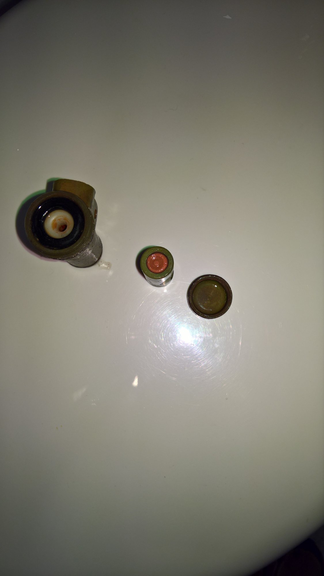

It all came apart quite easily. Cleaned a bit of muck from the washer and the end of the white plastic cone and it seems to have sorted it, but I'll try and get a new washer as it does seem rather worn. I presume I just 'dig' the old red washer out and the replacement presses in.
Don't dig it out ! the end unscrews - 2 pliers -1 holds I unscrews BUT a type 2 will be better for adjustment and backflow protection because the inlet is over the water level. Keep the refurbished one for your roof cistern;)
