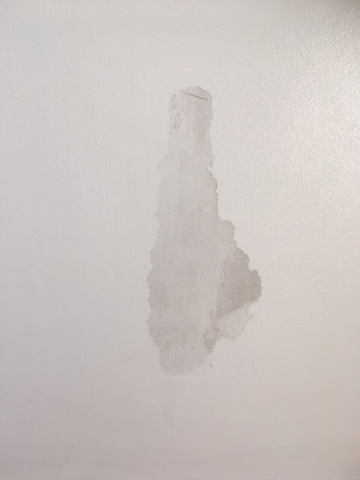

Over a year ago we had a wall replastered. It was left to dry for atleast 8 weeks then it was given 2 mist coats. Started emulsioning with no problem at all - using Dulux Trade Emulsion - all good so far. Putting a second coat of emulsion on I noticed in places in bubbles then takes off the 1st coat of emulsion. Anyone expalin why this is happening. It is not doing it everywhere - just random areas, but I have stopped painting the 2nd coat for obvious reasons.

Sorry, I didnt make myself clear, - it was plastered over a year ago. Over 8 weeks later it was given 2 mist coats with a few days in between each coat. So about 3 months ago it was given its first coat of Dulux trade emulsion and today I went to give it a second coat of emulsion and then the first layer started to bubble up and lift off. Some places you can see the white mist coats and other parts it goes back to the new plaster. It is not all of the walls just random places. This room isnt used a lot hence the slow decorating.

There is a lot of stoopid advice out there (on the web). Dulux Trade should be watered down by 10% for the mist coat. Some people recommend a 50-50 mix. That soaks in so much that it doesn't deal with the "suction". Two mist coats that thin means that you have wasted your time and that the next coat still needs the 10-90 ratio, before applying a full fat coat.
To make matters even worse, some of those people recommend using "contract" emulsion first (as the dilute mist coat). They are not (reputable) professional decorators.
Sorry for slow reply 50/50 ithinned the paint down - was it too thin or too thick. This is driving me mad now.

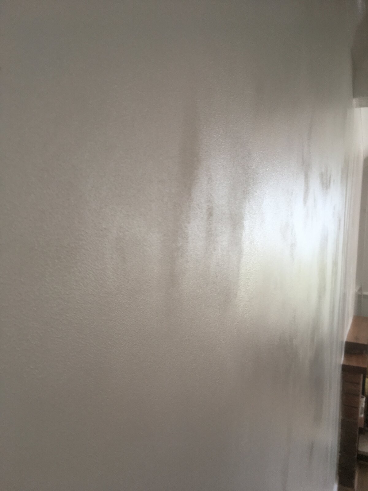

I have tried to give the wall the remaining 2nd coat and yep youve guessed it blown off in different areas now. I honestly could cry. Not only am I wasting my time but also the paint which is not cheap!!
Also my rollering is crap on this wall too which isnt helping at all. Been fine on all the other walls no problem at all but this wall its bloody awfu.
Have posted pics - the paint is still wet on the wall so its looks like a high sheen but its Diamond matt
