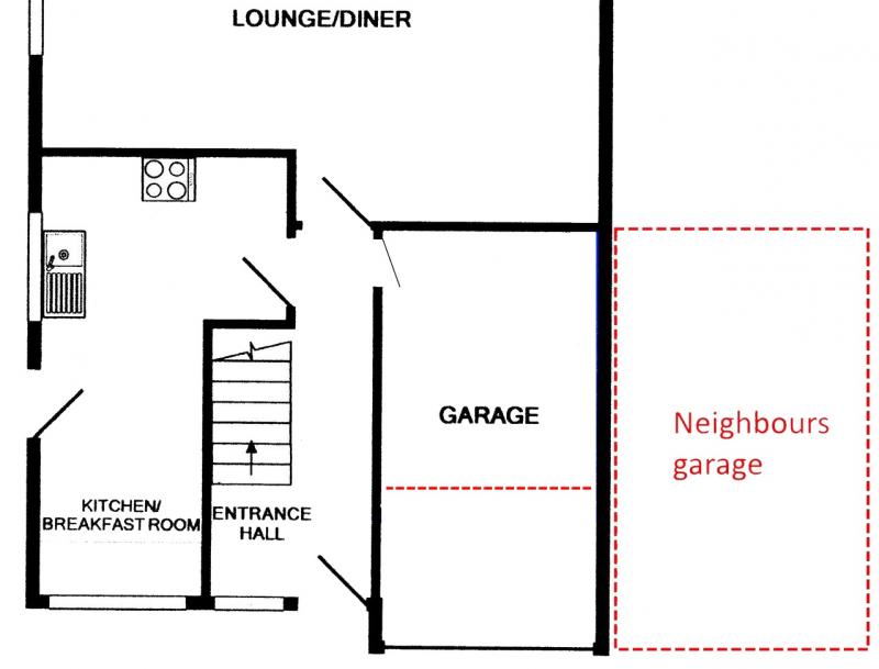

Hi,
I'm going to convert part of my integral garage into an office space at the rear with a small garage remaining at the front.
I am going through Building Control and understand I will require some ventilation but there will be no window or access to any external wall as one side is the hall way and the other is the neighbours garage, with the rear wall backing onto the lounge. And to top it off above the garage is a bedroom.
How can I provide ventilation to this new office room? Would venting to the garage space be sufficient? Would I need an extract fan? The size of the office will be approximately 2.6x2.3m once insulation and everything is fitted.
Here is a picture of the house and a plan view to get a better understanding.
Gareth
I would try the angle you have already suggested ie venting into the garage space as that presumably has a leaky garage door so a vented space in its own right. I did something similar when I needed to retain ventilation to a living room and we added a conservatory onto the only external door/window, it had a trickle vent and as we added vents to the conservatory BC were happy to accept it.
