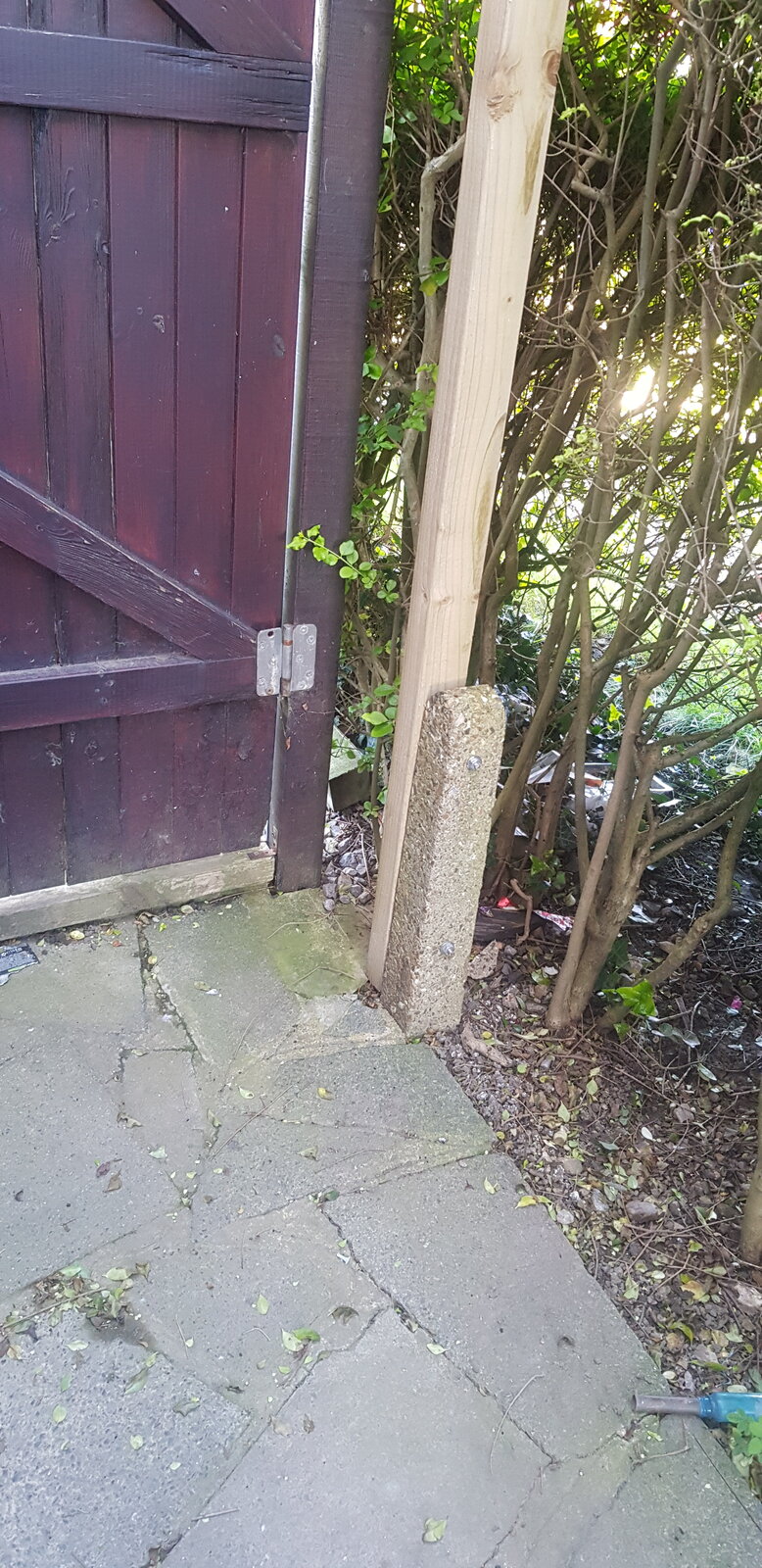

So... Before i potentially waste my time (and money); is this a viable option?
I am in the process of a landscaping project at home and i have created a space that we want under cover, i plan on using corrugated bitumen sheets as the roof so nice and light.
I have put in new fence posts all 3FT deep into clay and 400mm-450mm dia holes full of 5/1 concrete.
Can i fasten the upright supports to the fence posts and create my framework up top OR should i not and put in some dedicated timber posts to support the pergola?
Concrete posts can be surprisingly easy to snap if you get enough leverage. I had to move one, it was only a couple of years old and concreted in. It snapped near the base very easily after a push.
You'd have a couple of metres of leverage. Someone casually leaning on it could snap it.
There are fittings for hanging from concrete posts, you don't want to drill them. But they're intended for bits and bobs like lights and baskets, not structures.
Don't know about that.
I've covered my alley 15 years ago and bolted the wooden structure 2.4m high to the existing 2 foot concrete posts.
No movement whatsoever.

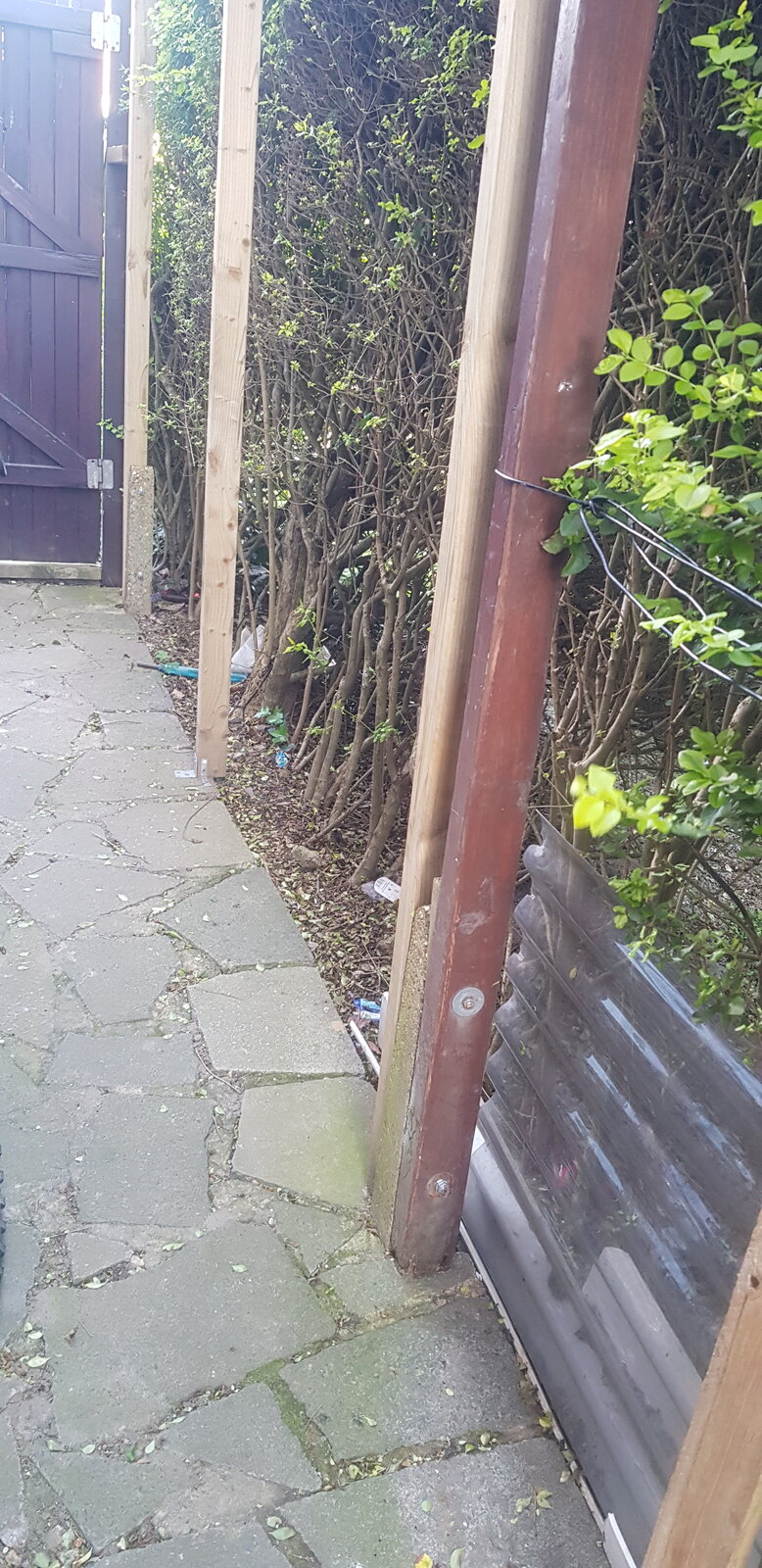

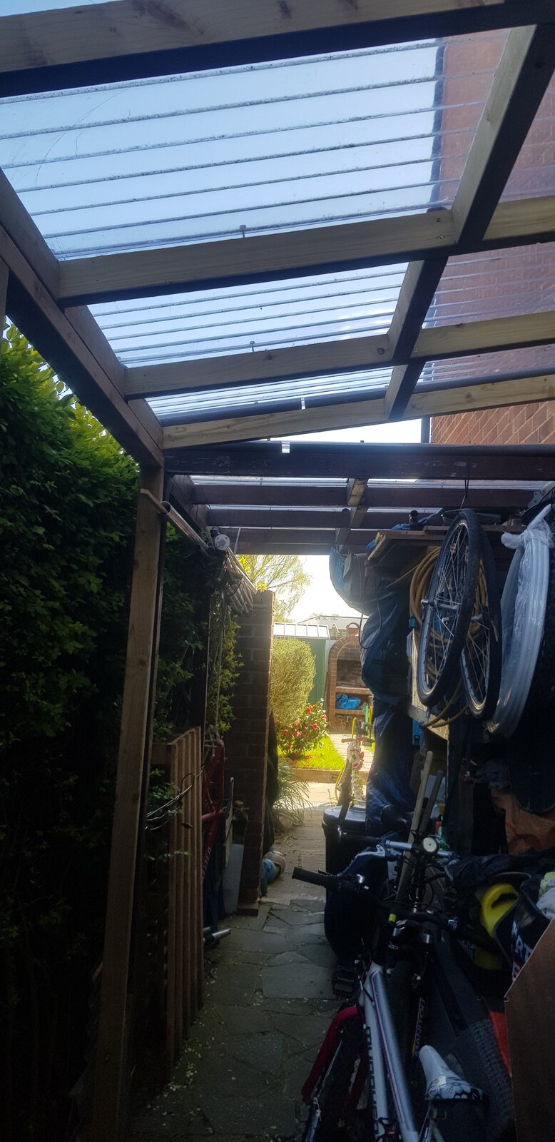

got any photos buddy?
Was done in 2 stages, 2 years apart, using recycled wood for the brown part, hence the difference in the 2 structures.
I meant to dismantle the brown bit and continue the other one with the better slope, but things get in the way...
