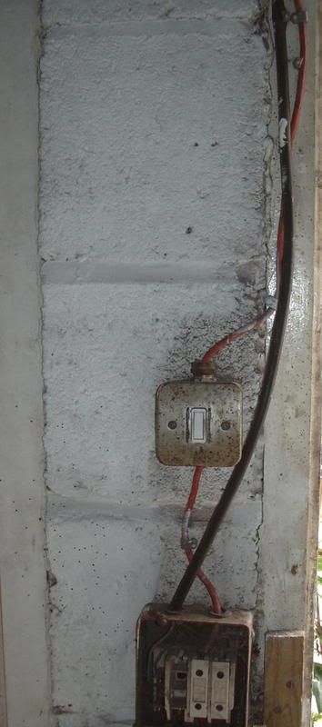

I was carrying out a domestic PIR this week, and all was looking in a reasonable condition.
And then I wandered into the garage.

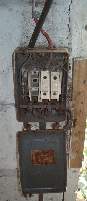

Garage CU:
This was supplied with a 4.0mm² T+E underground in a bit of drain pipe. It was also jointed out in open strip connectors.
Garage light switch:
Supplied in lawnmower flex

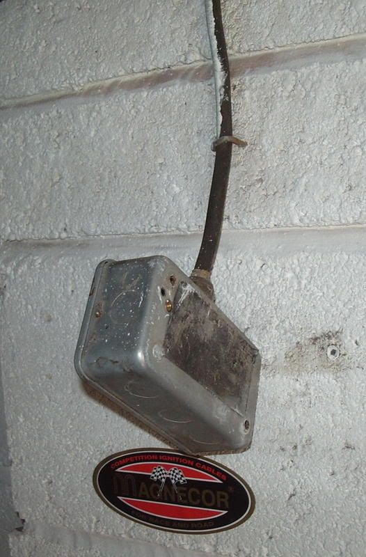

Garage socket:
Supplied in rubber flex, clipped with fencing nails, and not attached to the wall

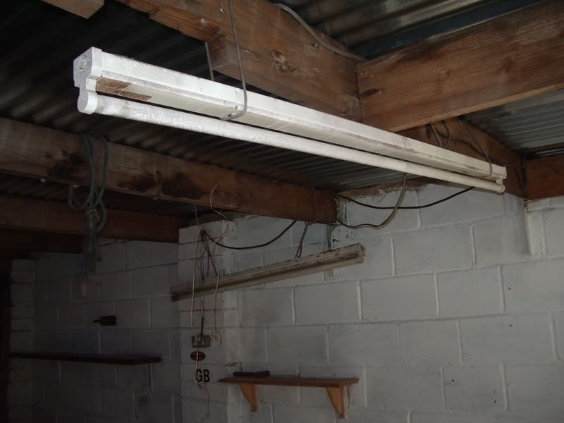

Garage lights:
Attached to the roof with bits of string, and generally scruffy wiring
That's a bit of understatement!
Good quality string though. I saw a few lights in stable hung with orange bailing twine which doesn't look anywhere near as nice :LOL:
