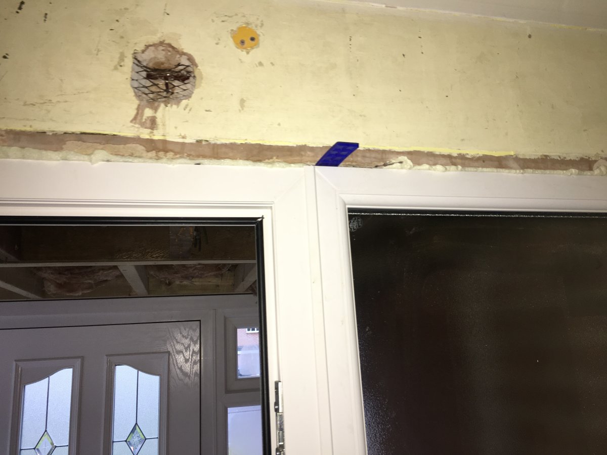

I just had a go at my plasterer for removing some plastic window packers on my new Upvc window/door. What is the correct way to finish them
Some photos would help.
Has the frame been foamed around? And has it been fixed with normal screws or concrete screws with a star bit head?
Assuming they have used concrete screws (self packing) then shouldn't be any problems. Packers are mainly used to hold everything in place while you fix it and until the foam has gone off.
Still better to cut them off flush with a chisel though.
