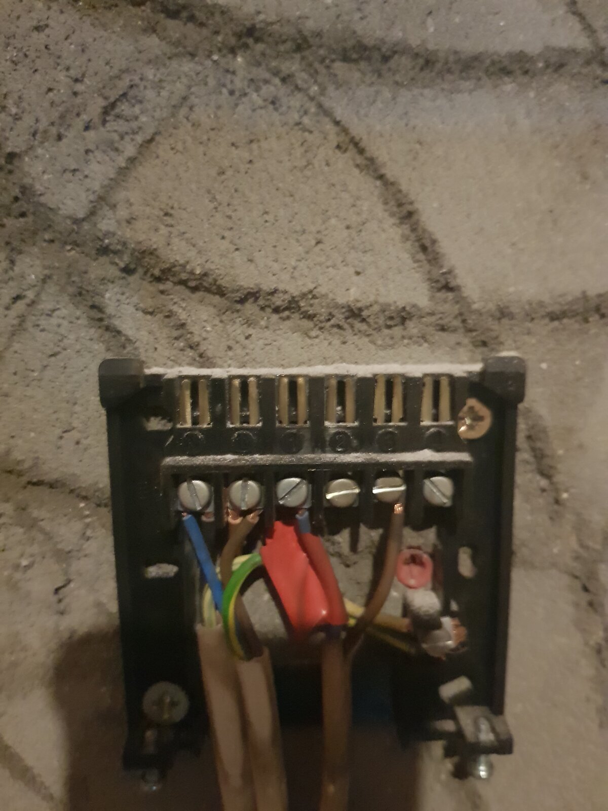

Please help.. Wifi thermostat installation to valiant turbomax 824
19 Jan 2021
3
2

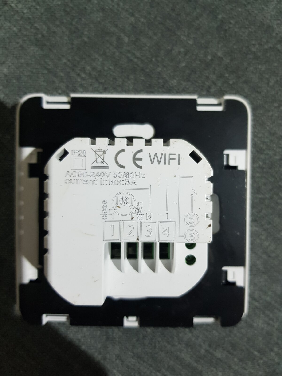

Can someone tell how to connect this
From this?
Boiler: vaillant turbomax 824

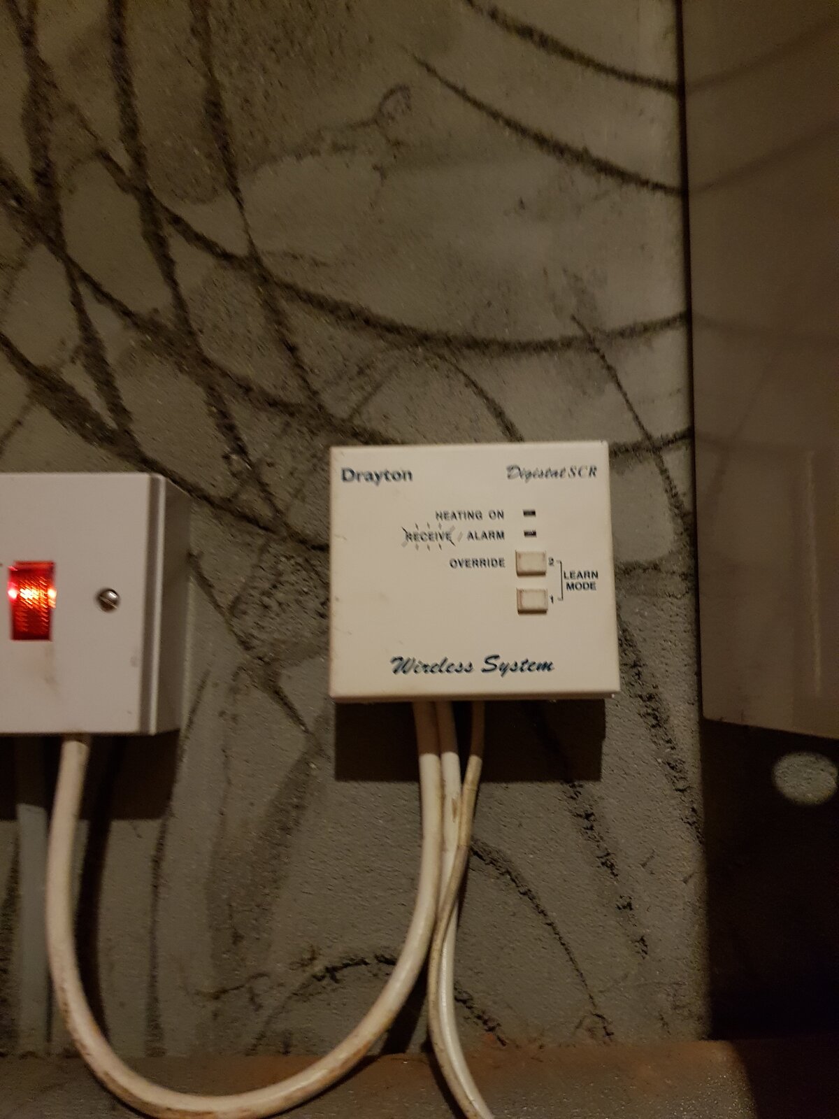

That looks like a programmer/timer that you’re trying to replace. There appears to be an additional live and neutral, which could be the boiler feed. Do you have an existing thermostat?

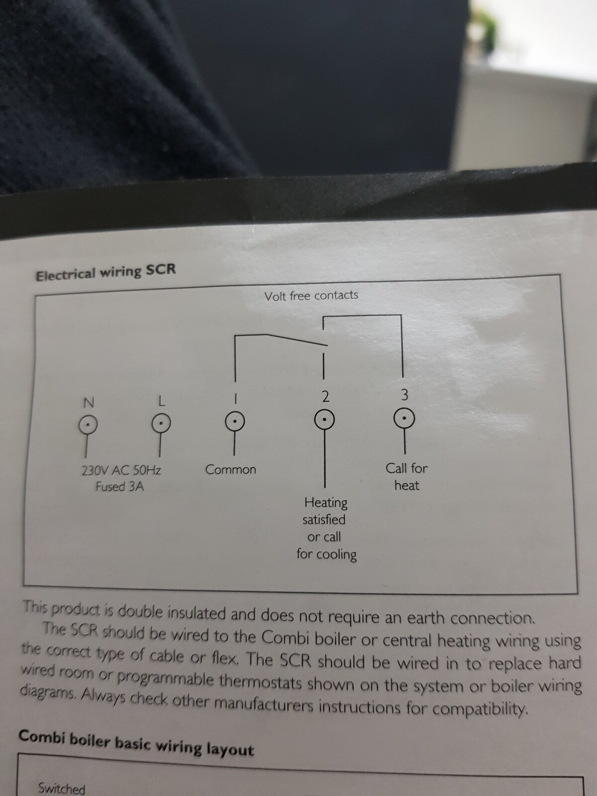

Essentially it’ll be all Lives to L, all Neutral’s to N, and 1 to 1 and 3 to 2 on smart stat respectively.
Should be ok to wire up as I’ve suggested then, if you can get them all in.
