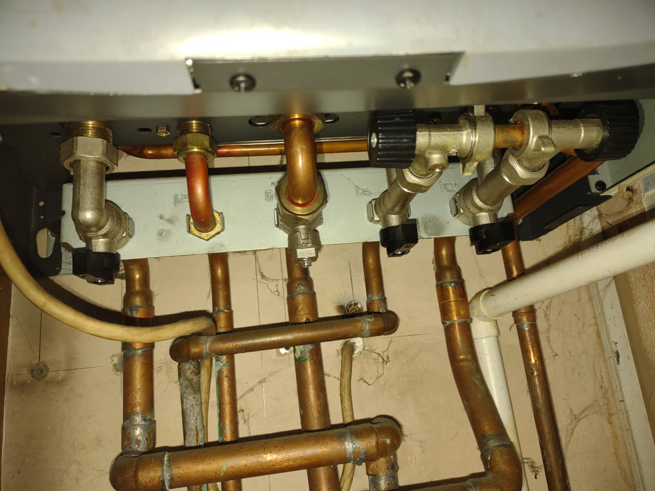

Hi all,
I was wondering if you could advise me please. My Potterton boiler needs re-pressurising as the gauge has dropped close to zero. I thought I would need a flexi-loop but the piping looks like my attached image.
If I were to turn the valve on the 4th pipe along from the left, would this release the water into the system?
Thanks in advance.
It looks like the 2 wheel head valves. One is at the end of the pipe you’re counting 4th from left.

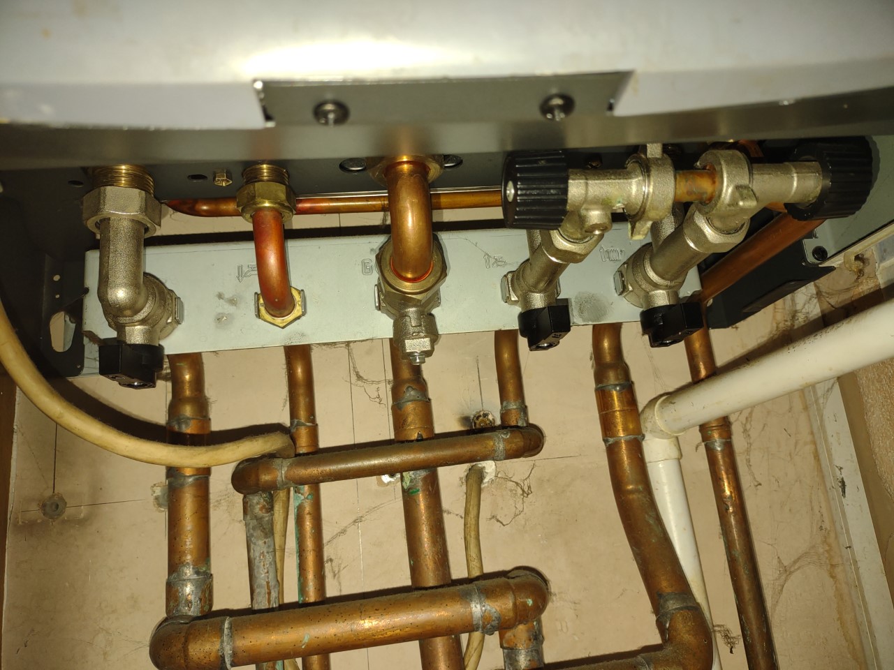

you need to turn the two valves I have marked, anti-clockwise until the pressure increases to between 1.0 and 1.5 Bar then close them again, make sure you close both
