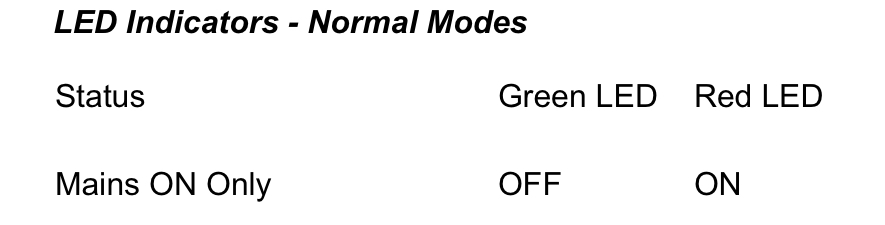

i have a suprima 50 that tries to start up then shows a constant red light when it first starts up when the programme calls for heat/hot water.
when i press the reset the boiler starts up and continues working for the rest of the programme duration.
i am a qualified sparks so looking for any pointers where to start,i know its an old boiler but just trying to nurse it though until i can afford to get it changed.
Are you sure it’s solid light? Normal operation according to the manual

One LED or two? Newer PCBs only have a single, multi colour, LED.
On newer PCB hold reset button in for 10 seconds and count the flashes - 5=overheat, 2=ignition failure
one LED.if i hold the reset in it restarts ok but i will try that next time it plays up.
ok,it went to solid red and i held in the reset for a while but it didnt do an LED count just went into boiler start when i released it.
