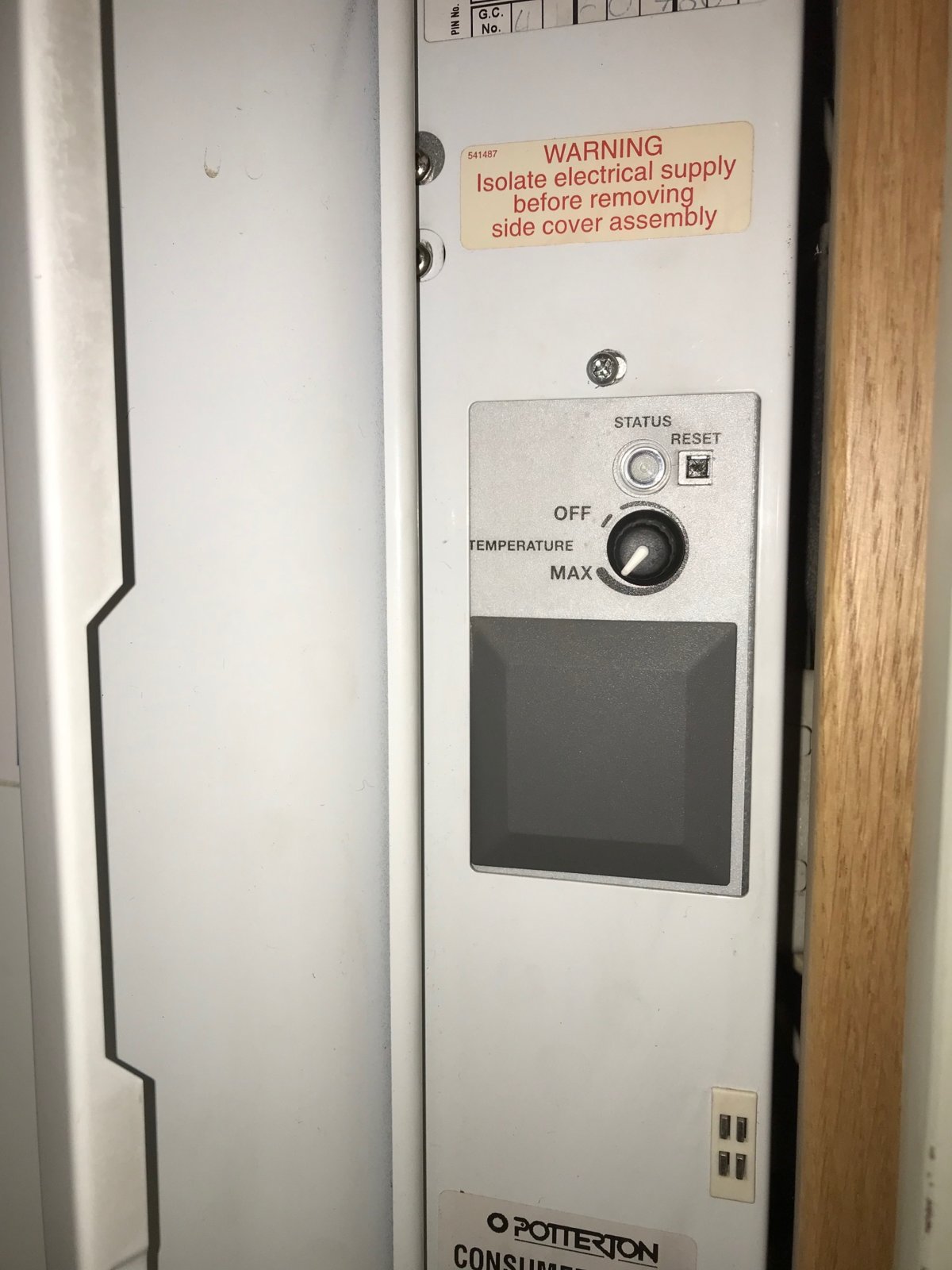

I’m having the following issue with my boiler pump:
after the hot water and heating “clock off” from their programmed stop times the pump randomly continues to run on.
There is no pattern to this that I can establish sometimes it’s only the Hot Water sometimes only the central heating, sometimes the issue doesn’t occur at all.
Where I have the central heating programmed to start After the hot water has passed it’s off setting (early morning setting) the pump just keeps running stopping the Central Heating ON time to operate ... the only solution is to have the reset button on the boiler pressed in for a few seconds which stops (with a slight flowing/rushing water sound) the pump which has been running continuously from the end of the Hot Water off time.
The consequence being waking to warm water but a cold house.
To add, the warning on the boiler (Potterton Suprima 80HE) has either a solid red or flashing red indicator
‘Solid red’ - System Wiring Fault.
‘Flashing Red’ - Lockout.
However I’ve noticed the occurrence of both warnings but mainly the flashing.
Could the sound of rushing water I’m hearing upon pressing the reset button which stops the pump, be indicative of anything - air in the system perhaps ??
Hoping someone will have experience of such a problem and offer some pointers...
Many thanks.
has the PCB been changed to the more recent ones a pic of the front of the boiler and red light will tell
Thanks ianmcd, Im uncertain of the history as I only bought the house a year ago. Ill take a pic of the panel with the light and upload that.
yes you have the upgrade PCB , but that doesnt mean it is not faulty, I have replaced a fair amount of the upgraded ones, your pump is wired into the boiler controls and when the boiler goes off the pcb will keep the pump running to cool the boiler down and will switch the boiler off when it is ready, but intermittent lockouts are usually the PCB
