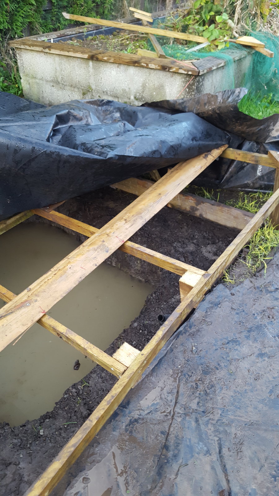

I want to lay a thick concrete slab to act as a base to a telescope. The slab is to be about 700*700*600 deep. I've dug the hole to the correct dimensions and now ,because of all the rain, I have a fish pond!
Is there any way I can pour the concrete without waiting for the water level to drop. Pumping out is no use as it fills up straight away. Is lining the hole with polythene and then pouring an option?

I dug most of the hole a few months ago and it stayed dry. With all the recent rain, the ground is saturated. I have been pumping it out so I can get the hole to its final level, but after a few minutes the water is ankle deep again and overnight it fills to about 500mm deep. The top is loamy soil and underneath is slate and clay, very hard to dig through. It used to be farm land.
If you can mix and pour slightly wet mix faster than the water rises then pump the hole almost dry and start pouring. The liquid concrete in the bottom of the hole will then stop more water coming into the hole. Then keep pouring wet mix until the hole is filled.
Concrete needs water to set so some excess water is not a problem unless it is either (a) washing material away or (b) allowing the mix to separate out.
The hole is currently about 350mm deep with water so it has gone down a bit (picture) I think that pouring even dry mix in could cause it to separate out.

I came across the Tremie method whilst looking on the web for a solution, but I had not come across the Bentonite one. Both seem a bit complex to achieve for a comparatively small hole, especially seeing as I am mixing and pouring the stuff myself.
I think I am going to have to go with the polythene method if no one thinks it is a bad move. I have the ballast and cement ready to go and have cut some wooden formers. I have a small mixer so will probably take 10 to 15 loads. Hopefully, if I can pump most of the water out I should get enough mixes in before the water rises up to much, especially if the water level drops a bit more. I could probably dig a bit of an "expansion" trench thinking about it.
Important thing is get your concrete flat on the ground underneath and straight vertical sides, to keep the forces symmetrical. So make sure no large void underneath from water that didn't escape
This is a common problem when building swimming pools. You dig your hole, the next day it rains raising the water table and you have an instant pool. You can't just pump it out and hope to get the concrete and walls in quickly because of the water pressure. The solution is to dig a small but deep sump hole next to the main hole that you can keep pumping, with a float switch if required, until the job is done. A smaller version of this could be used in this case, keep pumping until the concrete is in.
