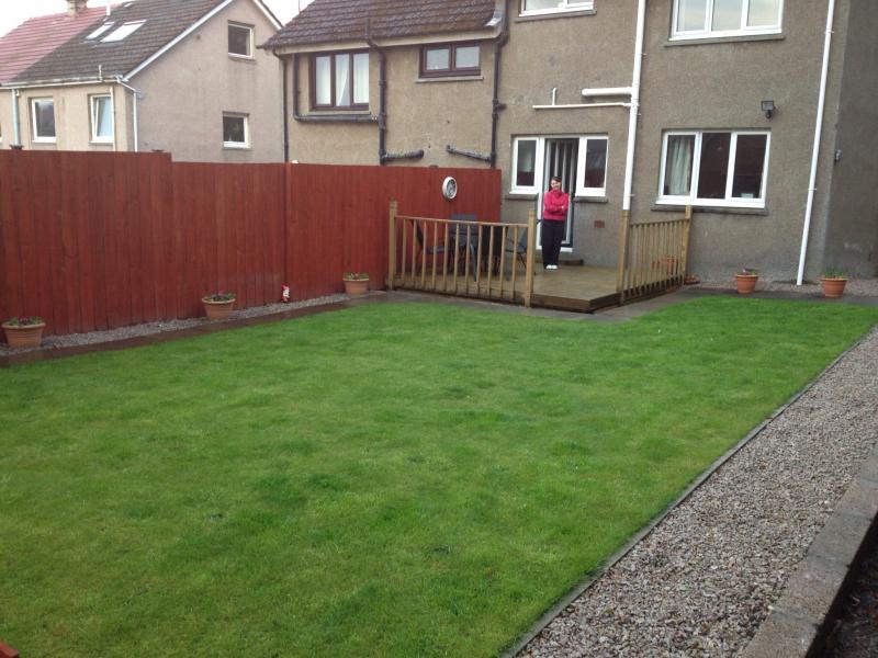

Looking to get an extension added to rear of 60s semi detached in Dundee to allow for bigger kitchen. I've attached image of house - extension will come out approx 4m and be around 6m across width of house. Looking for pitched roof and fairly standard design, couple of windows, door.

In London I use a ball park figure of £1000/m2 for single storey, pitched roof, standard foundations construction. It will cover a couple of rads and windows but not flooring, sanitary ware or kitchen.
A builder can't give you a firm quote if he hasn't seen the structural drawings.
