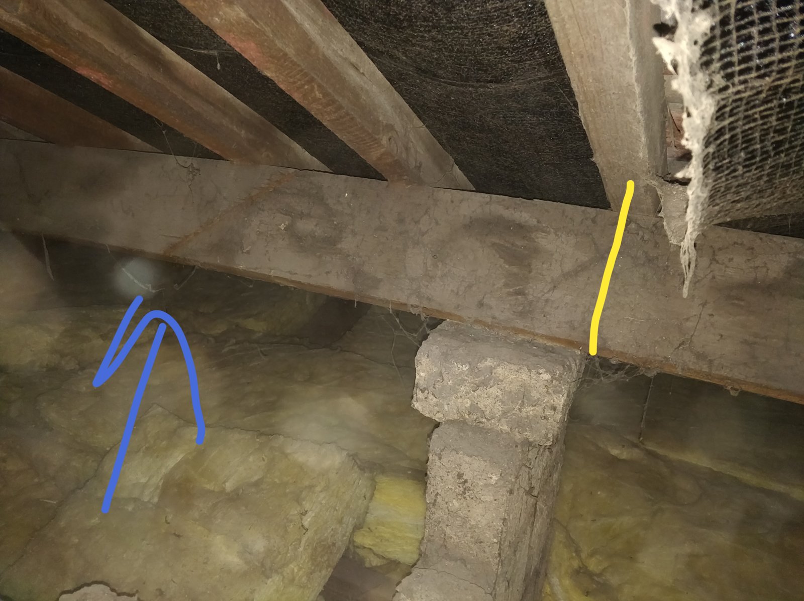

I'm starting a loft conversion on my 1929 semi detached bungalow.

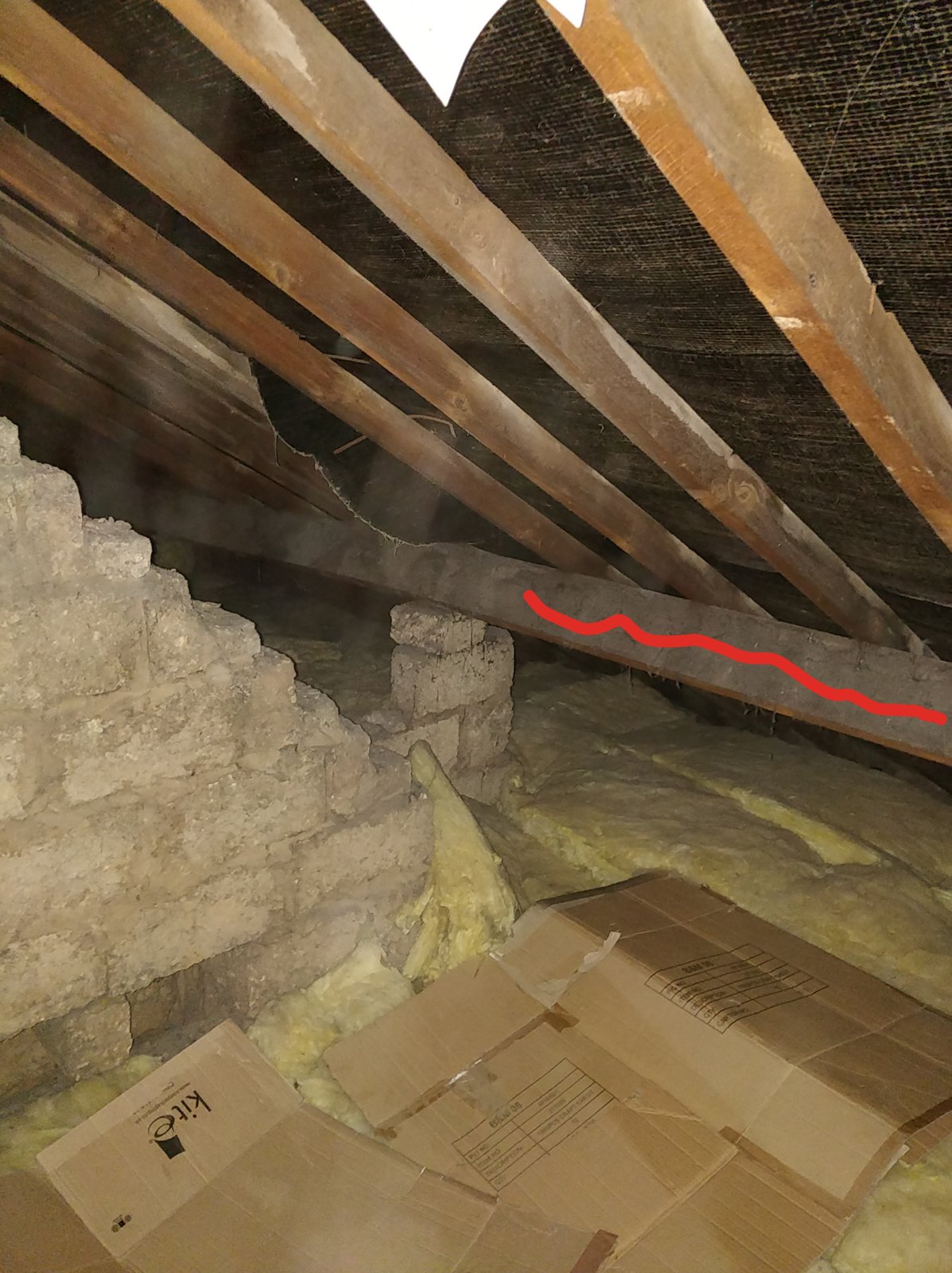

Architect/SE and BCO have approved plans to remove purlin (shown with the red line on my photo) and replace with structural stud wall on to new ceiling joists 195x75 c24. Two dog house dormers going in to.
Currently there is not a wall separating the loft space with next door (obviously will be all to regs).
On to my problem.
The photos attached will help with the explanation.
I want to cut the purlin supporting my side of the roof along the yellow line on my photo. The blockwork support for the purlin is staying and is built on the party wall.
The blue arrow shows a scarf joint in the purlin, this is on my neighbour's side of the roof.
If I cut the pulin on my side of the roof this scarf won't be supported will it?
Looking for suggestions thanks in advance.

The other side of the roof is opposite to this, i.e. scarf on my side so I can cut that with out issue. This is also the side architect looked at when he drew the plans hence sorta why he missed this side.

Use a length of steel channel (150 x 50 - ish) coach-screwed (not bolted) to the purlin, in a length sufficient to reach the block, and equal length the other side of the scarf - prob. around 5 - 6ft?
12mm ply glued/screwed both sides, or a large truss connector plate.
You'll need the owners express permission though, else its a trespass. And if I were him I would want a proper structural engineer's confirmation in writing that it is adequate.
Unless the Party Wall Act applies for the other work you are doing and you invoke it, then without some sort of agreed survey of the neighbours roof and ceiling and wall condition, then you remain vulnerable for a future claim for anything remotely connected to movement of the purlin.

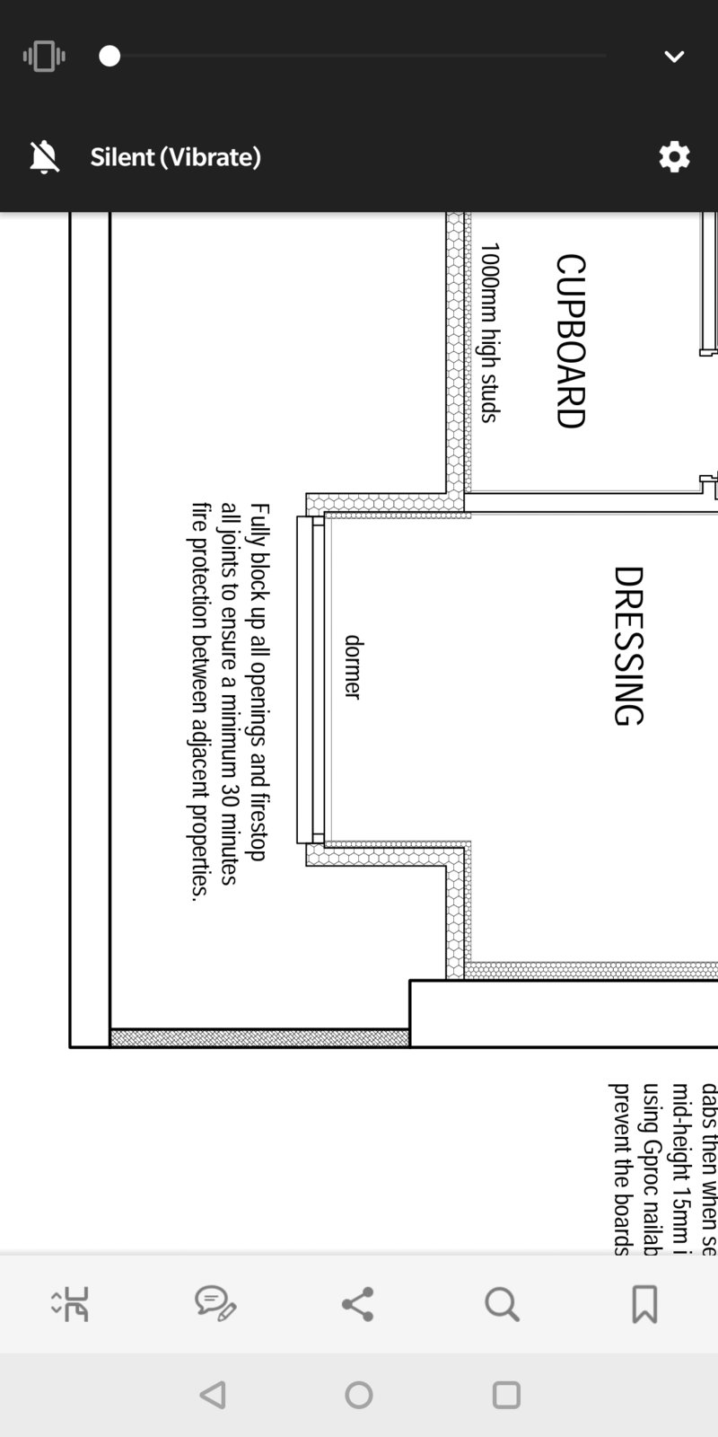

The new loft partion is detailed
the steel work that is now resting in the wall at the rear of the property.
No issues there.
Possibly could leave some of it on my side of the party wall approx 1000mm as that's when the dorma window starts
Would this be sufficient support my side an addionatal structural stud could go directly under it.
Possibly tie it in to the dorma framing to anchor it
Just thinking of different solutions.
Tony's or my suggestion will be OK. Its not a big issue, it just needs something across the joint
Ok will speak to SE so he can put something in writing and then get permission from the Mardy arse next door

A decent length of ply both sides would be ok structurally, but the space behind that purlin looks a bit tight and maybe difficult to work in - the joiner might be tempted to skimp on the fixings on that face?
Personally, I'd prefer to see a chunky piece of steel on the inner face where it's easier to work, and where all the fixings are visible and easy to check.

You can get to the other side fairly easy it's the angle of the photo
