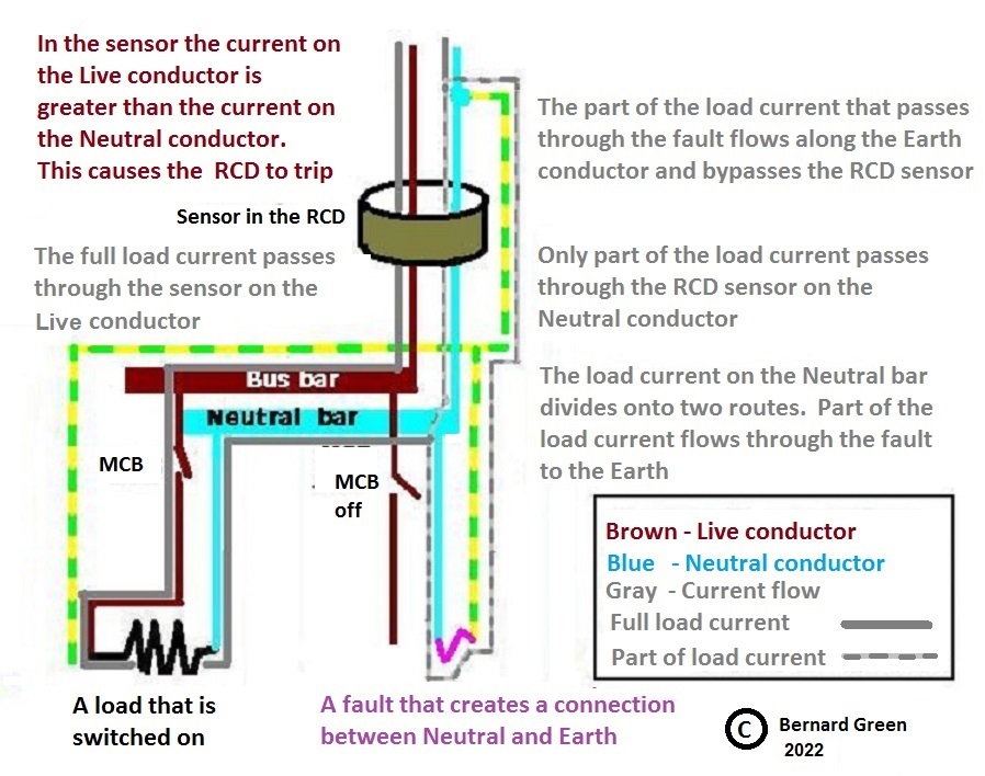

The multicooker might not be the cause of the RCCB tripping even though the trip happens when the multicooker is being used.
In this diagram the multicooker is the load that appears to be the cause of the trip while the real cause is a fault on a different circuit,
This fault is often traced to dampness in an outside lamp

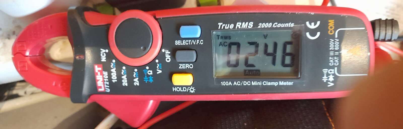

You get what you pay for, using RCBO's costs more than a RCD with multi MCB's and many take the chance it will not trip or if it does there is a clear fault, I am lucky, I have a tester
cost around £35 it is a cheap one, and I can test items, also I can test the leakage Testing voltage.jpg but without these tools it is hard to isolate what is at fault, specially with a earth - neutral fault. And since I have the testers I would use them, easy, but without these there is a lot of guess work, and it could be a combination of many things, under normal conditions we should not have over 9 mA of leakage, but when the consumer unit is fitted this is not normal conditions, not a single item plugged in, and I know in the past I have failed to measure background leakage. This house I checked whole house out of interest, 22 mA, not a problem shared between 14 RCBO's, but it would be with two RCD's, would need to be below 18 mA.
