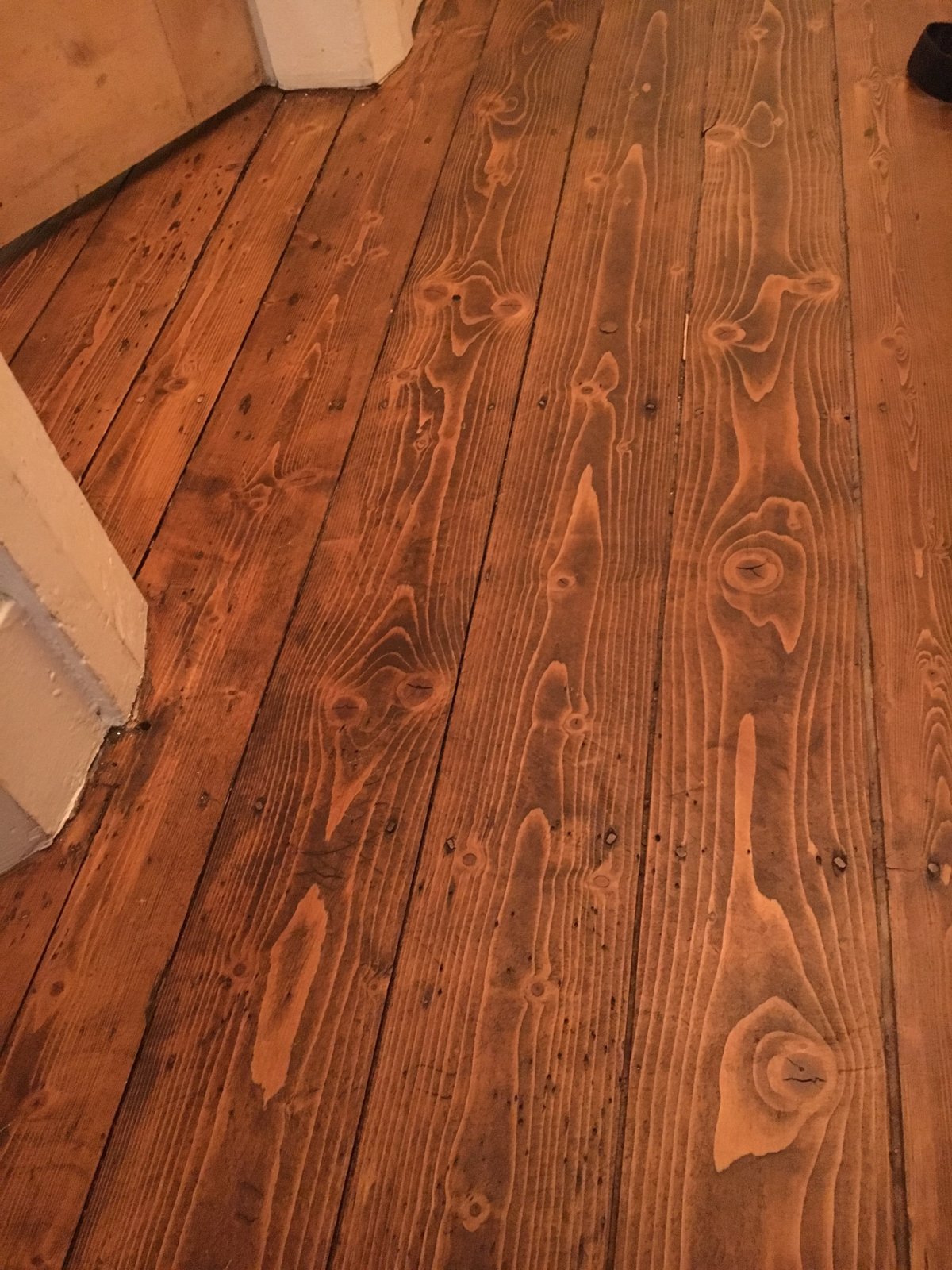

Would boards from a 1930s house tie in okay do you think?
Mine are like the photo attached...

They'd very likely match in okay, but you won't get the nice patterns that the pitch pine has.

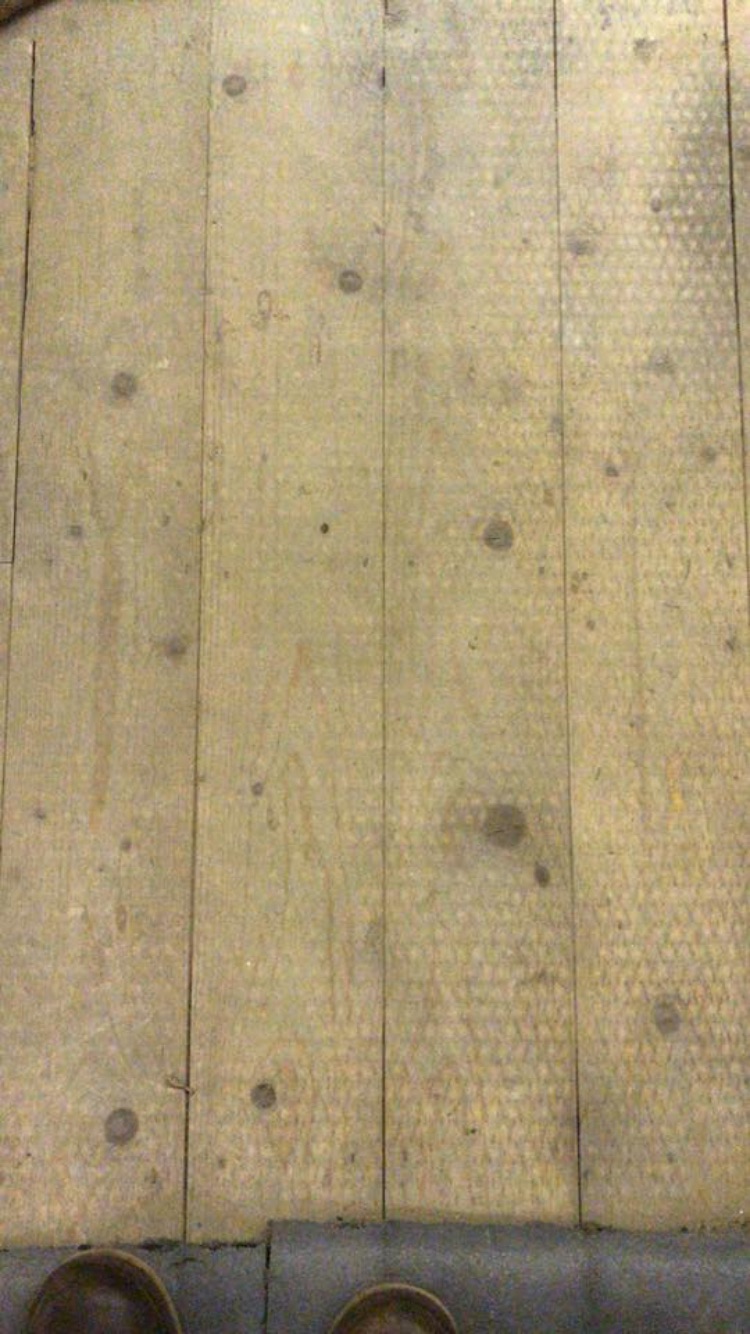

The 1930s ones are like this photo - is this just a standard pine floor?
