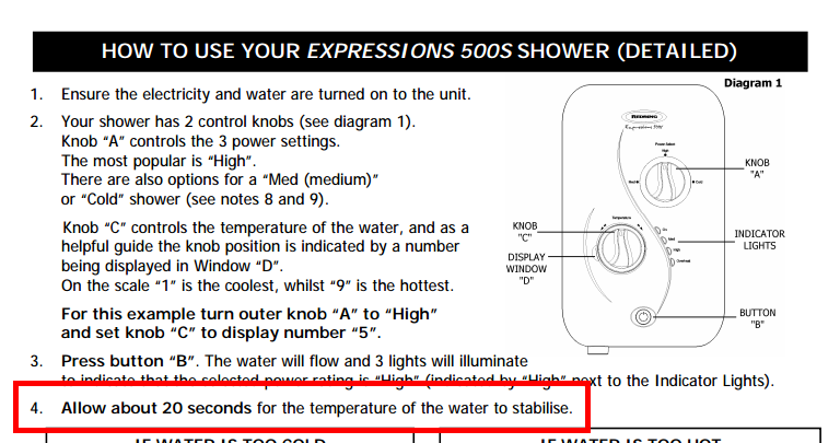

We moved into this property in 2014 and in doing so, inherited a Redring Expressions 500s 8.5kw electric shower.
We were told by the vendors that the shower was 2 years old when they sold the house, so it would be around five years old as of now. Its been fine, or as fine as electric showers go, given the limitations of the flow. Until recently, that is, when the length of time between turning the shower on, the flow reducing and the temperature stabilising went from just a handful of seconds to about half a minute. (lest that not be clear, when you hit the On switch the shower comes on with the full force of mains pressure, remains cold for a short period then the flow reduces and the shower stabilises at the preset temperature.)
Once it's up and running, the temperature remains stable and the shower is fine, and the above problem is still intermittent. My issue is that being on a water meter we're wasting a lot of water waiting for the temperature to stabilise, and I wondered whether anyone knew whether an economical repair is feasible. If not, I'll probably replace the shower rather than continue wasting water unnecessarily.

OK - sounds like there are other reasons for changing it, although I do still wonder why you are so fixated on the beyond-price time factor of a short wait.
When you get a new shower, do not under any circumstances buy a Redring Selectronic. Normally I'd strongly recommend one - they do a 10.8kW model, and they are properly thermostatically controlled, so if the pressure suddenly drops, e.g. from someone flushing the toilet, rather than you just having crude anti-scald protection (in my experience you still need to jump out of the way, cursing), it keeps the temperature stable. But when first turned on you do have to wait 15-20s for it to stabilise at whatever temperature it was set to.

If we had a shower which had been designed in the factory to stabilise after, say 15-20 seconds, it wouldn't have been a problem. This one used to stabilise within a handful of seconds but no longer does that. To me that indicates a fault, so its time to change.
I've bought a Triton Easy Fit, which has good reviews, a 2 year warranty, and like the current shower is a basic model. Basic is all we need. If I had the money to buy a shower that cost as much as a second hand car, I'd spend it on...a second hand car. But thanks for the links anyhow.
