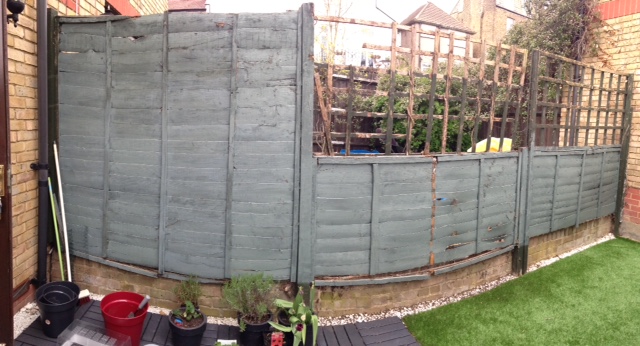

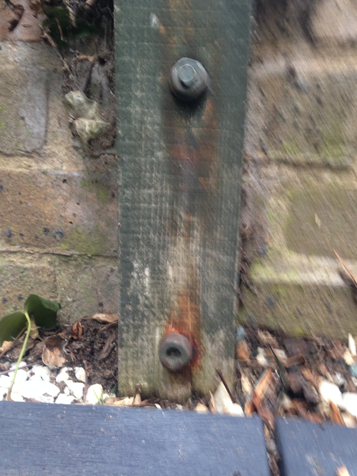

I have a short 3 panel fence which needs replacing. It's fixed at either end to full height brick, with two wooden posts fixed to the neighbouring (low brick) wall in the middle. Only one of the middle posts needs replacing and I planned to pull it off the fixings (it's bolted to the wall with two bolts), and replace with a new post by just slotting it on to the old fixings and tightening the bolts again...
However, when I removed the post, only the top bolt is still sound; Can I still slot the new post onto the good screw and bolt and use some other sort of fixing to keep it sturdy at the bottom? Or can I use a wall bracket of some sort? Was planning to replace with 6ft panels.... any suggestions very welcome, attached pic might make more sense! Thanks in advance for your help!

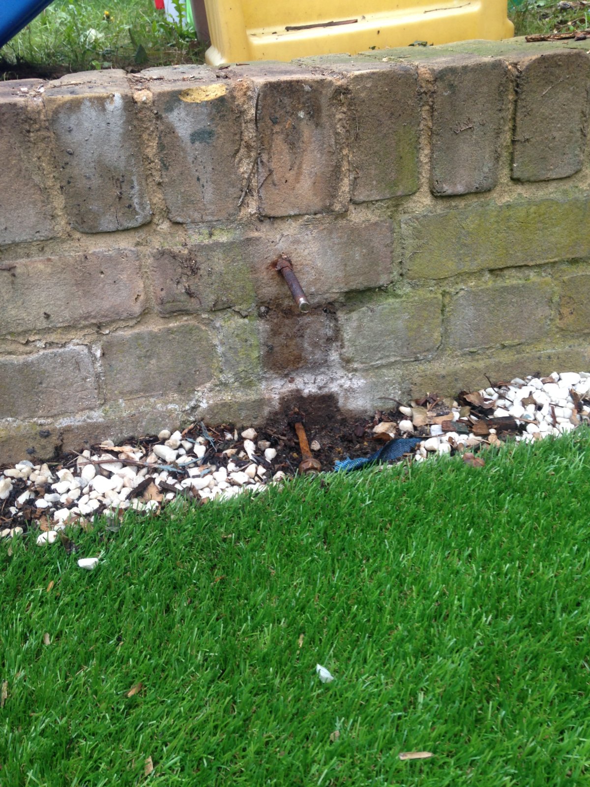

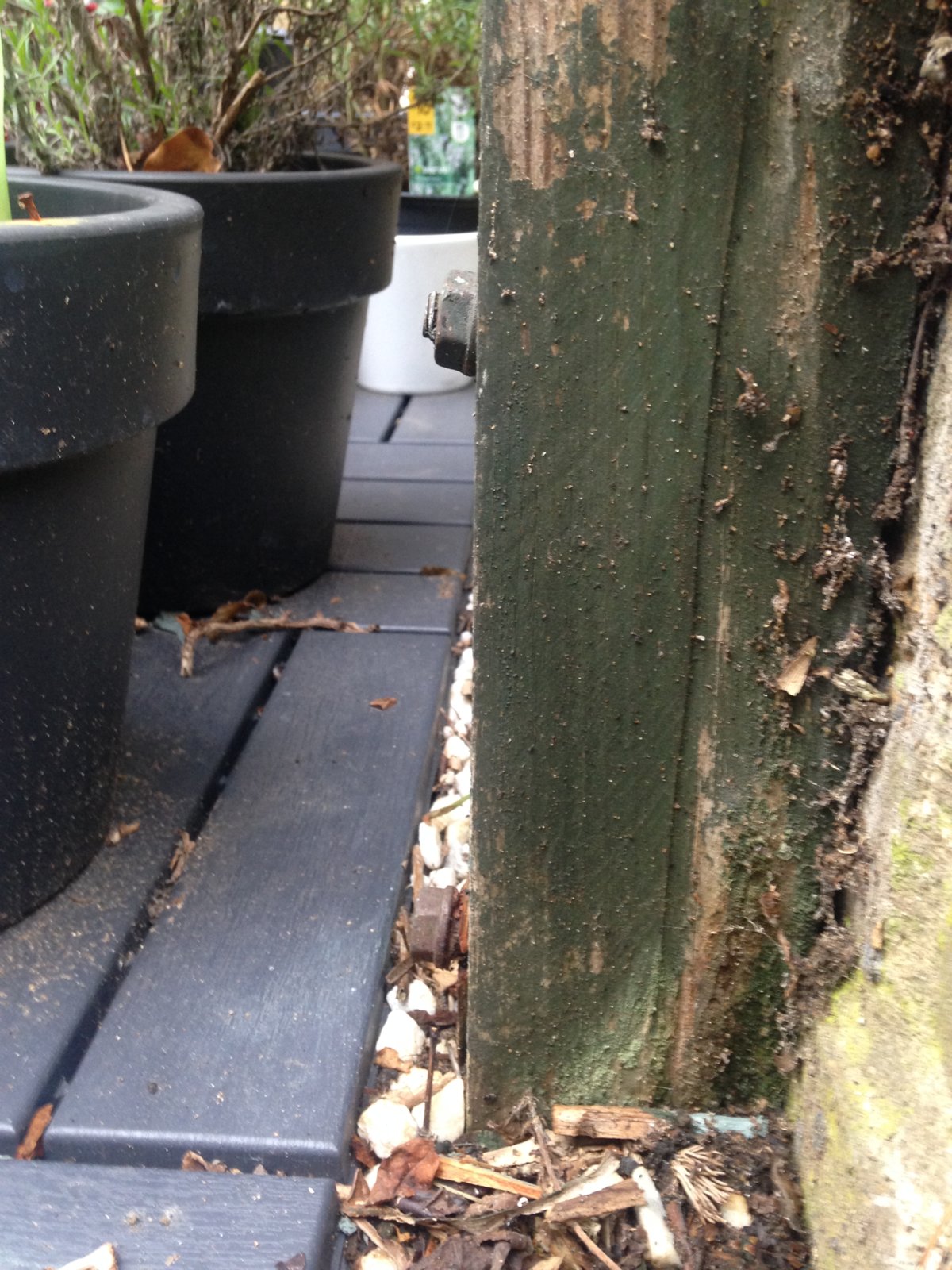

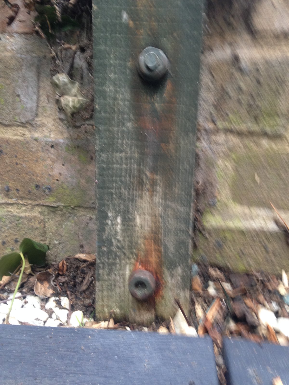

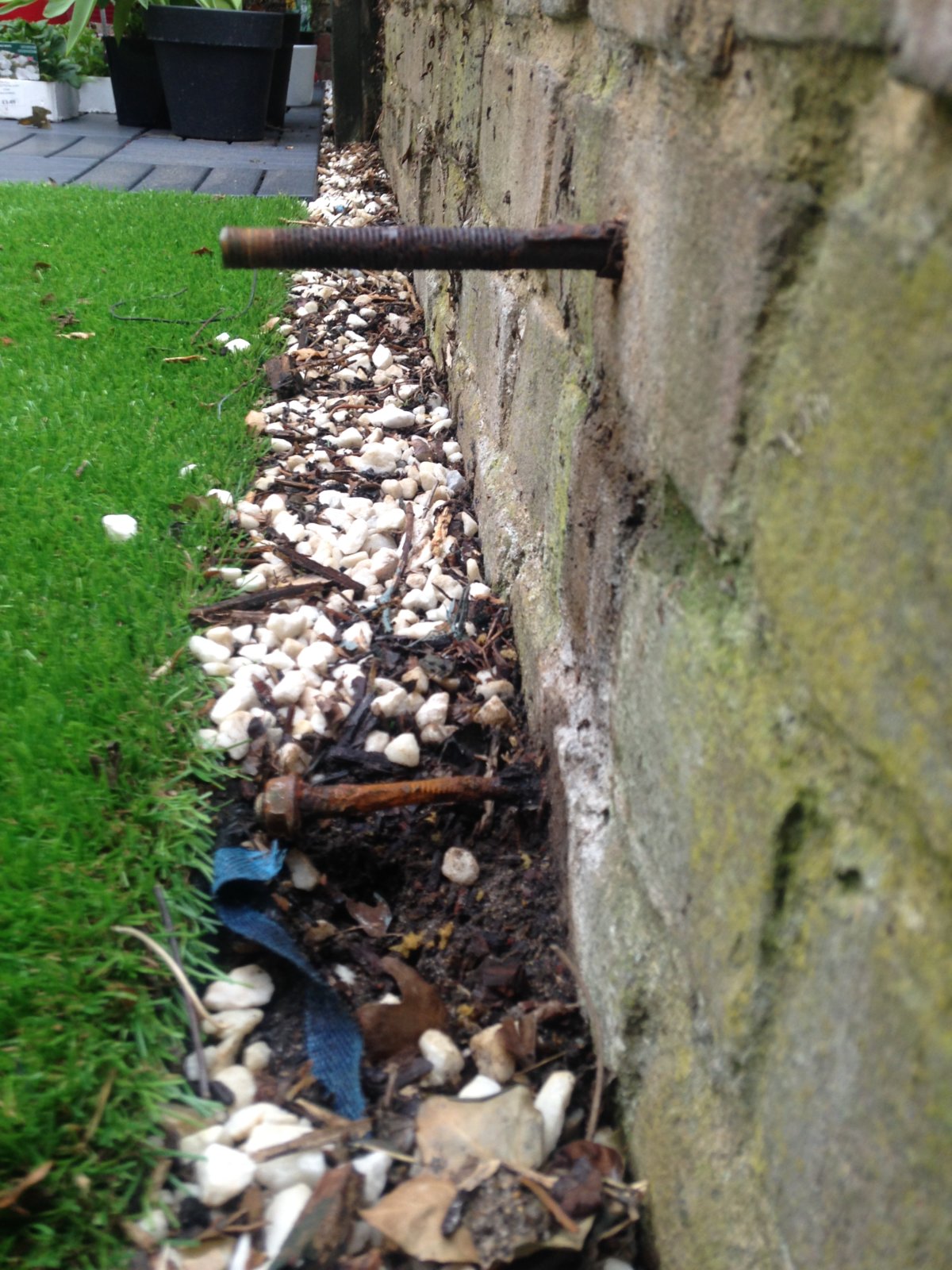

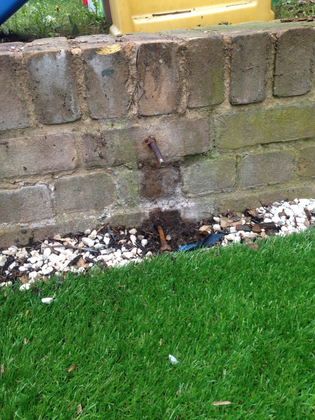

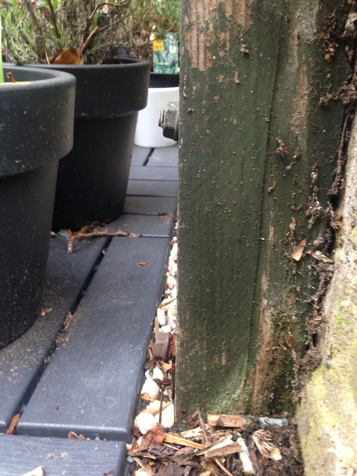

Some pics of the wall fixings attached, and a picture showing the fixings on the post that is sound. The top screw seems fine but the other is wrecked. Am I right in thinking that I can drill a second hole above the ruined screw and add a new second fixing but keep the top one? Can I just use thunderbolts? Thanks!

Thanks for the pics!
Indeed you can use a new fixing above the old broken one, and the centre of the brick is the place to be.
You should be able to use thunderbolts of you want, personally I prefer Fischer frame fixings...10mm in diameter which can be tightened by a spanner rather than a screwdriver. For these you need a 10mm wood bit for the post and a 10mm masonry bit - together with a SDS drill of course.
John :)
Great - thanks so much for your reply - if I'm drilling into the brick, should I drill a smaller pilot hole or just go for it with a 10mm bit?
For sure, drilling a pilot hole - say 6mm - won't do any harm!
I'd position the post in place, and get it completely vertical - and then drill through the timber. The drill will mark the brick and show you where to start.
Choose a thunderbolt which will get a nice deep fixing in the brick.
