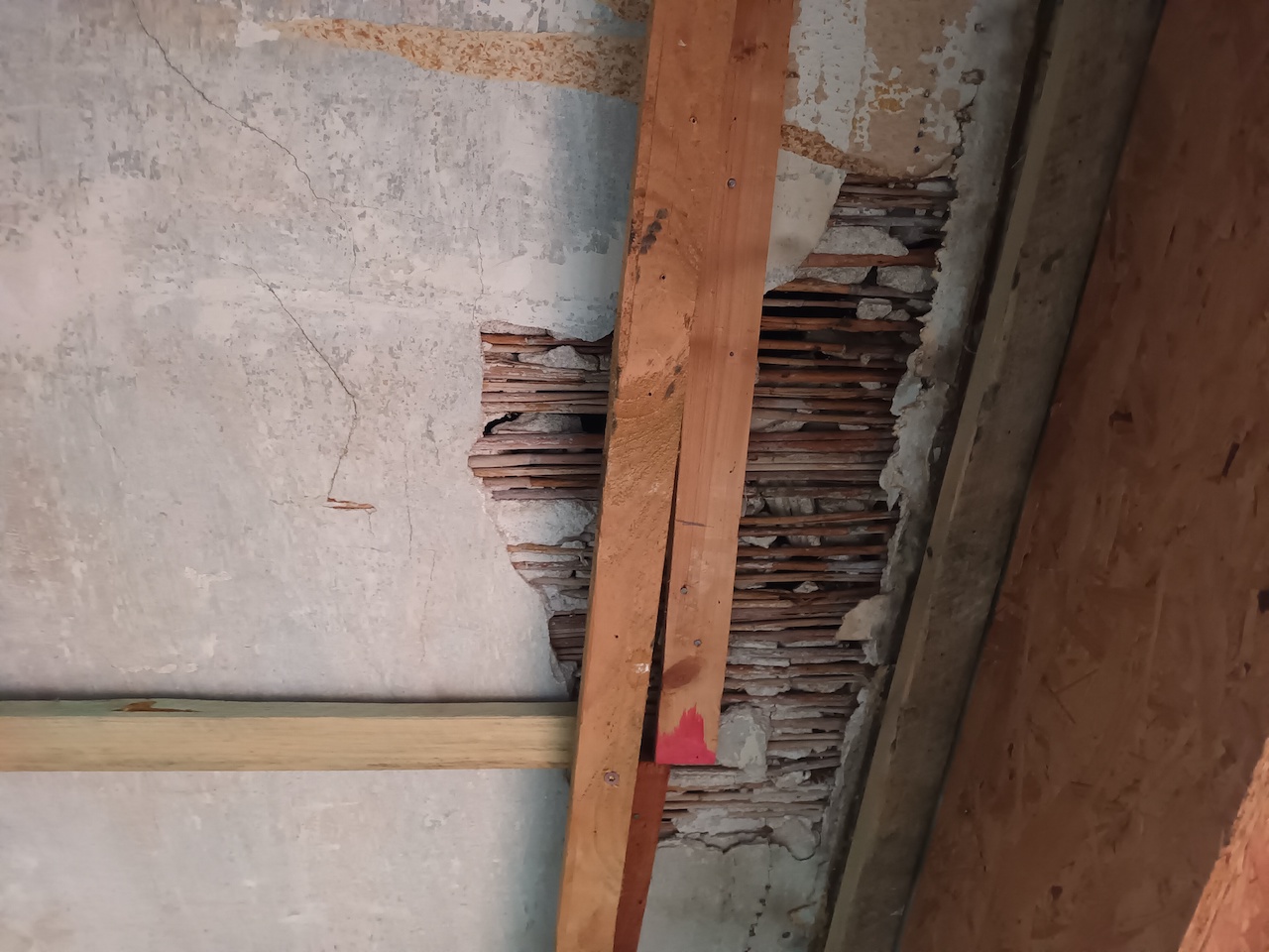

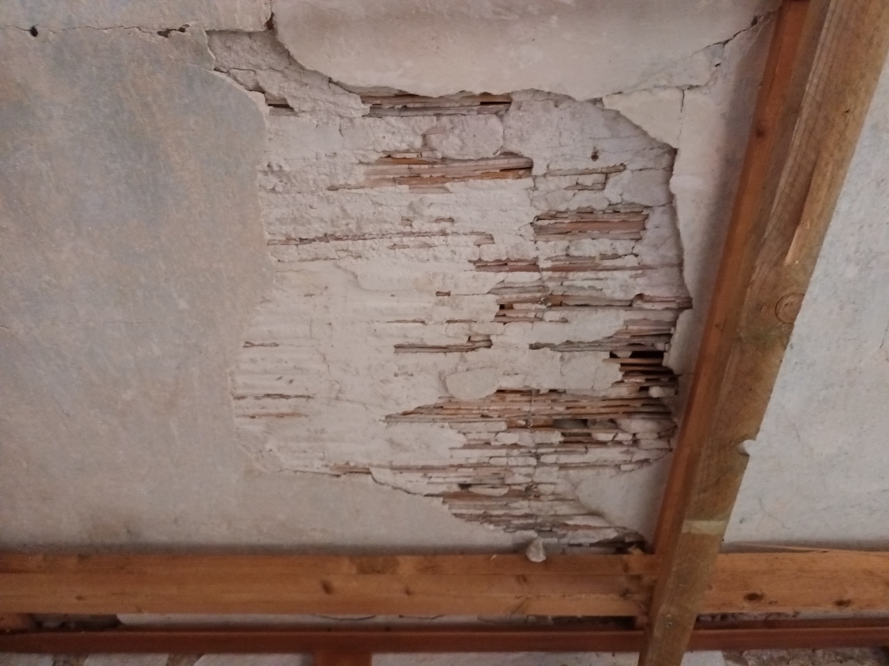

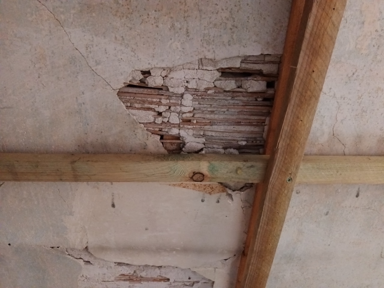

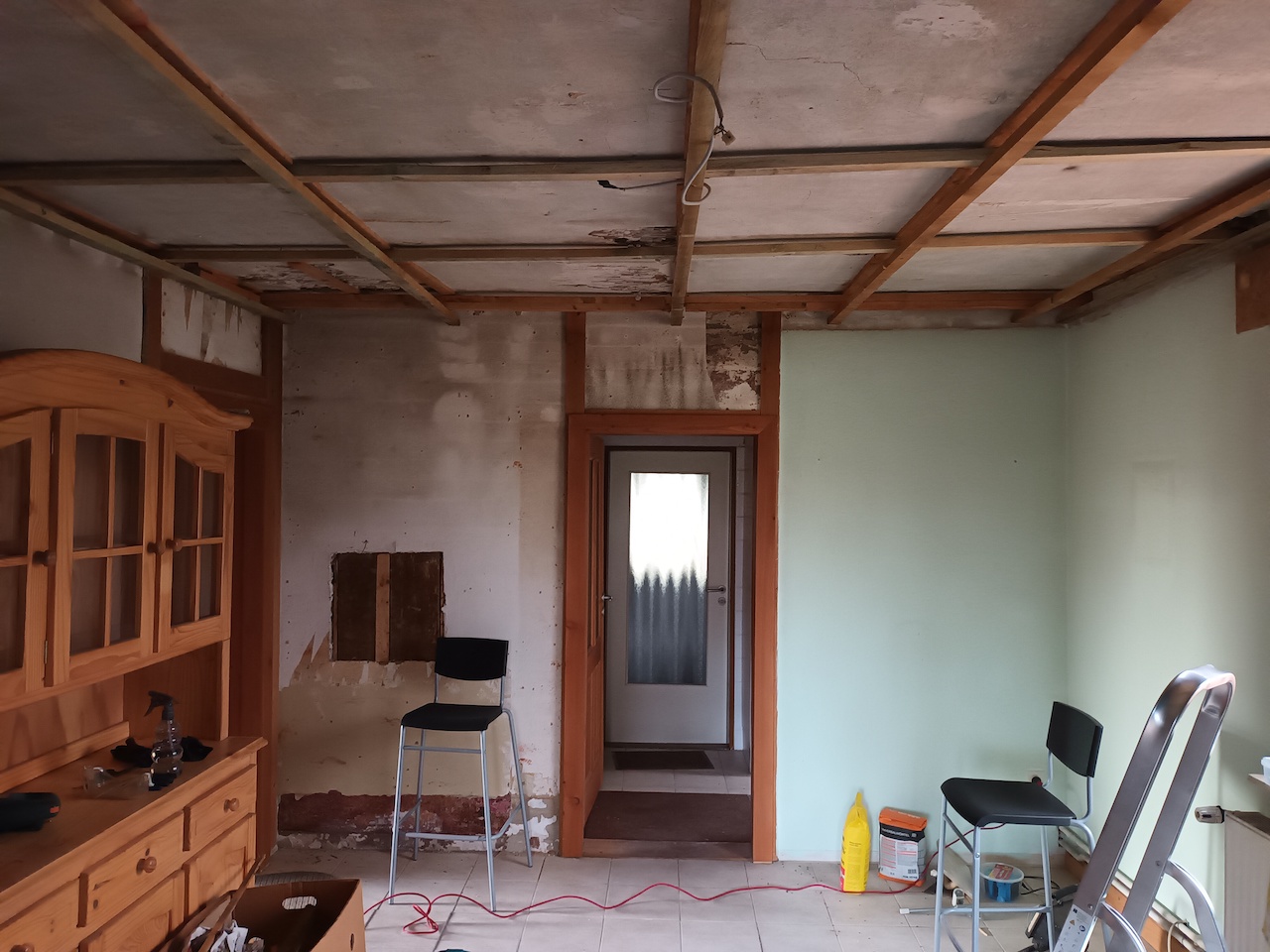

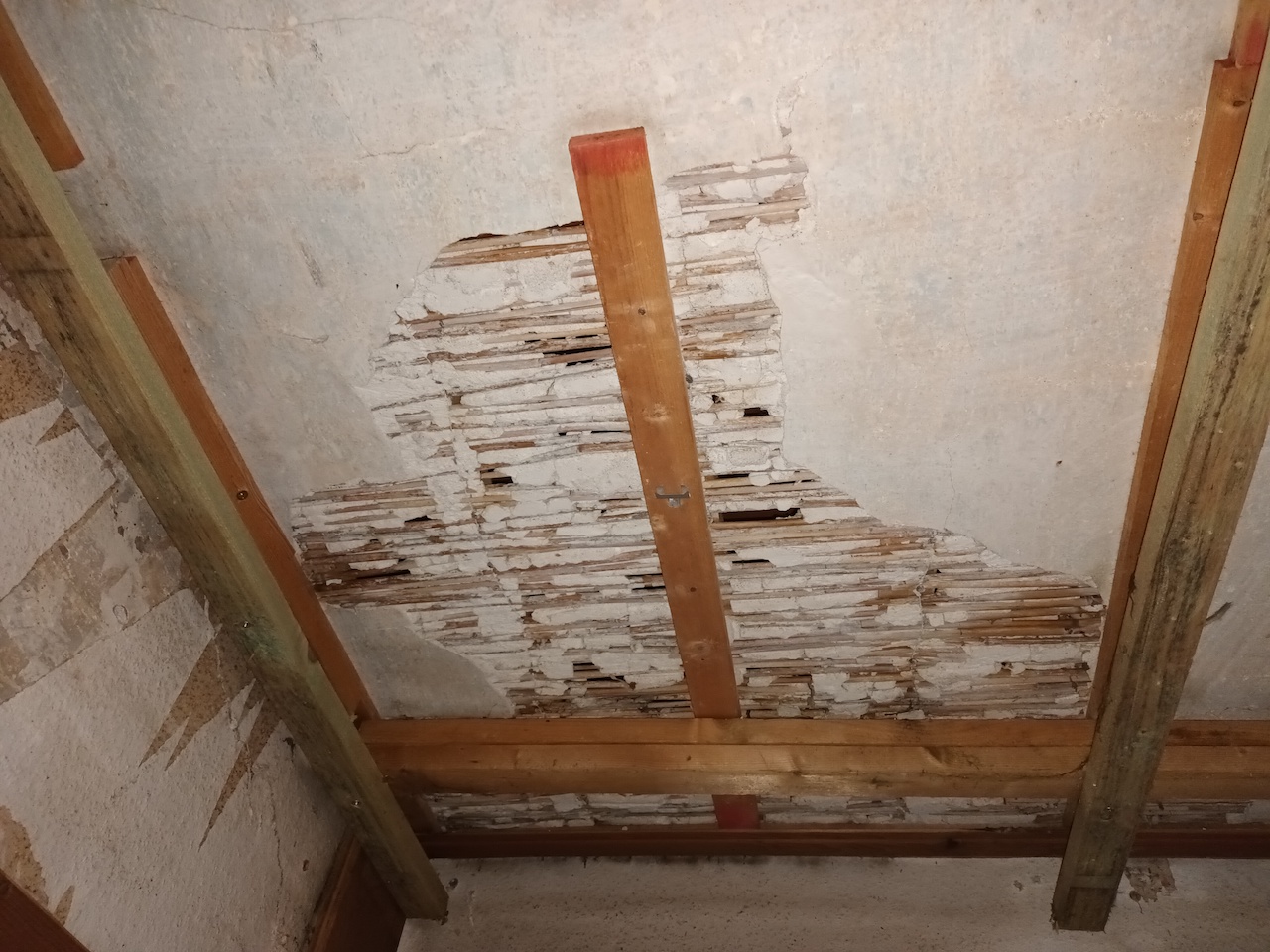

We recently bought a house, currently unoccupied, and we just removed the wooden ceiling in one room to reveal a layer of insulation, and under that a damaged lath and plaster ceiling:
There are quite a few spots where the ceiling is damaged. I assume the damage occured before they put up the wooden ceiling because there were no signs of broken plaster when we took down the wood and insulation.
I'm not sure what the potential options available to us are. Perhaps:
1. Remove battens, repair damaged areas
2. Remove battens and replaster the entire ceiling
3. Remove battens, cover with plasterboard/wood
4. Leave the battens and put up a new dropped ceiling using plasterboards/wood
We don't need the layer of insulation in this room if that helps with any advice.

1. looks like a none-starter option. If you attempt to repair it will be unending, that's why it was covered up.
2 or 3, 4 are potential options, but depending upon how you want the finished ceiling to look once done.
I'm a 3
Plastic down taped to edges.
Tarps over.
Take the lot down Inc wooden laths.
Treat timber with primer preserver (optional)
Sort cables ect
Put in timber to support new centre light if required.
Maybe look at fitting cross timbers if needed to brace joists.
Look at level. Level ceiling if required.
Hire board lifter.
15mm plasterboard. Fitted tight to walls.

Should have mentioned it's currently unoccupied, so if any time to make a mess, it's now.
In the long term this room will likely be a kitchen, so having a false ceiling for spot lights and potentially the exhaust from the cooker will run from the inside to the outside wall

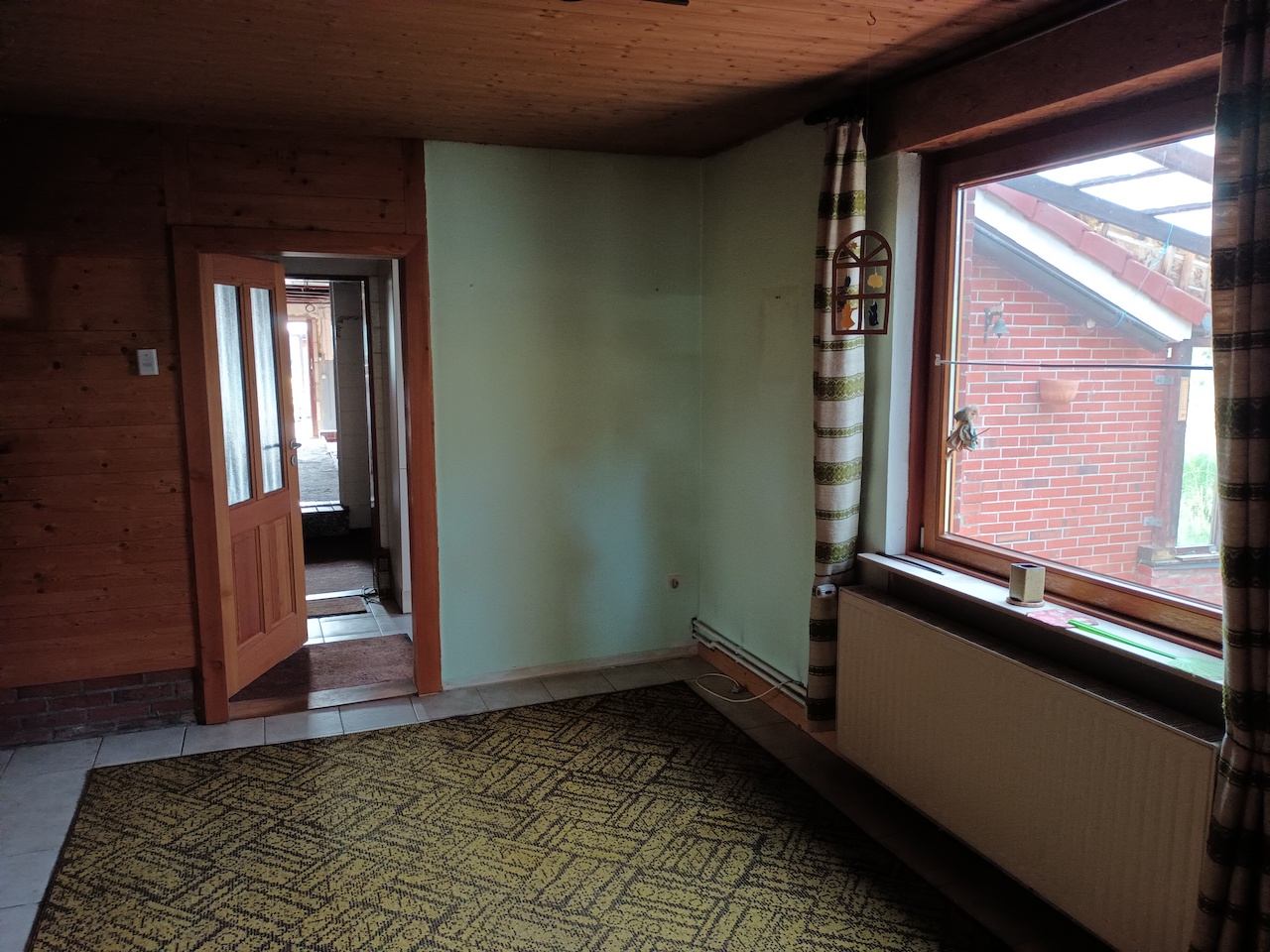

The insulation might have been more for noise than heat, the original lath & plaster (being quite heavy) will also reduce noise transmission.
Dropping the old ceiling would allow you to check the joists for worm etc but that's about the only advantage- I'd go with your option 4, mebbe chuck a vcl in while you're at it
There is a wood burning stove in the room so I think it was too keep the room extra cozy and warm.
