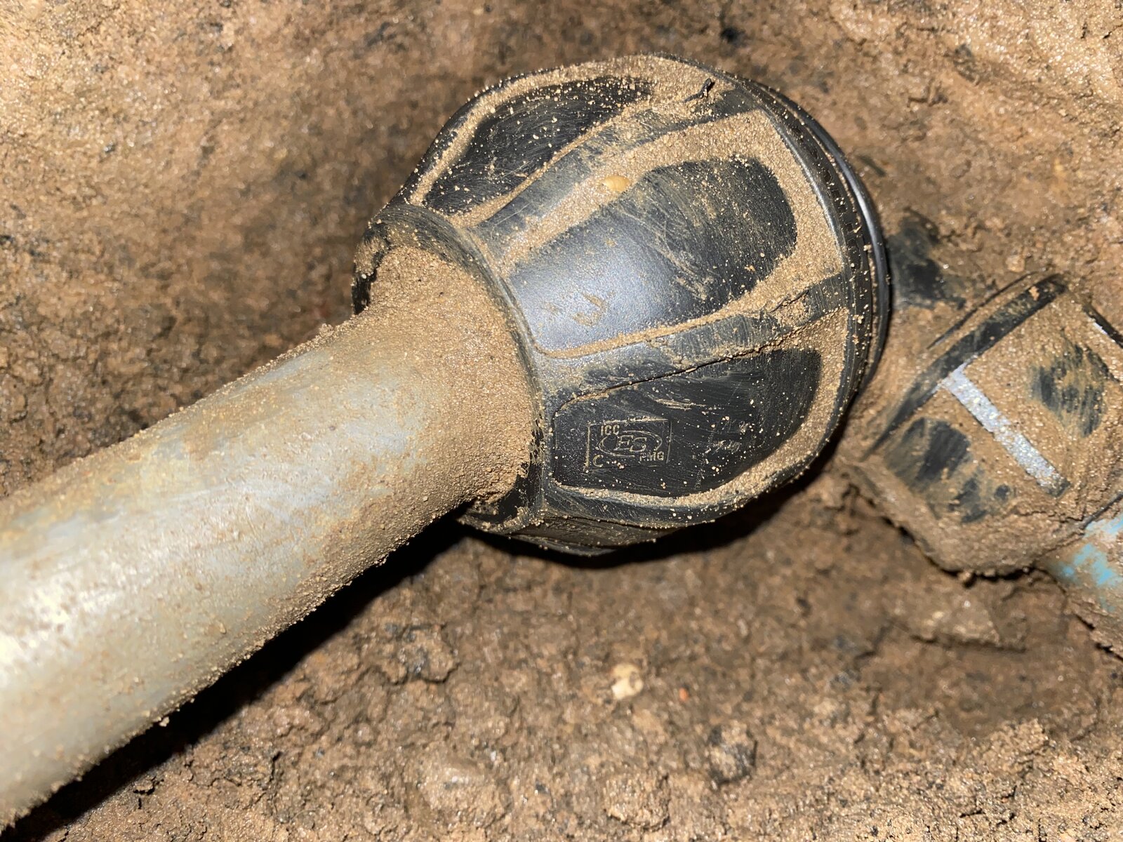

I might have slightly taken an underground peek beyond my boundary by a few inches, and revealed what I’m sure is a philmac lead to plastic transition elbow. Quandary I’m in, is do I cut the lead just within my boundary and convert to plastic, meaning I still have about 6” of lead pipe in the system, or do I undo this elbow on the lead side and replace it with the nut of another newly bought fitting of the same type and shove my new mdpe in? I know I’m on dodgy ground but i know what I’m tempted to do. Anyone got any thoughts? These fittings tend to be hand tight rather than using grips don’t they? Cheers

Actually, looking at the spec for these fittings, I think I’d need to replace the whole elbow in order to use my 25mm mdpe, so I think I’ll just cut and join to the lead on my boundary line. Bit of a pain as I doubt they’ll ever replace that bit but guess it doesn’t really matter.
I think I can use a small length of 32mm MDPE, and swap the lead in the picture for it, and keep the same fitting (will buy a new identical fitting with a new seal, nut etc). From reading the philmac tech details, it looks like it's fine to use MDPE on the UTC end of the fitting. I'll make room to get a wrench in to nip it up. I'll then reduce the 32mm to 25mm on my side. If anyone can confirm how much of a silly idea this is that'd be great ;)
If you can turn off the supply at the Stoptap in the Pavement, then I'd swap out that elbow and carry on as you were, as long as you're happy with what you're doing.

All done, and after a brief scare when I turned it back on and the water p1ssed out of the fitting I nipped it up more and all seems good. Will continue to keep an eye then back fill it. Thanks, that was not an enjoyable one.
