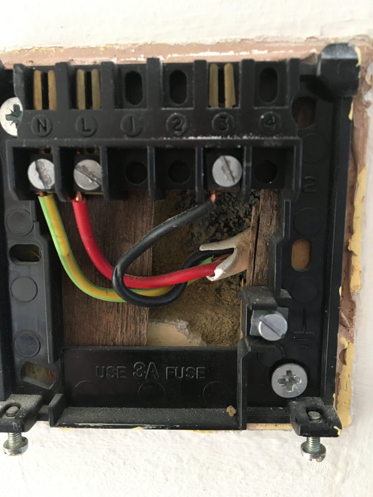

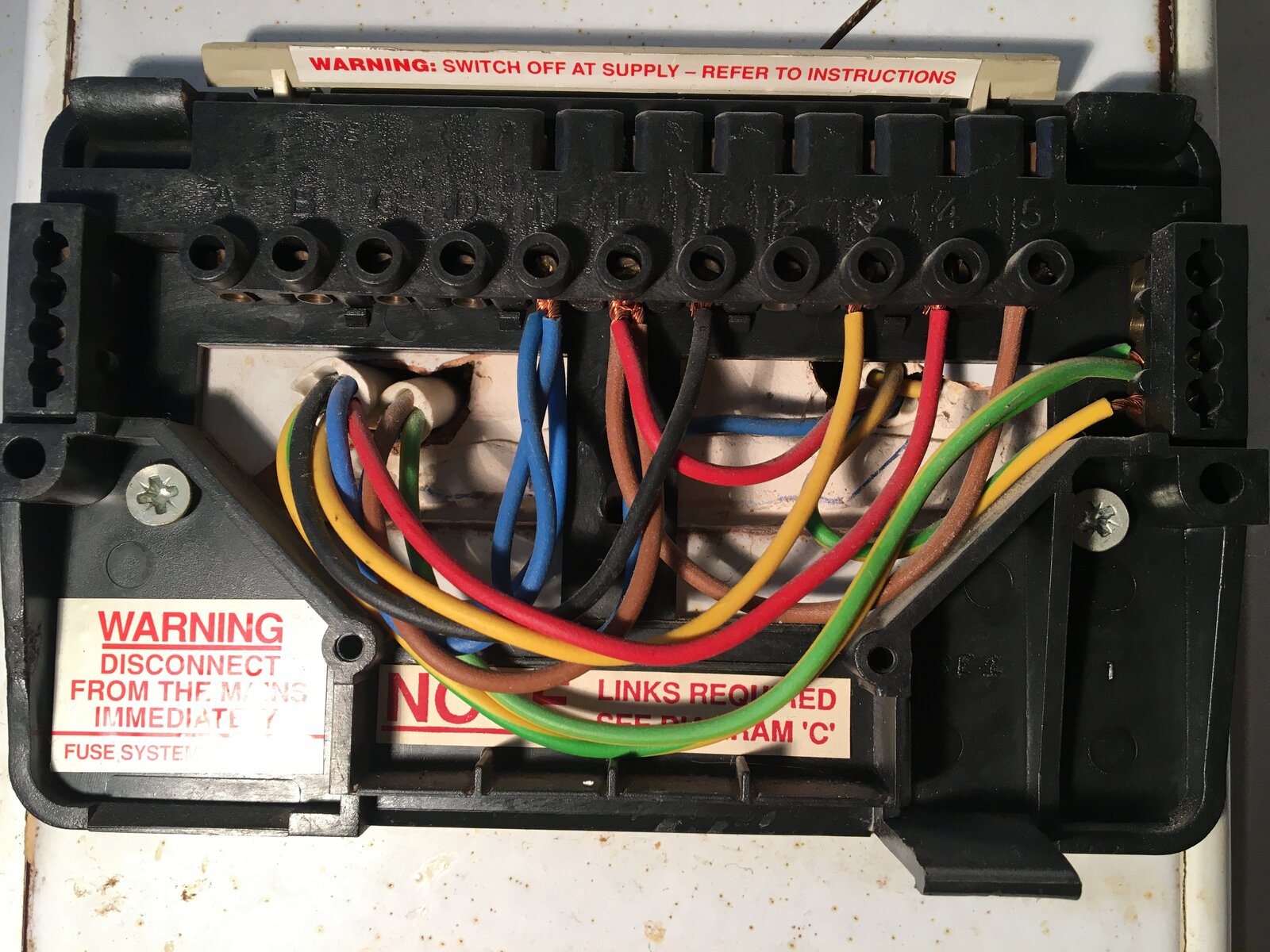

Can anyone help me, I want to replace my faulty Potterton EP2002 with the Hive active heating package (receiver, thermostat & hub). Can anyone please confirm or advise me before I start that I've got this right.
The terminals in the EP2002 are a like for like swap with the Hive receiver, ie: N/N, L/L, 1/1, 3/3, 4/4. Terminal 2 is not being used and also to disconnect the link between L & 5 in the EP2002, please see pics below.

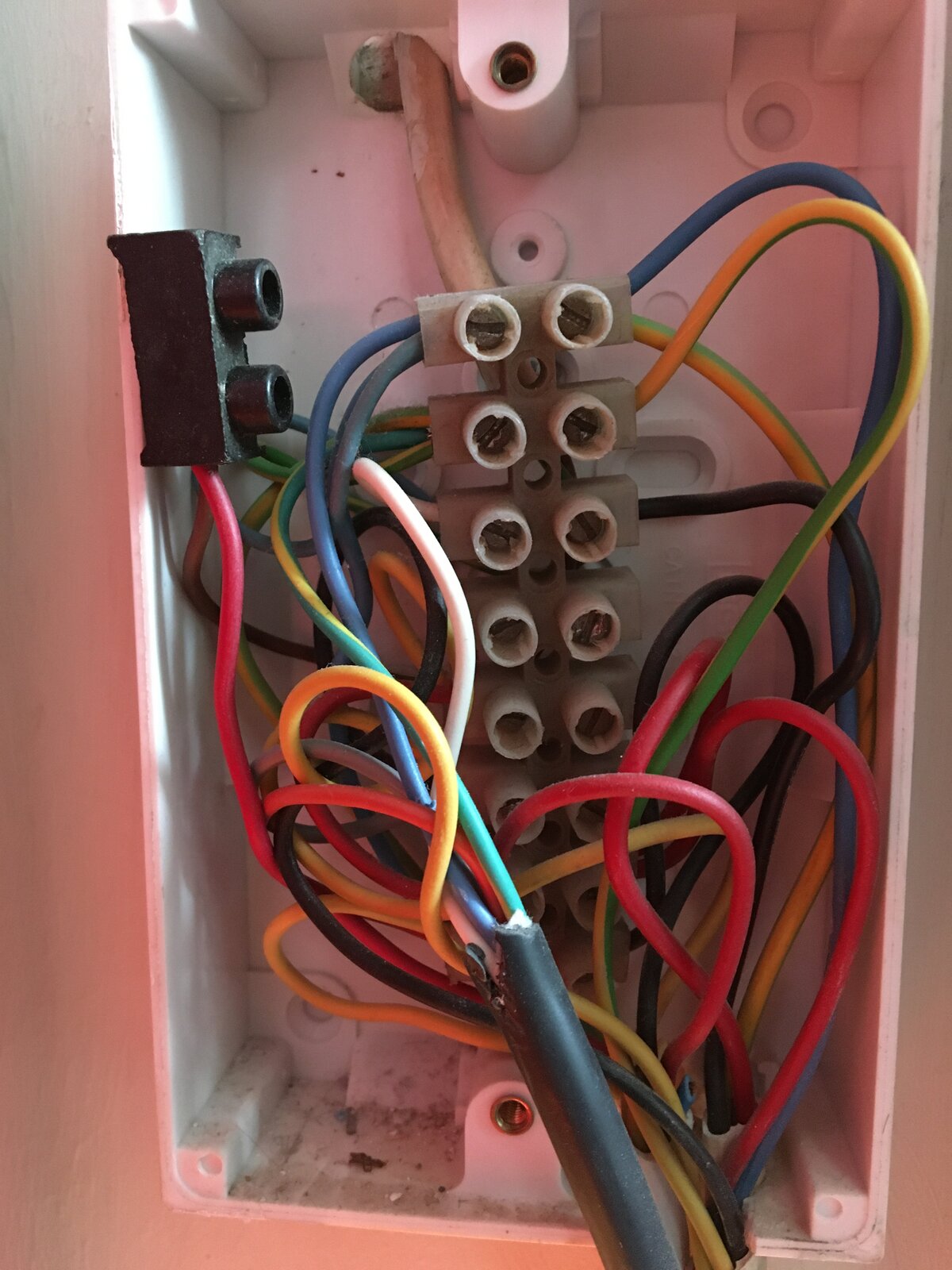

Also that I must disconnect the room stat from the wiring but join together the room stat live with the room stat switch line in the junction box which is located in my airing cupboard. I am not sure what to do with the two cables that are now left, the white cable which goes to 3way motorised valve & the red cable which goes to EP2002 or soon to be fitted Hive receiver terminal 4).
Any advise would be much appreciated. For extra information the boiler is a Worcester Greenstar 24Ri.
I also noted that the person who originally wired the room stat used the bare copper wire in the T&E for a neutral and put earth sleeving on it just to confuse everybody.

I think ive just had a senior moment. Connecting together the room stat live & switch line does nothing so i think it must be the white & the red cables that join together? I really do need help.
You have pretty much worked it out. Terminals N, L, 1, 3, 4, are a straight swap from EP2002 to Hive (Dual channel version). Terminal 5 of the EP2002 is a link that the Hive already has made internally so doesn't need this connection, and terminal 2 won't be used, as it's not used now. The wires in the EP earth terminal need to go to the Hive earth tether to maintain continuity.
The existing room thermostat needs to be taken out of service by linking its live (L) and switched live (SL) wires together to prevent it interfering with the operation of the Hive and to complete the circuit. You don't give the make or model, but looking at your photo below, that would be terminals L and 3. There should be a diagram on it somewhere that will confirm. Very bad that the earth wire has been used as for neutral!
By far the best way to decommission the room thermostat (and get rid of the dodgy N) is to trace the cable from the thermostat back to its origin (probably the at the wiring centre) and note where the L and SL are connected. Then disconnect and remove the entire thermostat cable and insert a link to join together the two terminals that the L and SL have just been removed from.
Alternatively, if you don't mind leaving the thermostat in place, put both the thermostat L and SL wires in the L terminal.
Or, simply leave the original thermostat in place and put it on its maximum setting. This is not ideal in case someone inadvertently adjusts it, and if it's battery operated (don't think yours is though) you will need to maintain the batteries.
No need to change anything else or access the boiler terminals.
