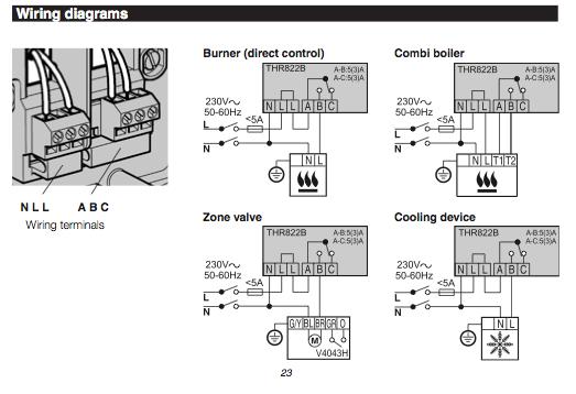

Can anyone help? I have a Randall 4033 timer which is now broken (clock not moving). Can I replace it with a homexpert THR872CUK? My thermostat isnt great either hence the need for a new thermostat too.

The homepert diagram just shows A B and C. Can anyone tell me what goes where or is there no direct replacement?
Thanks :D
The Randall is a programmer to control hw and ch. The Homexpert is just a wireless stat that controls only ch. You need to give more details about your current setup, eg. boiler, motorised valves, if you have a hw cylinder, etc.
If you need a 2 channel programmer to control hw and ch timings, plus a room stat, I would consider the Drayton Mitime T720R. It is a programmer as well as having a wireless RF room stat.
Thanks - thought as much. I have a boiler and hot water cylinder tank. No thermostatic valves, motorised valves on the boiler set up.
