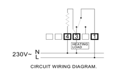

Hi there, I would like to replace an old Myson room thermostat with a newer Honeywell DT135
Old Myson Wiring....
so there are three wires
1. Brown ... Live?
2. Black with brown tape
3. Light grey with blue tape
3. Unused earth
The new thermostat only needs 2 wires from what i'm reading, i obviously need live (brown) , what do i do re the other wires please ?
picture taken from another site of the new thermostat inside as mine has not arrived yet
if someone could kindly give me a steer it would be appreciated ..thanks
The old thermostat likely has a compensation resistor to reduce the difference between on and off temperatures, but they would work without it, so likely the blue is neutral.
With electronic thermostats they often have batteries and don't need the neutral.
However thermostats can be low voltage or extra low voltage, and analogue or digital, analogue is best, some thing like OpenTherm but digital (simple on/off) can be still used, in the main room temperature is controlled by the TRV (thermostatic radiator valve) and the wall thermostat is only there to turn off system in warm weather.
In the main there is some legend some where to show what is what, I see nothing on either picture, I can guess on that the wires are, but better to be sure.
It's a bit tricky to be sure when you don't give us the Myson model, or show where the wires go. I suspect that it could be a MRT1. If it is, it will be wired as below and this diagram should be printed inside the lid.
If, and only if, it is a MRT1 then the wires you are interested in for your new thermostat will be those now in terminal 1 [Live] and terminal 3 [Switched Live] which you will find probably correspond to the brown wire and the black wire with brown tape. If so, the wires presently in 1 and 3 will go to the top two terminals of the DT135 marked as below, it's only a switch so it doesn't matter which way around they go.
The Honeywell DT135 is battery powered so doesn't need a neutral so that should be isolated / insulated and tucked safely out of the way. It is also double insulated so doesn't need an earth connection so that too should also be isolated / insulated and tucked safely out of the way.
If your thermostat is not a MRT1 or the wires don't correspond to the diagram above please don't proceed but post back further details and someone will be able to confirm.

Hi there
you are correct i've had a peek and it is the MRT1
ill focus on the cables that you have mentioned and really appreciate all the input thanks
