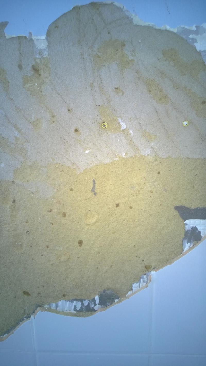

Just about to try my hand at tiling for the first time and have set about removing our very old bathroom tiles.
The result seems to be that, predictably, the tiles are pulling away the plaster with them exposing the rough wall which is made of what appears to be some sort of sandstone type material.
Clearly it's not smooth and you'd never paint over it but is it worth getting the wall plastered to provide a smooth surface for tiling or can the existing surface be bonded/prepared in some way to tile over?
It's rough as far as surfaces go, but not necessarily uneven.
Remove all the tile and any loose background.
Bring the rough cover to a plumb and flat surface with bonding or render, and it should be good enough to tile on.
Many thanks for the reply - have found some areas which are less hopeful so may need to resort to backing board for those.
Is the yellow stuff solid enough to fix to? If it is then you might be best to overboard with moisture resistant plasterboard and tile onto that.
If it's the foam in the middle of a plasterboard sandwich then not sure what you can do.
I dont understand where the reference to plaster board comes from - there's certainly none in the pic?
OP, there's no need for backer board - do as suggested above no matter the patches involved. Dont make work for yourself.
Pulling a wall out with BB might give you additional problems.
AdamCH is right, bonding isn't suitable for tiling onto, render takes donkeys to dry. If the voids are shallow enough, patch them with some floor adhesive, dries very quickly.
Bonding has very high suction. Can't work out what that yellow surface is - very unlikely to be the sandstone suggested by the OP. Difficult to know what will stick to it without knowing what it is.

"floor adhesive"? I hope that you are referring to cementitious bagged powder adhesive?
The OP has indicated that the area(s) of concern are backer board large. Are you recommending floating the wall(s) in "flooring adhesive"?
AAMOI: "moisture resistant plasterboard" is no more moisture resistant than regular plasterboard - almost zero resistant.
Hi ree. tile adhesive will stick to bonding, but all the products we sell state that they should not be used on bonding, its high suction and crumbles too easily and if you check with a manufacturer they will mostly say the same. Render is a great surface, but take days (sometimes weeks) to dry out - i dont mean visually, i mean properly - to get the backing of the manufacturers you can be talking about a week or more.
Yes floor adhesive meant a bagged powder adhesive, and i said for patching IF the areas are shallow enough.
Completely agree about MR plasterboard, it still needs to be tanked and backer board is always better.
