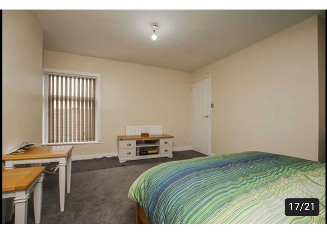

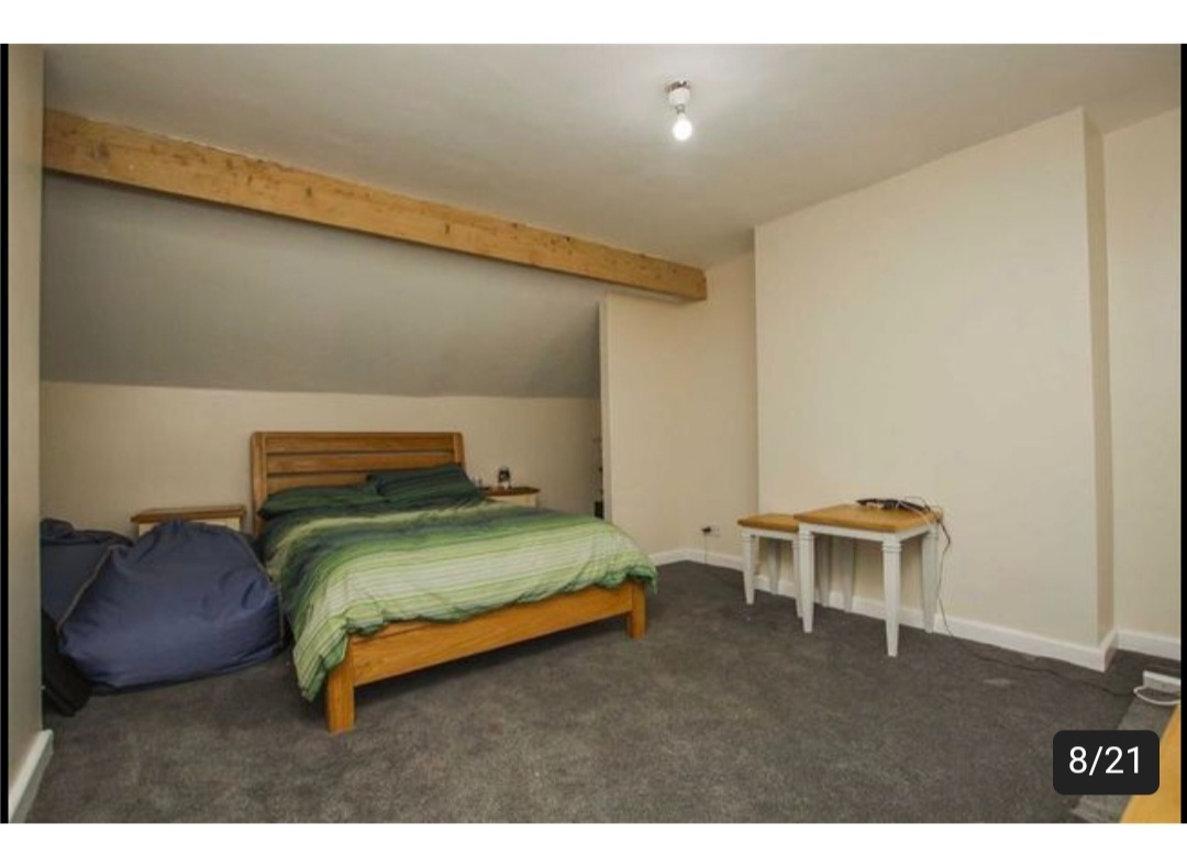

Means of escape, complete lack of structural design/suitable structure, lack of insulation, could be all sorts.

Unsure but looks like in 2002 it was sold as a 3 bed so must have been there then, we purchased in 2019, attached photos of the conversion its a dormer can't think why they said irs not compliant apart from maybe stairs are steep
