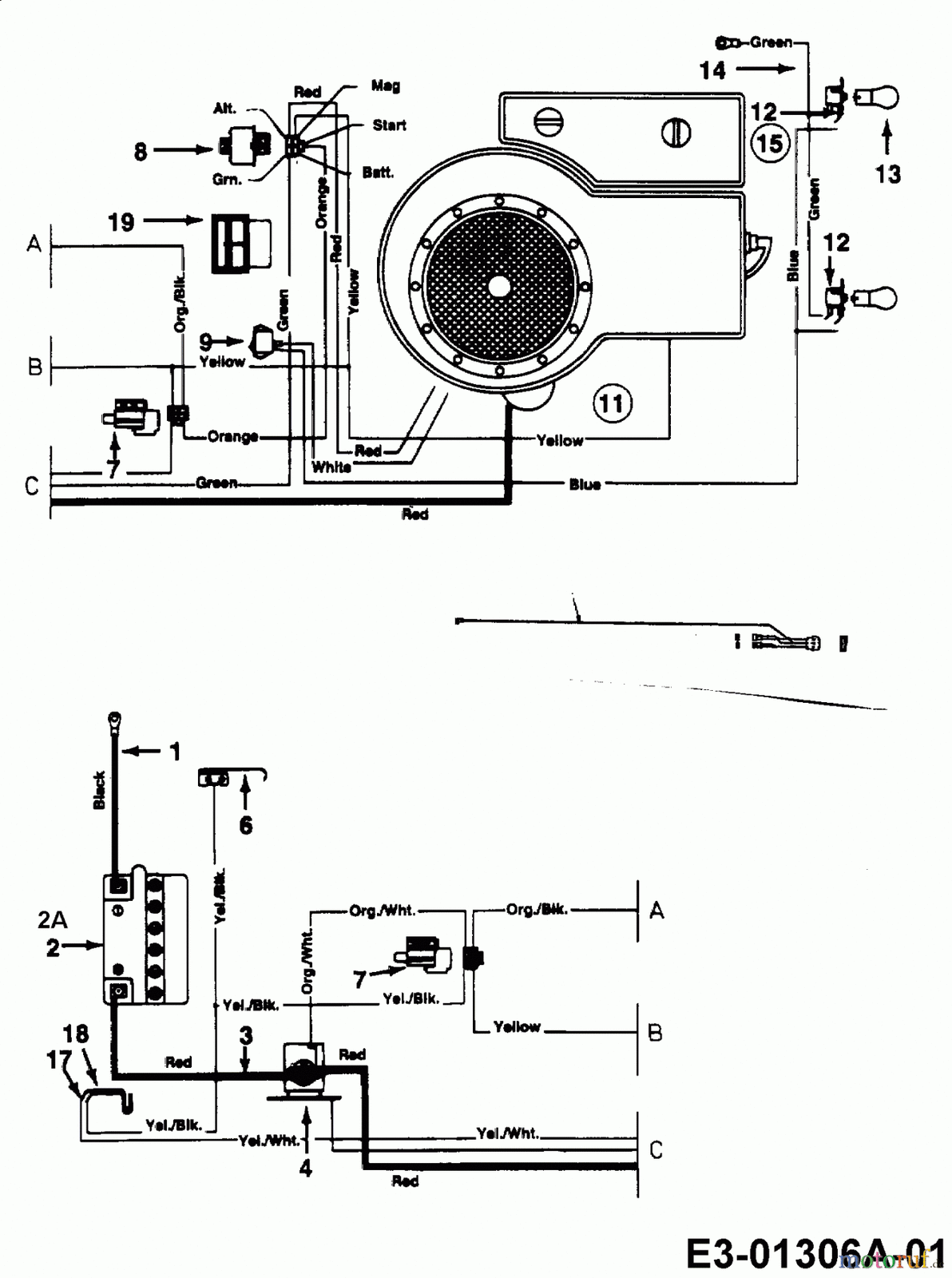

Hi.
I have a ride on mower with a Briggs and Stratton engine. With a fully charged battery and plenty of fuel when I try and start using the starter motor it turns over strongly but won't kick into life. After doing this I can then do one or two pulls manually and it starts.
Has anyone got an idea why this is? As said the engine turns over really well with starter motors but doesn't start.
How curious!
However, can you make sure the sparking plug is still sparking when you try the electric start? Best to look for a spark in the dark, or at least in the shade.
This is to ascertain the ignition switch is behaving, and not shorting the ignition coil out.
Best tell me which machine this is, and which Briggs engine, if you don’t mind.....the vast majority are magneto ignition rather than battery and coil.

I would make a guess at the ignition switch misbehaving, wrongly switching the ignition off when it tries to crank. They are also fitted with a range of engine stop interlocks, such as one for making sure the handbrake is applied and someone sitting in the seat, maybe one of those is preventing it starting, I have never come across one with a starter motor and a means to manually pull start it.

Thinking about it a bit more, you are correct, mine is the same - so I'm thinking it must be the ignition switch shorting the just the ignition. Ignition switch grounds the ignition to kill the engine.
The only other thing I can think of, is I wonder if it is fitted with an automatic 12v powered solenoid fuel shut off, like mine? If that is not opening when cranking, it wouldn't start.
I've attached the circuit for a typical B&S powered ride on..

Make sure mower is out of drive and blades disengaged, pull the switch wire off the solenoid , then with the ignition on touch a jumper wire between the solenoid switch terminal and battery live. If it starts , a faulty ignition switch is a good bet .
