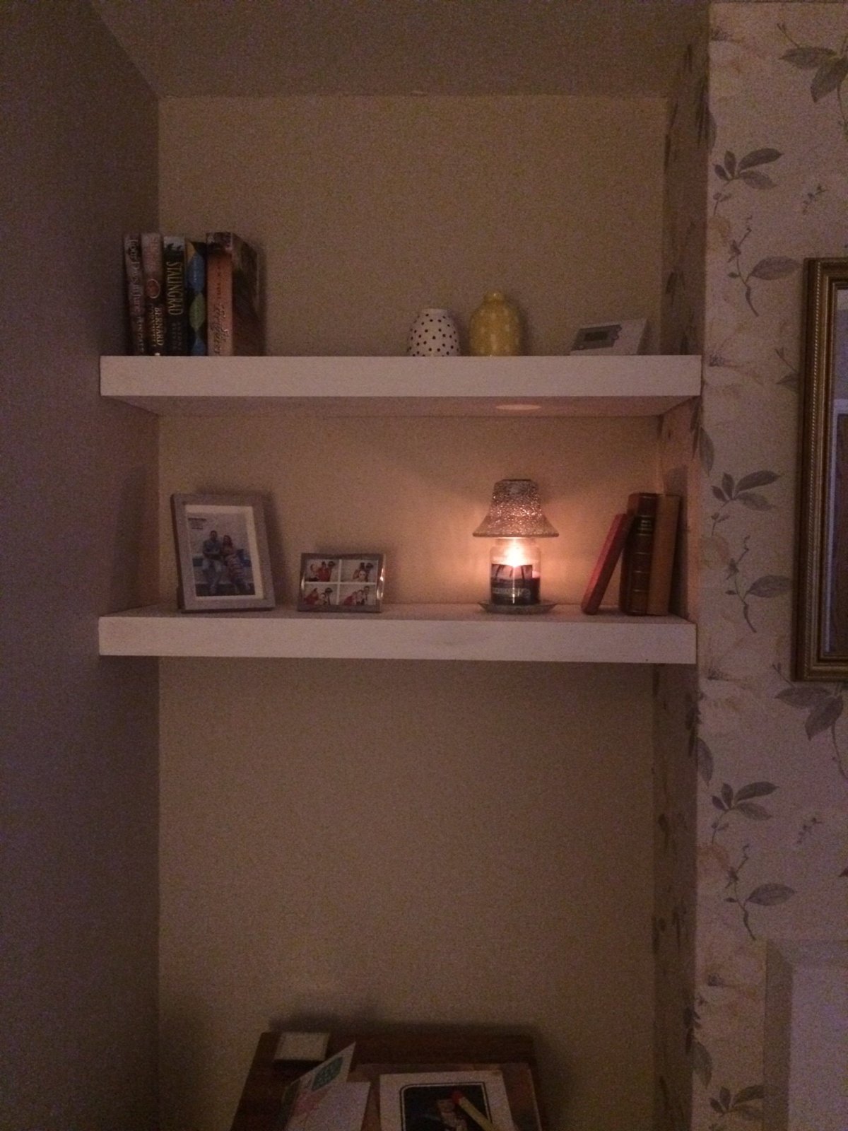

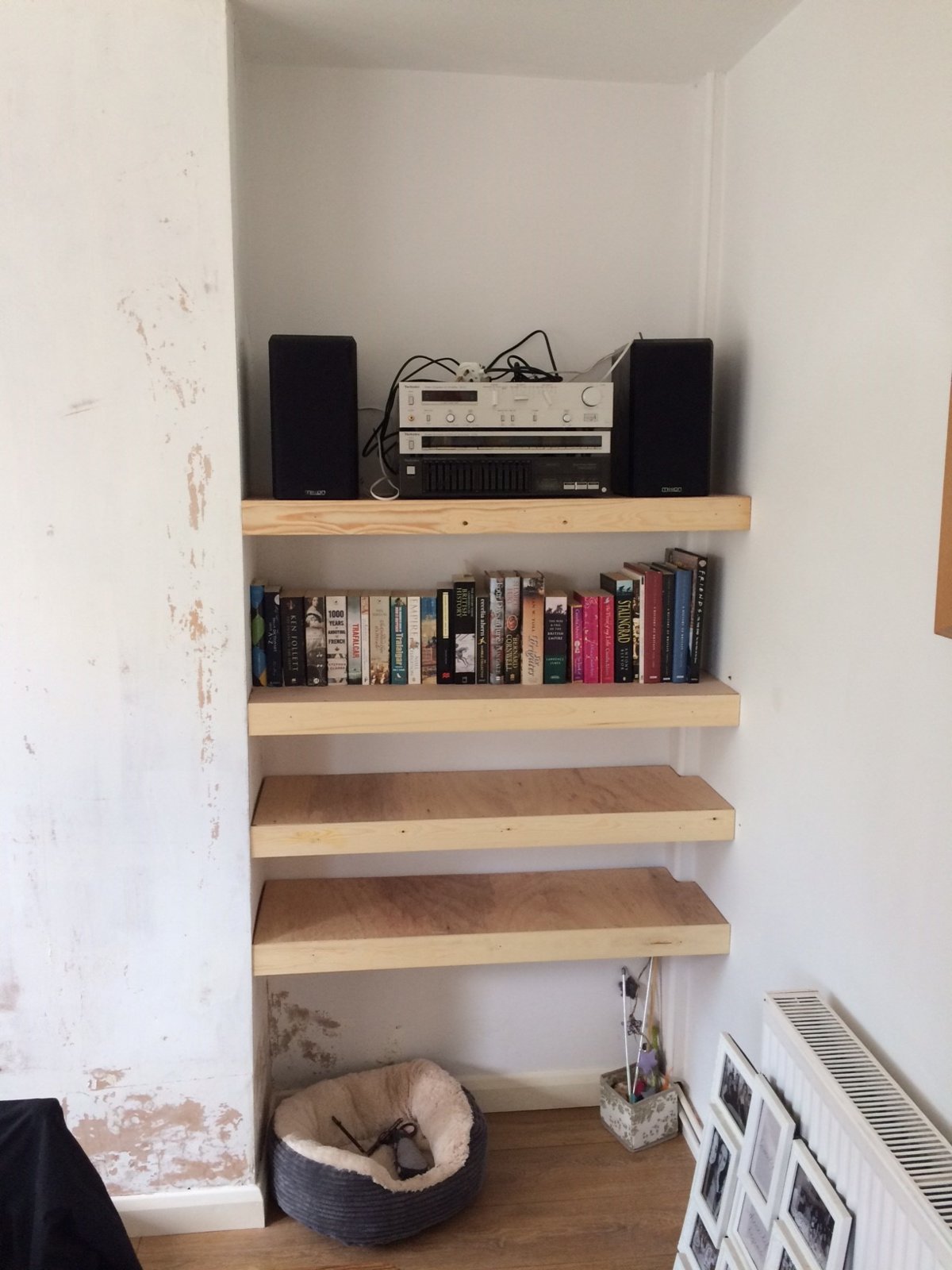

I did this recently in my house. I screwed battons the walls and chimney breast, fixed another batten along the front to make a frame. I then put 16mm MDF (ply would also work nicely) on top, 4mm ply on the bottom and a finishing strip along the front.
They then look like floating alcove shelves and can take a a good bit of weight. In fact, one of mine houses two speakers, an EQ, an amp. and a tuner.
I've attached some pictures of them - I haven't finished decorating so please ignore the mess!
