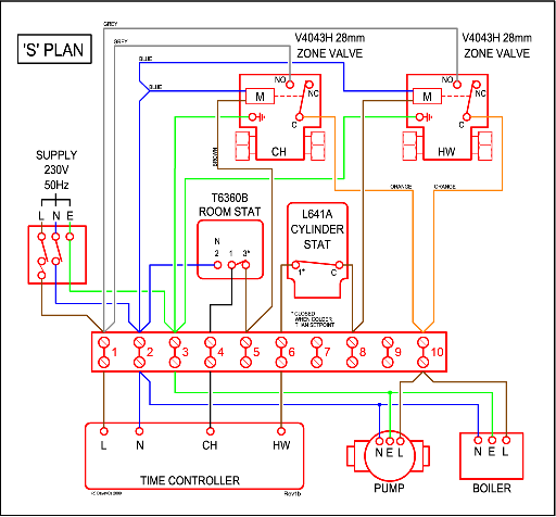

I know, I saw that the very second I posted, typical, its on the plumbing one now. Cheers mate, but while your on, how easy is it to air a room stat to a boiler and 2 2 port valves along with a cylinder stat?
Luke
Well it's just a case of following the S-Plan diagram, readily available on google, but use the coloured version not the BW one.
Make sure you have ample of the right cored cable, you'll want some 3, 4 and if you need to extend the zone valves, 5 core flex. You can also use 5 core down to the programmer. LNE + CH + HW.
If you understand how it works, it's really quite straightforward
You will need to use mains rated cables, as mains voltages are present. Also, it's not good practice to use green/yellow wires for any other purpose than earth.
The diagram below is one of the easiest S-Plan diagrams to follow. Note though, unlike the example below, some boilers need to have control of the pump so that it continues to run for a short period after the boiler has gone off. If that is the case with your boiler, there will be a set of terminals inside the boiler specifically for the pump, and it should be wired to them, rather than the orange wires from the motorised valve.
