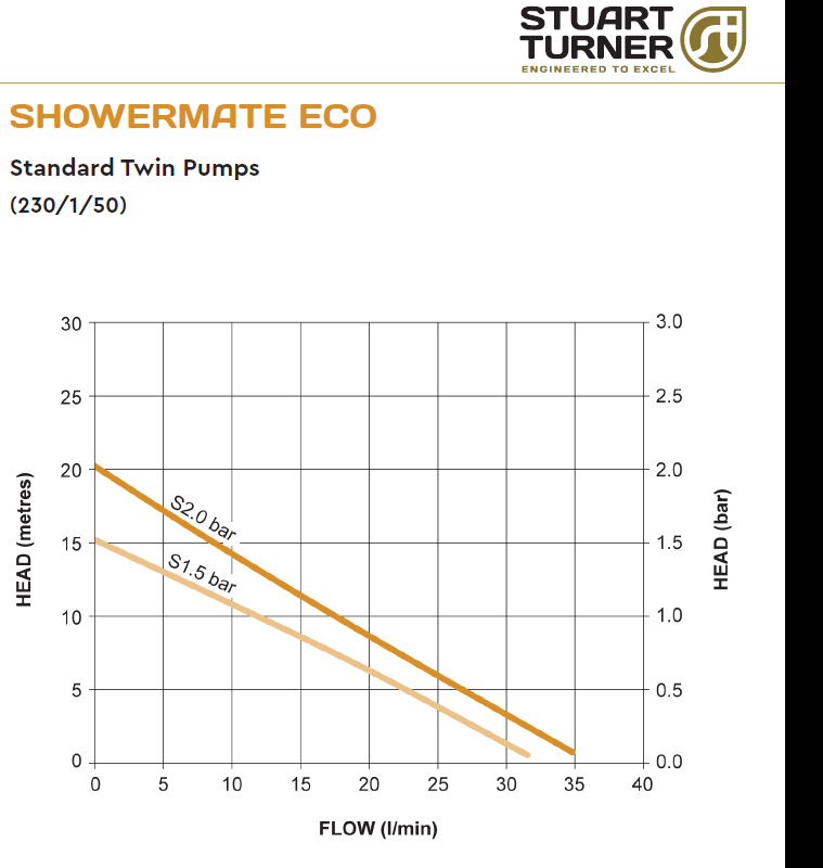

Just a few pointers to anyone a bit uncertain as to what head pump to purchase, it obviously depends on the flowrates you require with a dedicated shower pump which will normally be located close to the shower, the showerhead will also have a big bearing on the head required.
If you require a flowrate of say 20LPM at 40C then you might think that 10LPM is required from both hot and cold but since the hot water is normally heated to 60C then you need 12LPM hotflow mixed with 8LPM coldflow at say 10C, this means the pump must have a sufficient head to overcome the various losses, piping, thermostatic mixing vale and showerhead, you can see from below that a 2 bar pump will deliver this (12LPM hot) at ~ 1.35M head and a 1.5bar pump will deliver it at 1.0bar or to put it another way if the shower resistance is such that 1.5bar is required to deliver a total flowrate of 20LPM then the 2bar pump will provide this, the 1.5bar pump will deliver 17.3LPM, but still good, a 3 bar pump would provide 24.5LPM through the same shower.
The other probably more important issue is that as the HW temperature falls the more flow the pump hot end must provide so at a required showering temperature of 40C then the hot end must pump all the required flowrate when/if the HW temperature falls to 40C.

Many thanks for the detailed info, very useful and yes, it's the new main shower head that made me think I should've gone 2.0 bar.
