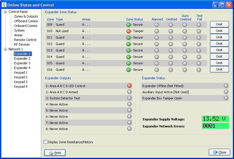

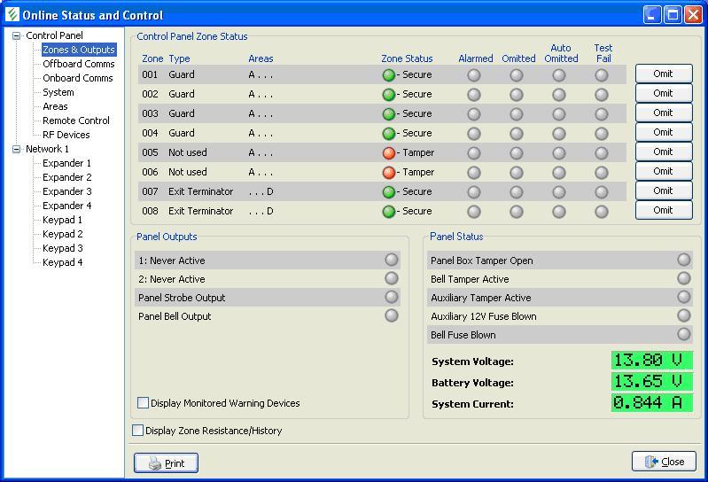

Hi as some of you may know I have recently installed a Texecom premier 48 alarm. Last night for the first time I powered the panel up and of course I now have questions. If I program a zone as not used do I still need to link out the tamper. What does the red dot mean on the expander information for Area A B C D LED Control.

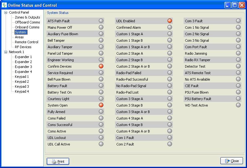

Is there any issue with the red dots I have on the system picture. I have since confirmed the devices but forgot to take an updated screen grab.
