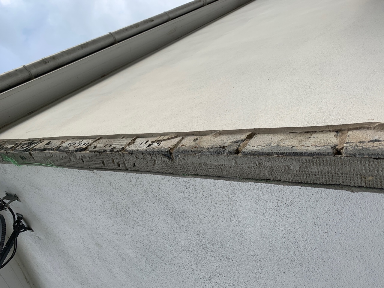

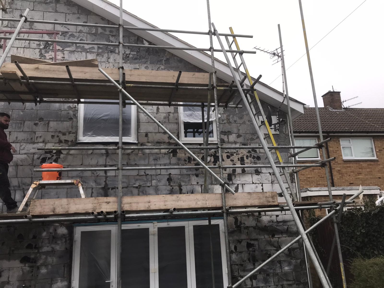

If you don't mind I have another question....
I'm now trying to get a renderer to quote for the works (completely replacing the render on the side and front walls). Knowing that it is essential that the block manufacturer's guidelines are followed precisely, I'm trying to work out exactly which blocks were used. The renderers who re-did the back wall render said they were "aircrete thermal blocks". But in the attached pictures ("rear elevation..." is a shot of the back wall during the replacement of the render and "rear corner" is during replacement of some rusty beading later on) I can't see any "scratch marks" on the blocks.
On the Forterra website (who I understand make Thermalite aircrete blocks) there are scratch marks in all their blocks - see here: https://www.forterra.co.uk/wp-content/uploads/2021/10/Thermalite-brochure-web.pdf)
The house was built in 2014, so perhaps the blocks didn't have scratch marks back then? (seems unlikely but I don't know).
Otherwise are they perhaps Celcon blocks? Or something else? How do I find out?
Thank you....
Simon

Thermalite have scratch marks and Celcon have a coloured band on the ends. There are others too such as Durox and Y-tong.
