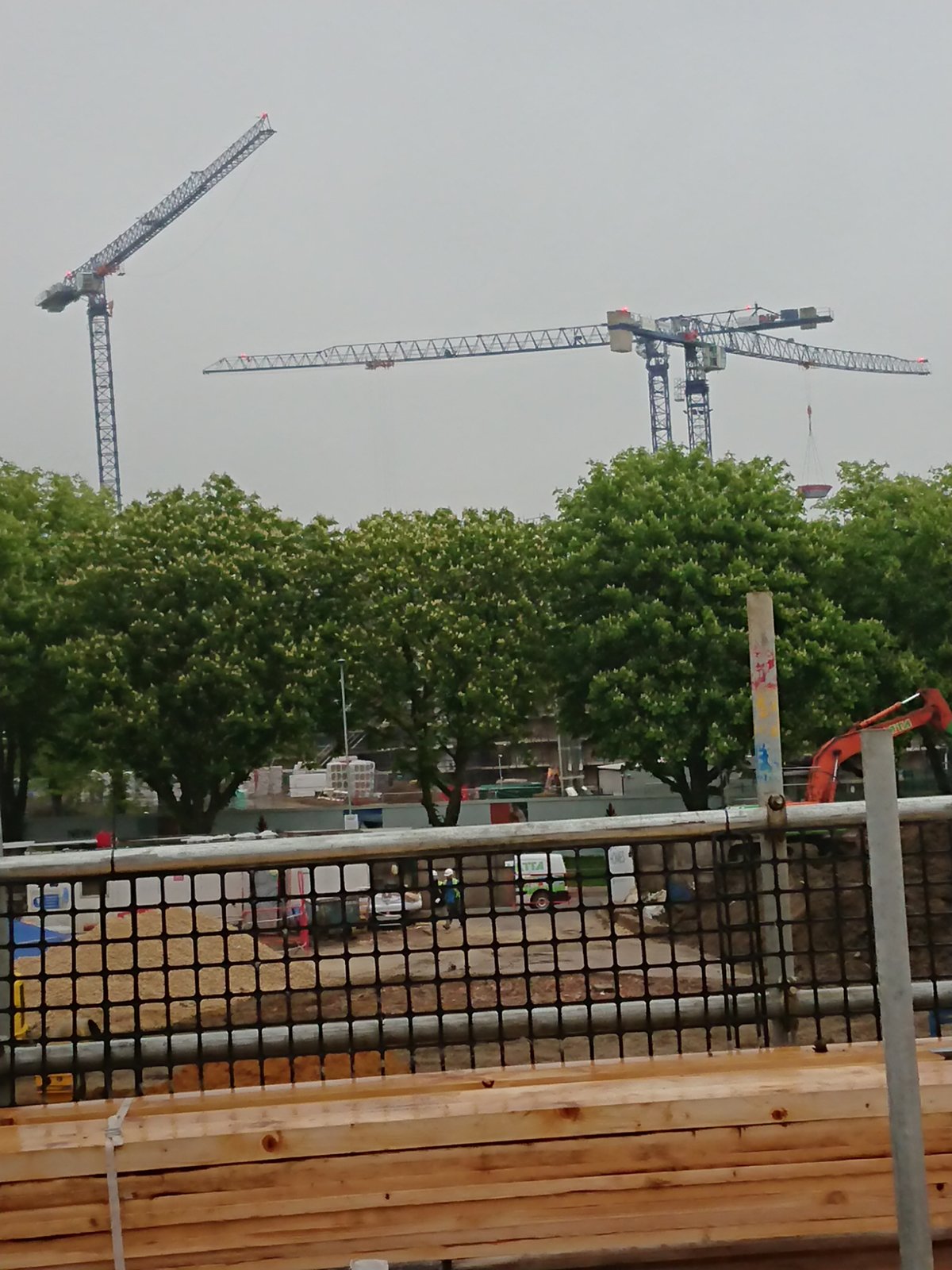

3 cranes where i was working today all within each others radius nightmare for the banksman i hate the things
glad i only bank mobile cranes
