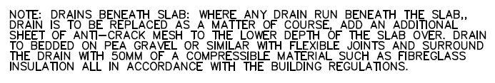

My question is such, what do i need to do above and below this exposed pipe to make sure it doesnt move or crack when the garage base is cast and the garage put up?
I'll get a picture as it'll make more sense! In short, the pipe is laying on the dirt at the right level, but the trench has obviously undermined its foundation, and im not sure what to do on top!
When your building your underbuild, slip in a concrete lintel to bridge the drain pipe and pack the area around the pipe with small stones for movement...pinenot :)

So a lintel over the top of both areas of the pipe is enough? Layed up on top of the hardcore base i presume?
I detailed this on a project for someone a while back, I'll dig it out tonight if no one else butts in.
the only issue is that i dont intend on casting a footing, i had intended to hardcore the trench (the ground has soft spots so want to ensure it doesnt move) and build up the middle with hard core leaving the same 'shape' as it is now, albeit 6" higher. That'll give me a 12" border of concrete base around the edges and be 6" in the middle.
So. My current thinking is to hardcore underneath the exposed areas of pipe, wrap it in 50mm thick lagging and build a hoop type frame from re-enforcing steel to go all round the pipe. Top it with DPM and fill upto and above with hardcore/sand then cast the base as normal.

The clay appears to drop at the bend - it should continuosly fall.
You must positively determine where your drainage, of any kind, runs and makes connections.
Any re-bar driven into the ground will rust out, possibly swelling and cracking its surround.
You might re-jig your guttering falls, and RWP's location(s) to eliminate the present RWP, and the clay drainage entirely.
Its a bad groundwork design anyway.
I would suggest coming back on here before filling the pit, and pouring a slab etc.
Do you have any kind of plan/drawing, and have you considered BCO?
Why not simply move it so it runs under the path and avoids the garage area?
