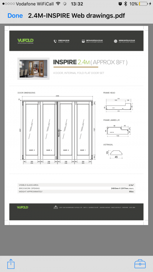

We created a opening for binfold doors . (The bottom of the steel is 2025)
However the door manufacturer of the binfold door we want requires 2017
That gives us very little to play with even with the thinnest plaster board . What are options. Can we mount a door frame on the steel?

Are you sure the door needs exactly that dimension, rather than at least that? You could lift the beam and fit the door to a plasterboard stud underneath.
From the manual door requires frame is 2007. So 2015 is not much given I need to consider wooden floor.

Just fix up to the steel then plasterboard the inside. you don't want your plasterboard going through to the outside face anyway.
Unless you have a flush sill on the doors you will have plenty of depth within the bottom frame anyway. Even if you have a flush sill you still have 18mm which will be fine for most flooring.

The frame is 2007 in heigh and I have 2025 from underside of steel.
A plaster board 12.5 would give 2012.5 from underside
Given frame is 2007 high that 5.5 mm for floor!

The frame requires 2007 from finished floor level.
I wanted to know if there is any way around getting it fitted
Right so I take it you will have a flush floor finish through the doors. the bottom track of the bifold must have some depth to it though.
But yes you really do need to protect the full width of the steel if its wholly internal.
Have you got a link to the door set you are using.
Attached is dimensions of door.
I am fine with width . Currently from underside of steel is 2026-2028(variation ) from floor boards. We are planning on having laminate floor in future.
I also noticed the 15mm on manual which is probably required for fixing. But we could probably get away with 12.5 with that

Right I see they are trackless at the bottom.
I have just read the manual you need 2007mm from the head to the top of the finished floor you currently have 2026mm to your current finished floor so allowing for 12.5mm of plasterboard under your steel you will have 2013.5mm which leaves you 6.5mm spare. which means you won't be able to fit any flooring over your existing boards. but it will fit fine with your existing floor.
If you fit laminate in future then yes you could fix direct to your steel but not sure how that would work if you did that now, I suppose you could pack up the bottom pivots for now but that will leave you with a big gap under the doors , something in the region of 19mm plus the margin already allowed for along with 19mm under the legs of the frame. You really need to be thinking about fitting your final floor covering first.
