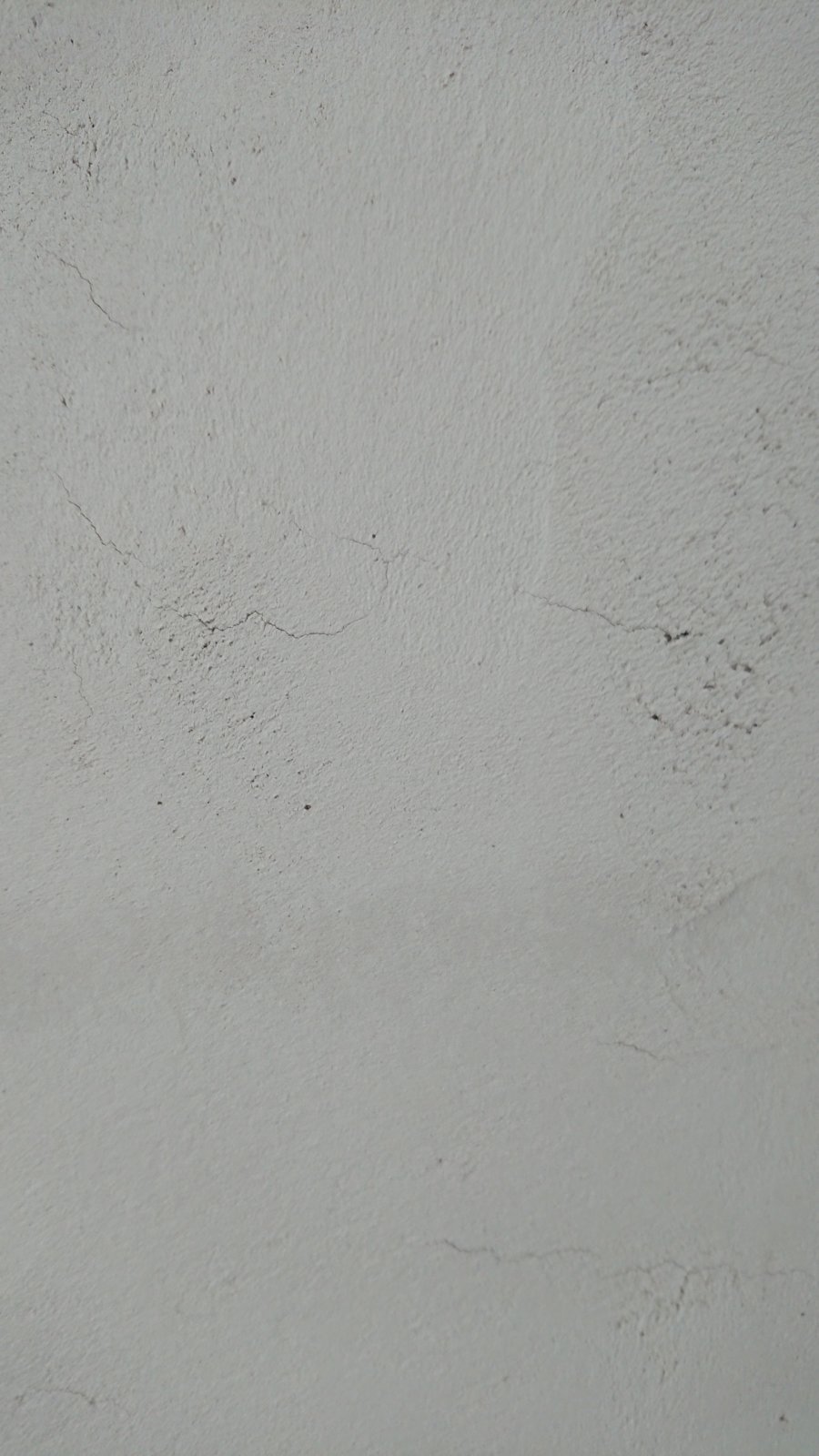

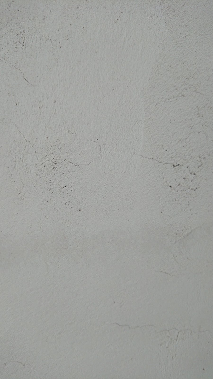

I did it yesterday. I wetted the turbos down with a water spray. The first side I did is fine. The second side I mixed up a bit wetter. It has cracks. It seems to be well stuck to the wall. It's also gone white already (less than 24 hours).
Is it worth me misting it or anything like that?
Turbos, :D like that word. (y) Just leave as is and your plasterer will prep and skim.
Thanks. I was concerned that drying too fast and cracking might mean it would fall off. So far it's OK
