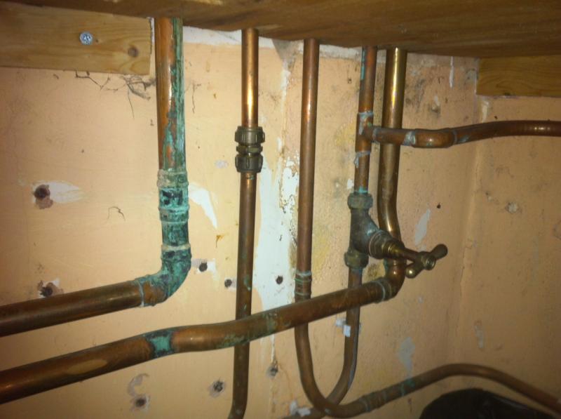

Just so I make sure i am turning the correct thing this is my set up. The first pic are the pipes leading up into the boiler. The valve in that picture on pipe 4 I cant turn as it seems literally welded in position and I have never moved it.

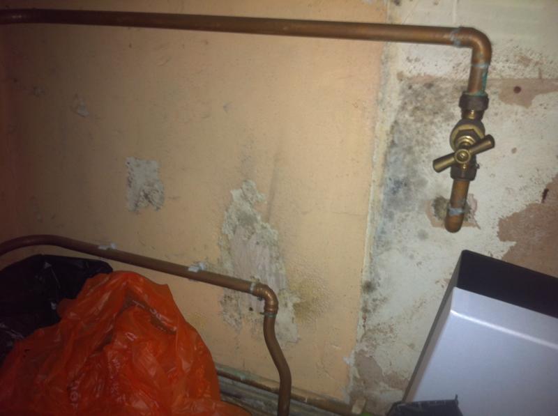

This same pipe connection, pipe 4 for the cold water then goes off to the right and is in the second pic. It seems to be going outside!? This is the valve I was turning and the one I have been calling the cold water inlet pipe as it was pipe 4 on the manual. Is this the valve i am meant to be turning or the one welded in position?
Anyhow when i close it I still get water from the hot tap so it doesnt seem to do much! No hope in me turning the other valve too!

The pipe in pick one leads to under the boiler st the top of that pipe as it connects to the boiler is a valve turn it off there. If water still comes out of the hot then it is crossing water.
