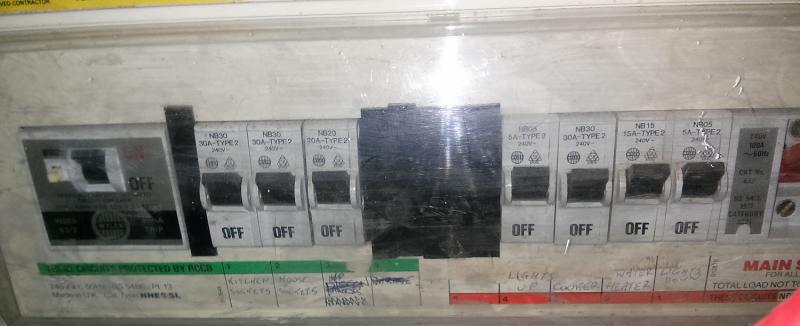

Currently my house doesn't have a bathroom upstairs. Instead there is a sort of en-suite toilet (with a Saniflo unit to deal with the waste) off the master bedroom. The Saniflo is connected via a switched FCU, the feed for this is from the ring that runs the house sockets. This ring is on the RCCB protected side of the consumer unit (see photo).
The ceiling light in the en-suite toilet is part of the upstairs lighting circuit and is switched via a wallplate outside the room, this circuit is on the unprotected side of the consumer unit.

Does the RCCB at the consumer unit satisfy this requirement for the Saniflo?
If it is a 30 mA yes but there are also 100 mA versions which would likely not comply.

It is a 30mA RCCB so it looks like I should be okay on that front.
