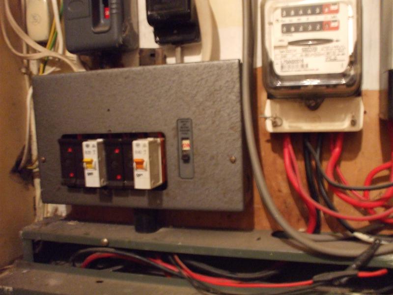

Following on from my last post regarding my meter cupboard :
//www.diynot.com/forums/viewtopic.php?t=184340
The electric company came and removed my economy 7 meter installed a new meter and installed an isolator. I asked him about the main earth and he was as puzzled as me. He told me to ring my supplier (EDF) and ask about the earthing arrangements. I did this and they said they will charge £226 to fit a main earth.
Surely this can't be right as I would have thought it it their responsibility to supply this to the flat. Am I wrong in this assumption?
Peter.
IIRC they are not obliged to supply an earth but if they have supplied one it is thier responsibility to maintain it.
What are your current earthing arrangements?
I don't really know what and if there is an earthing arrangement. It is a purpose built flat and all the main fuses are in a locked cupboard in the lobby. Coming into the flat is a red and black cable which go into the meter then an isolator then the fusebox. This photo shows the arrangement best (pre new meter).
The fusebox is metal and this is linked to the metal casing at the bottom of the picture by a piece of metal conduit. There is definately no other cables coming through the floor.
You need to follow the main phase / neutral cables back.
They could be 2 core armour from the lobby main head, with the armour carrying the earth to metal work on your picture.
You could seek access to the lobby main incoming supply and I bet there's a MEB there.
If all else fails commission a electrician to run a 10mm earth from the lobby.

ColJack :
Close Up for you :
GALLERY]
not just for me.. we all like pictures... ;)
what's under that? armoured gland? conduit? just a brass bush and locknut?
if it's an armoured gland then that's your earth.., possibly also if it's conduit / trunking in a single run from the main fuses..
stick a meter between there and the live and then the neutral..
if you get 240ish between it and live, and only a few volts between there and neutral then it's connected to earth..
