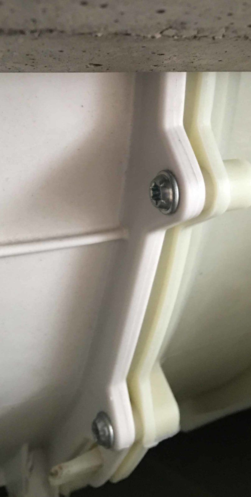

Hi,
I am looking to purchase 2 bearings & seal for my Hotpoint Aquaris washing machine.
The model is WMF760
I have supplied 3 photos as ive been told this machine is could be sealed but as you can see it has a ring of bolts around the drum.
I have then been told that these have 30mm or 35mm bearings & cant supply until i take it apart.
Anybody able to advise please.

As you can get your bearings within 24 hrs, Id concentrate on the dismantling of the drum.....not all bearings come out cleanly, sometimes causing damage to the housing and / or the spindle. If all goes well you can then measure up and order.
John :)
In an ideal situation that is ok but i have only 3 days to do this and delivery isnt 100% next day etc
Whenever I used to replace my bearings years ago, I used to buy the complete spider kit as half the time you’d need the spider too. Try a local spares shop if you have one near you.
