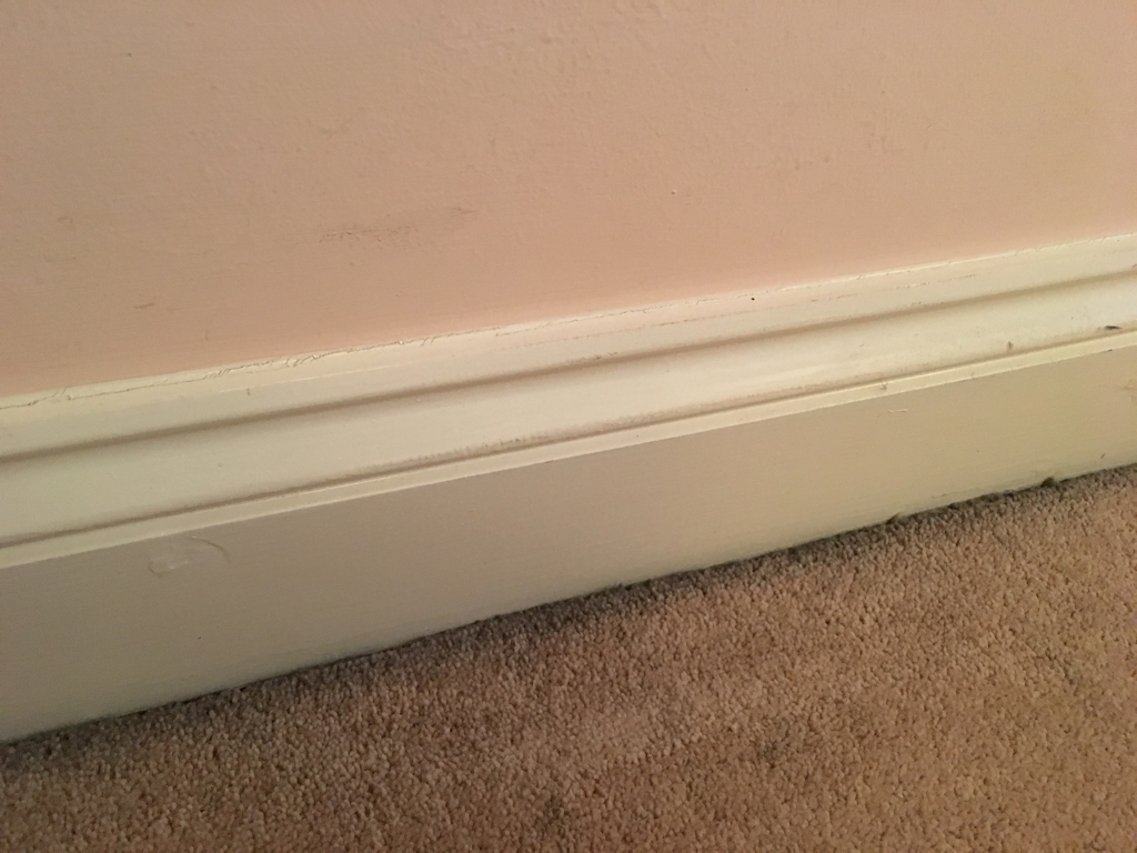

  • Black marking on carpet edges, presumably where air flows around carpet edges to skirting boards

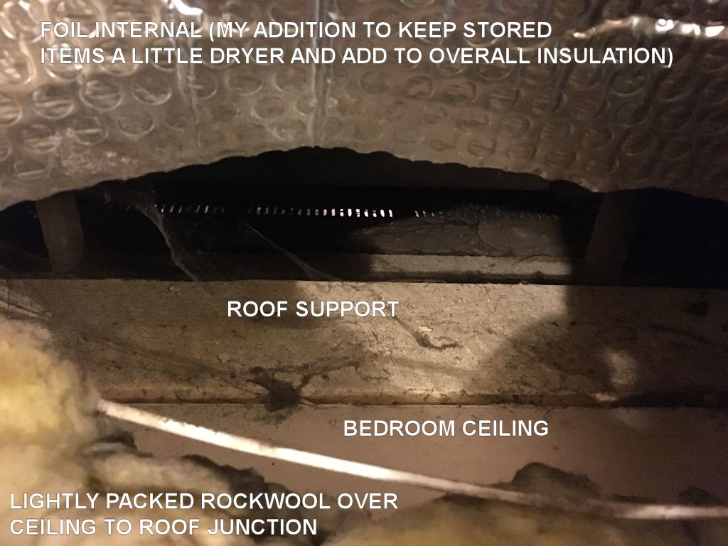

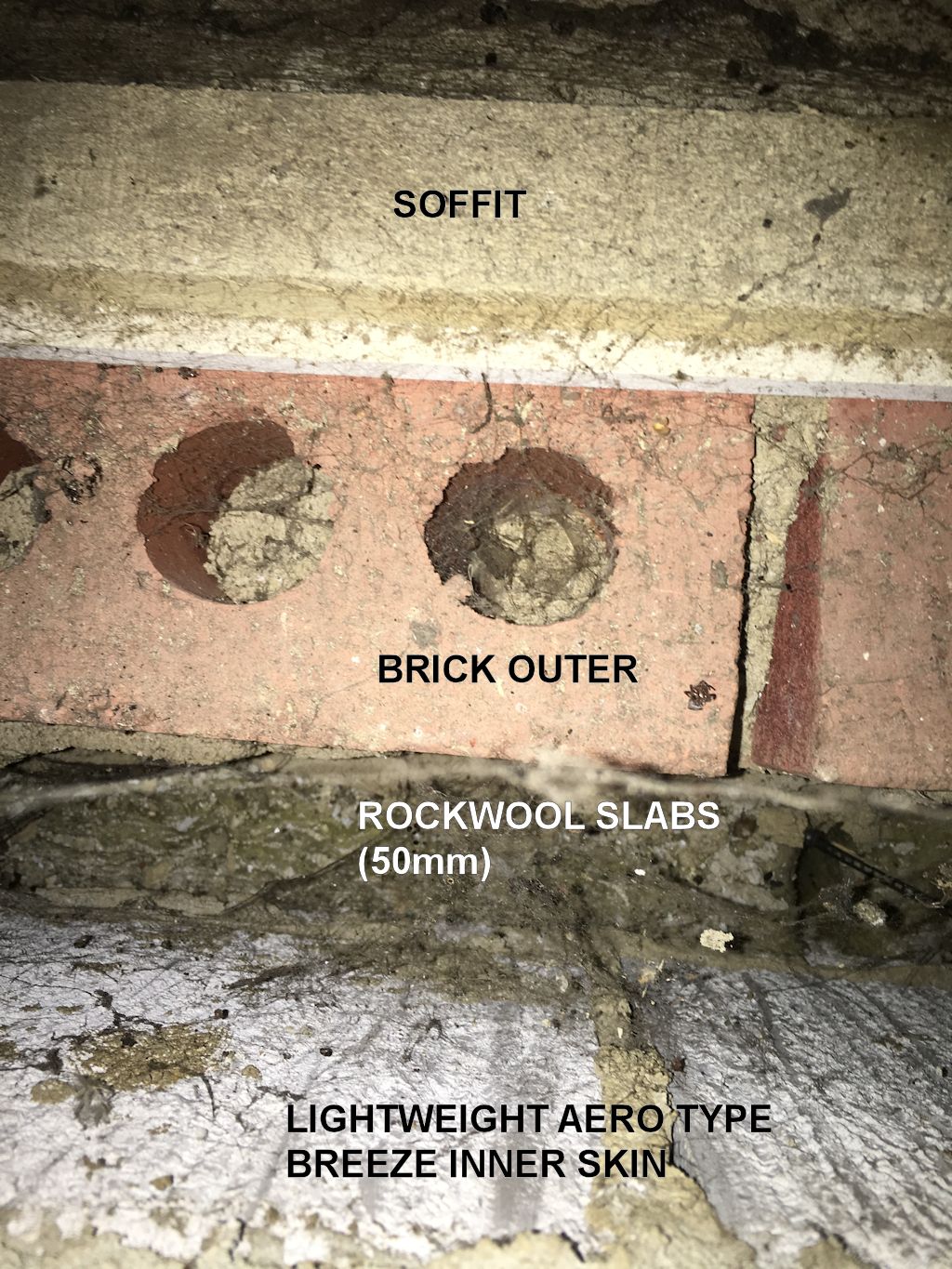

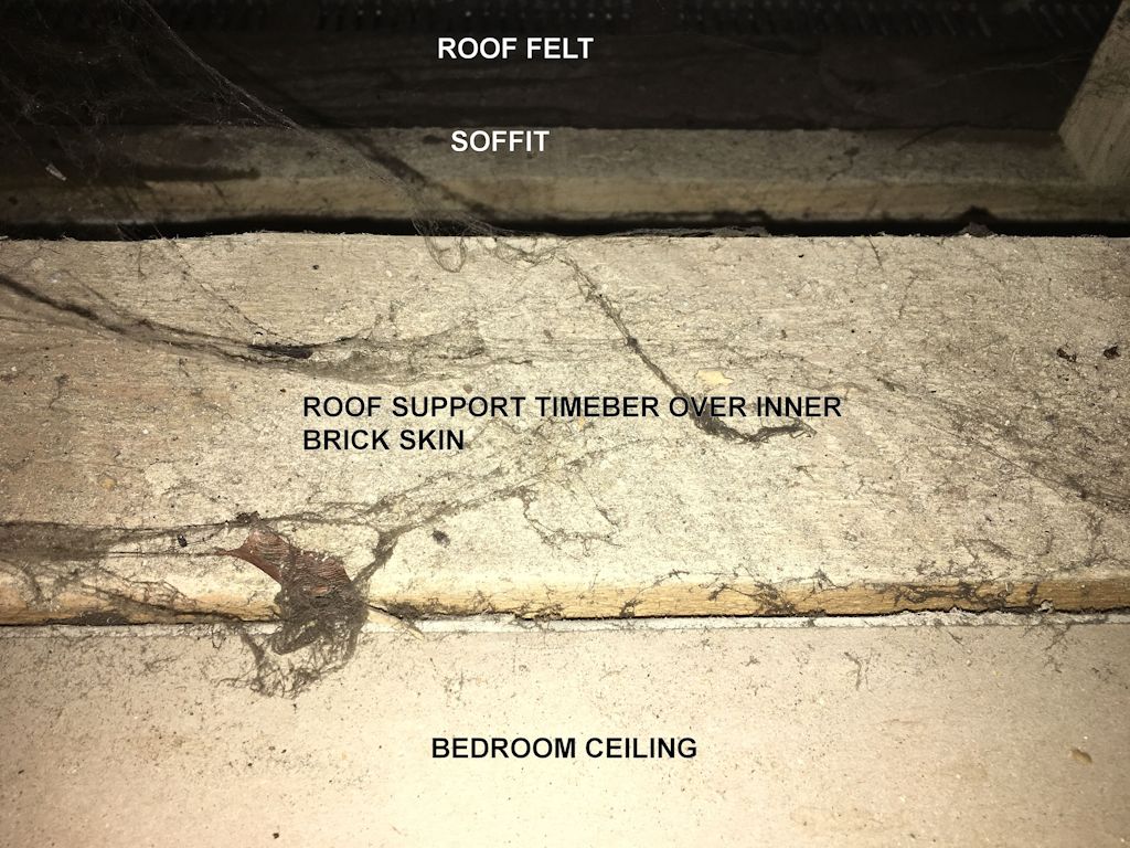

Not the most riviting pictures but they show the cavity wall make up & junction to the roof plate.
I have read that cavity closures to the top of the walls are now fitted primarily to stop fire progression but also help keep the cavity warmer but at the time of construction they would be open like now. I'm planning to make a test hole or two around a window later but guessing there is no closure around. If that is the case, not the best option but not too destructive, could I drill small holes around the inside perimiter of the window opening and seal with foam? It would seal the plasterboard cavity making the plasterboard around the inside of the frame the closure
I know, after some prodding, that the plasterboard void to the roof support timber is open. Cos the insulation is old now and cos it is not fitted that well against the edge the top of the plasterboard is basically open to the outside. The insulation is old now and cos it is not fitted that well against the edge the top of the plaster board is basically open to the outside. Doggits suggestion of using PU foam from inside would seal that gap before the roof support joist.
Note the addition of the bubble foil has been added by me previously, just to keep the worst of the damp and temperature extremes from the typical junk stored in a loft. What I did not understand at the time is that it would be better pushed down past the roof support joist.

What kind of insulation is in the cavity? Partial fill PIR board, or full-fill rockwool? If the former then I'd be more motivated to find and tackle thermal bypass issues in the cavity than the latter. Then you can concentrate on the bypass associated with the poorly fitted dot-and-dab.
Good idea, make sure you use a foam gun rather than the hand held ones, as they are basically uncontrollable. At present your heated air gets behind the plasterboard and straight into the loft.

Yep the wall cavity contains wool slabs.

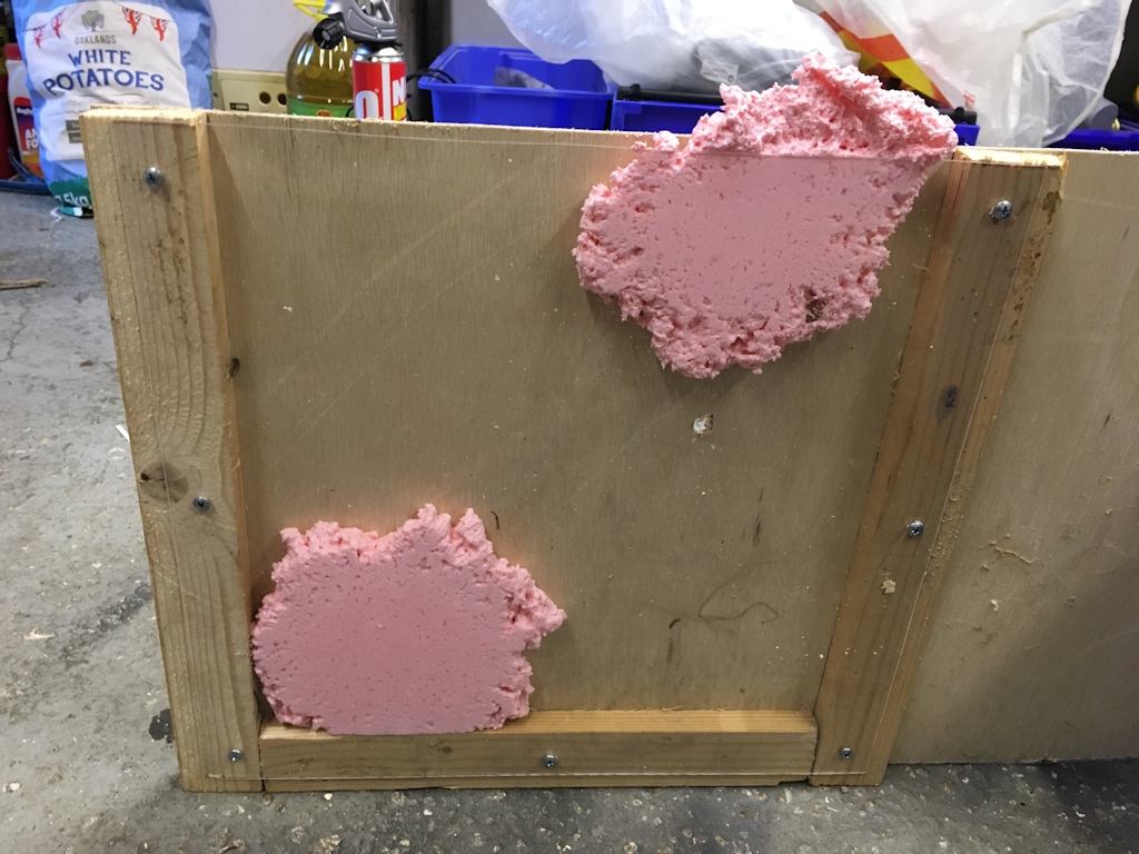

So the while the cat is away the mice play (yep the better half is out)...

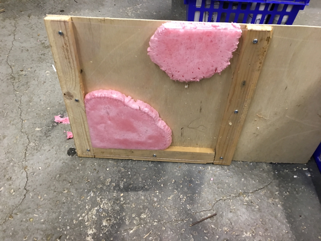

I thought I'd see what coverage you get with the foam. So I built a little test cavity with a 15mm void which is what the dot and dab works out at. The lower foam was injected from the rear via a 10mm hole with a 3 second burst and the upper 3 second squirt was from above the open cavity as it will be when I manage to tackle ceiling/loft junction. I used fire/accoustic rated foam with a gun. First time I have used one and so much better than the normal cans because of the better control. The final foam picture is after an hour.

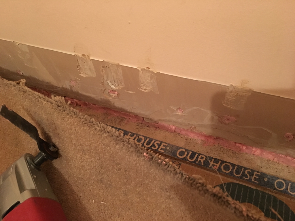

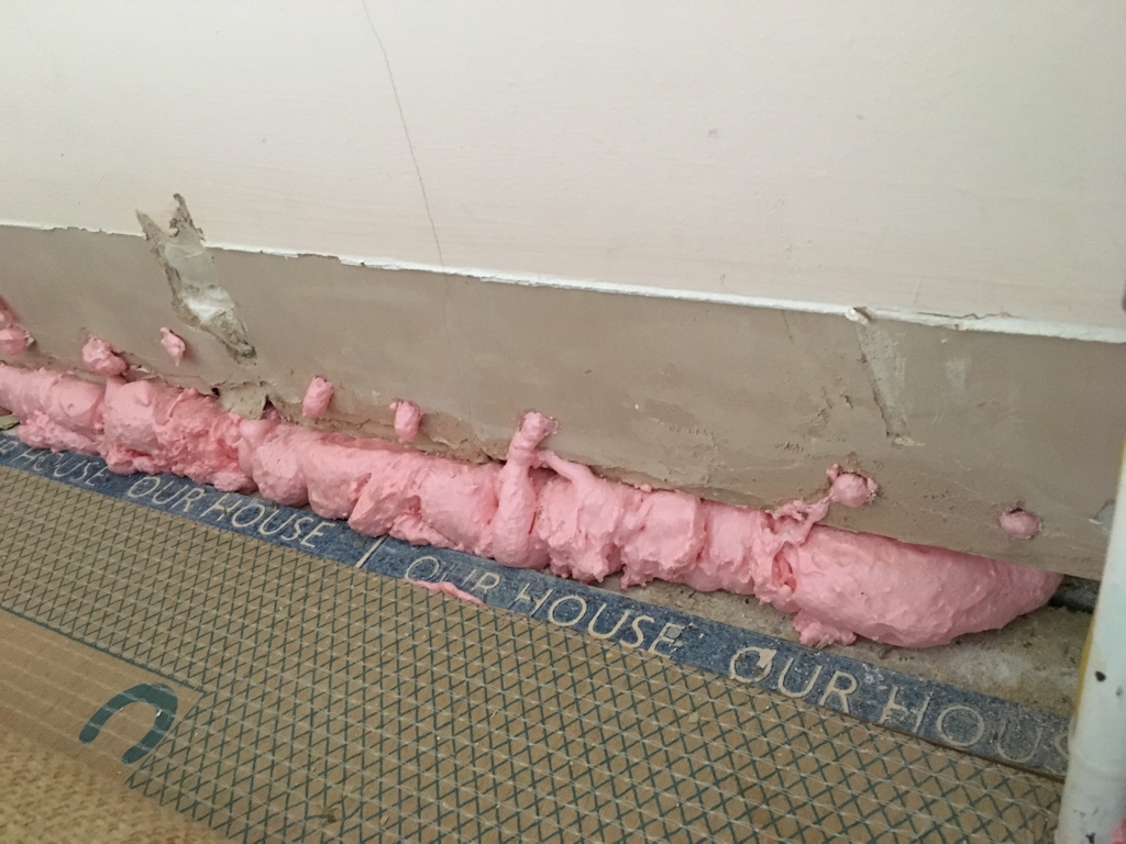

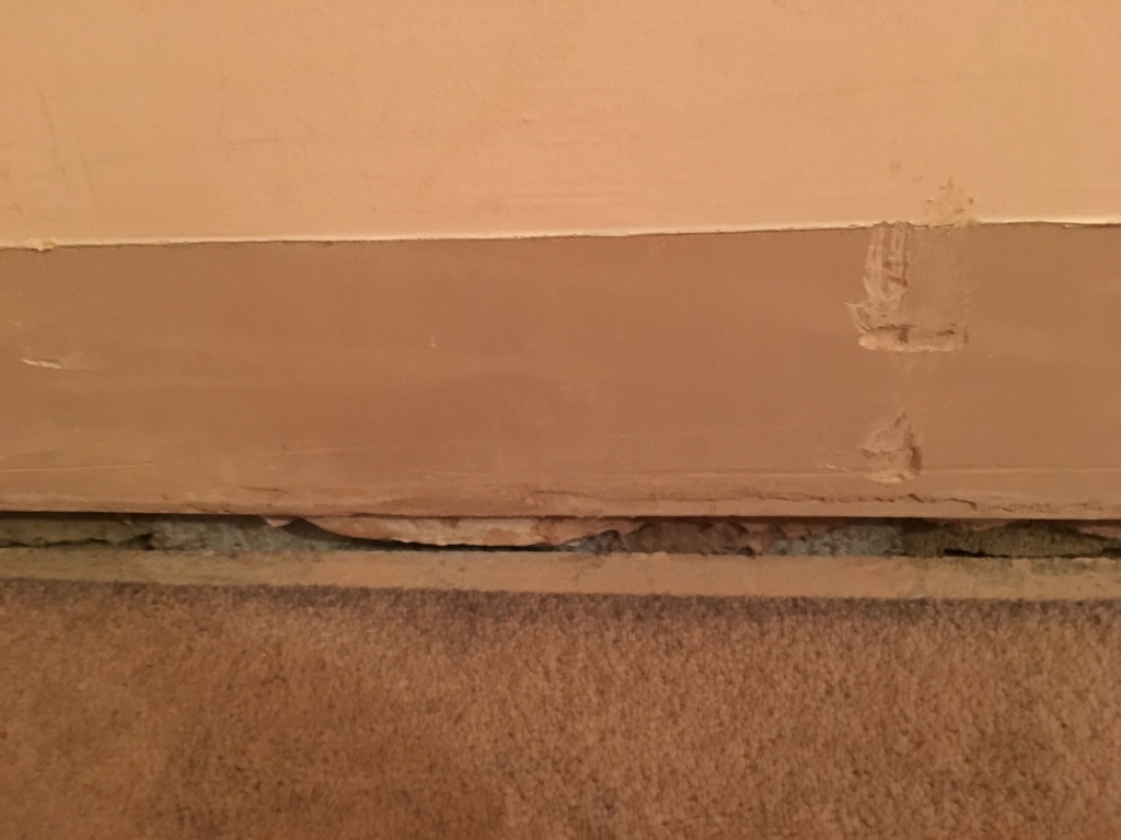

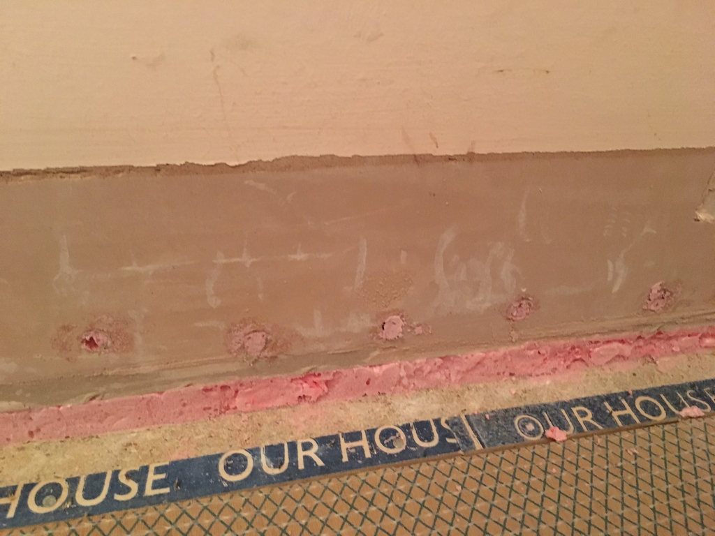

The dirty carpet edge is seen in the attached picture. This is an internal wall. Taking the skirting board off reveals the gap and provides a draft. Using foam I filled the gap between the floorboards and wall and also the plasterbaord and the wall. Initially I cut back the foam with a pad saw but this just seemed to hack it to pieces so in the end I used the buzz saw which did a much better job.
Hopefully I'll get to tackle the outside walls tomorrow and then I'll be able to judge if it has made any difference to the sound transmission from the lounge below.

Nice work!! I love it when people do actual testing on things like that(y)

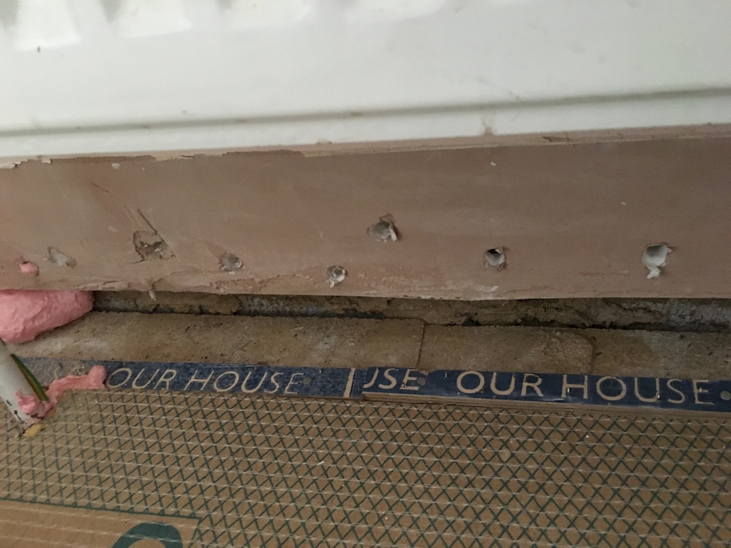

Tackled one of the outer walls today. Was going to seal the ceiling from the loft. I started but access was a real b**ch. Also makes me think that fitting cavity socks to the top of the wall cavity might also be a no go although because the sock is flexible and I would not need tooling i might still be able to fit them. What impact would these have?
As the coving is coming off in places I will probably take it all down and pilot drill and fill before the new stuff goes back up to seal the top of the wall. Is the lightweight coving any good?
At the base it seems to have much larger gaps with some good 1/2"+ gaps between the floorboards and the walls let alone the plasterboard starting 1.5" up the wall. expains the draft and noise transmission. Added to which the skirting boards were not mounted flush with the floor but had a 1/4" gap for some reason.
The skirting will have to be replaced but at least the room is getting sealed. The lounge underneath also needs redecorating so I might take the ceiling down and insulate from underneath as all the taping and artex is shot.
