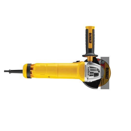

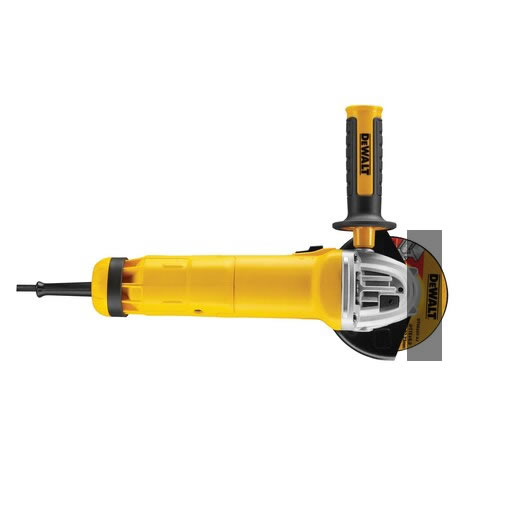

True but the OP says that it is 22mm thick, A 115mm diamond blade has a depth of cut of 30mm. The guard covers about 35% of the blade. The OP will be able to see very little of the line. With a 9 inch they will be able to see the whole line.

They were minor scuff marks. I guess I could have removed the guard but I didn't want to use the angle grinder without the guard. As I said earlier, a 115mm angle grinder has a cut depth of 30mm, when cutting something 22mm deep the guard is either going to obscure the cut line or drag over the surface. If you remove the guard and accidentally drop down by 8mm, which is easily done, then the spindle nut will hit the tiles

As I said earlier the Guard doesn’t obscure cut because you don’t look down the blade.

The grey area is the thickness of the tile, allowing for a little bit of the blade to go through the tile....
