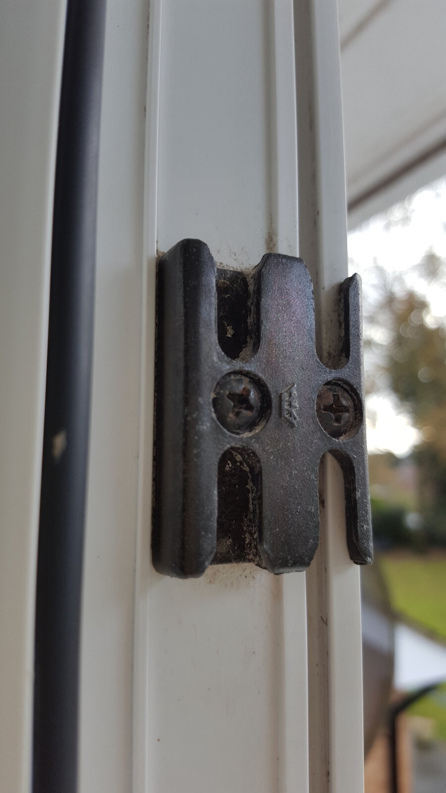

Just bought a new house that is double glazed.
I need to fix one of the widows. One of (only two) of the locking rollers in a bedroom window has sheared off and the top of the window will not close tightly.
The problem is, I can't idenify the manufacturer. I've taken it apart but there's no name on any of the parts.
There's a crown stamped on some of the parts (see photo), but it seems to be a very common logo.

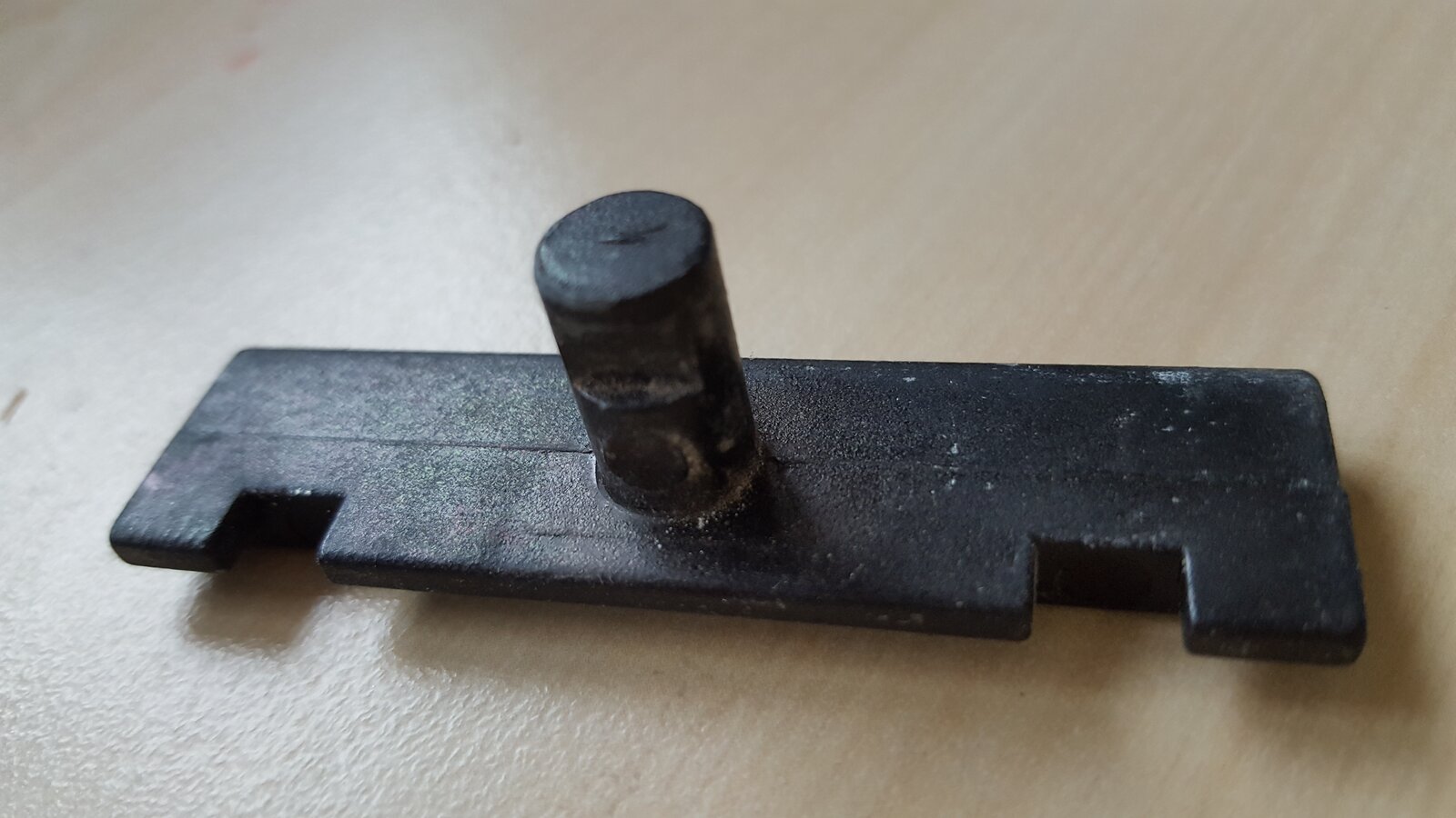

I've attached photos of the logo and one of the locking rollers that's not damaged.
Can anyone help me identify the manufactrer I need.

have you got a picture of the lock actually on the window?, and keeps on the frame ? I recognise the logo but for the life of me can't remember where I've seen it ! It may be a case of getting an alternative type of lock ( and keeps ) , as its very possible this isn't made anymore ( depends on age of window really )

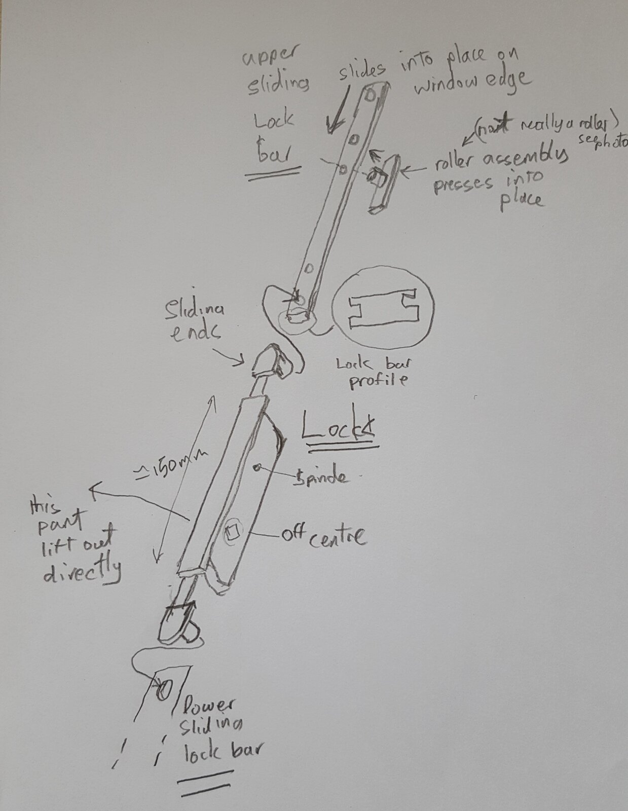

The keeps on the frame look pritty standard, but the lock rail bars on the openers are not flat bars screwed on as usual or part of the lock. After removing the plates (with the crown on) from the top and bottom of the opener and removing the lock it self, they slide out top and bottom. They can't be pulled straight off.
Bit of a comlicated design, but they look good quality.

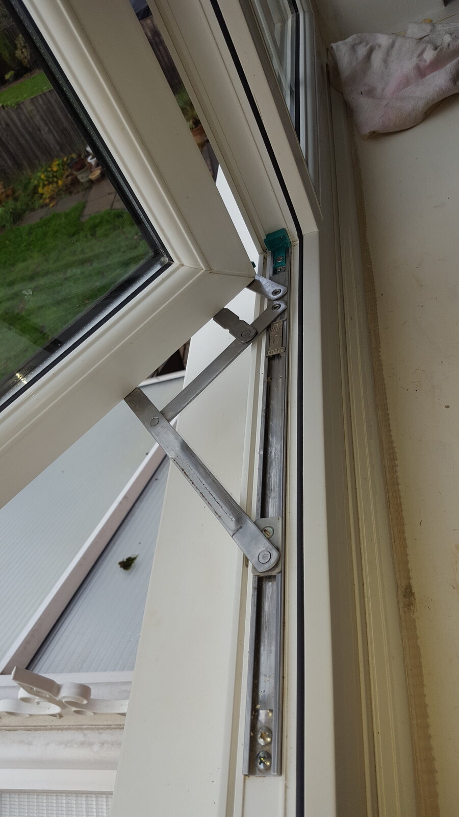

Hi ronniecabers,
I've added a few photos (see attached), bit difficult to photograph the lock since I'd have to dismantle the window again but I've added a dawing & decsription, if thats OK.
Thanks for your help.

Hi Kenn,
